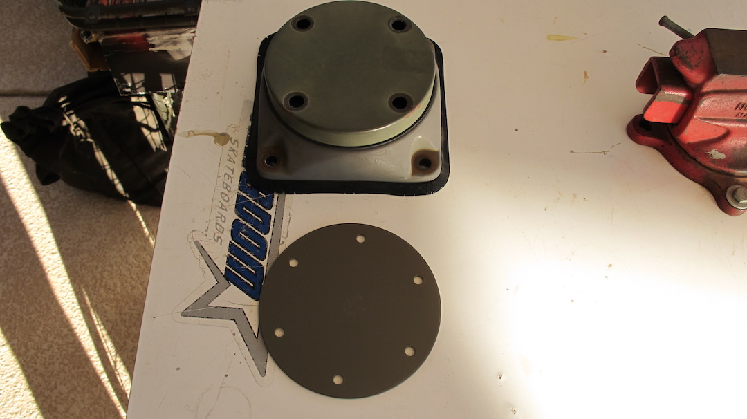

Here's a picture of my base with 4 hole cap, and the 6 hole plate that SAV sent me:

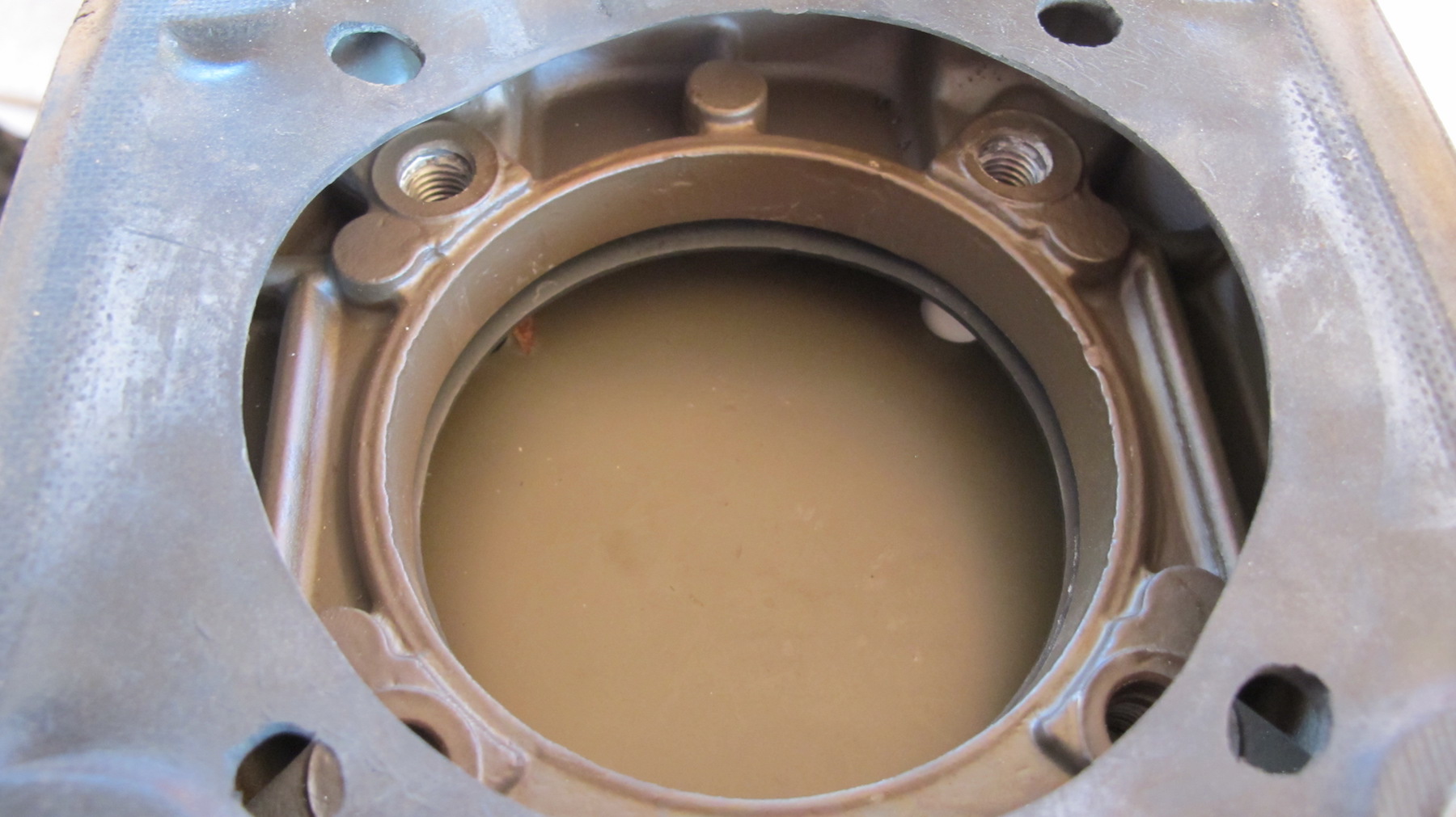

Here's a picture of the underside of my base, showing bosses for 6 holes:

The 4 holer is a standard Nato 4.5" BHC mount, the 6 hole is not, you got the wrong part.

I expect that since my base shows only bosses for the six smaller holes, those are not threaded. They would probably have to be drilled out and threaded to use. Not sure I want to deal with that. I just wanted the spare cap to use in the future if desired since I'll be drilling holes in mine! Has anyone had the cap off to see if the six bosses are threaded?

SAV just confirmed that they did send me the wrong cover. They do have correct used caps like mine and they are sending me one. They made a mistake and are responding to make it good really well.
The correct round cap is SAV part number 7131950581U group 31-35-03 in case anyone else needs one.
The flat plate they sent me goes on the non-Swiss side antenna mount.

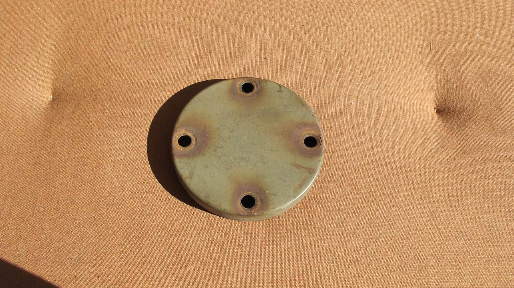

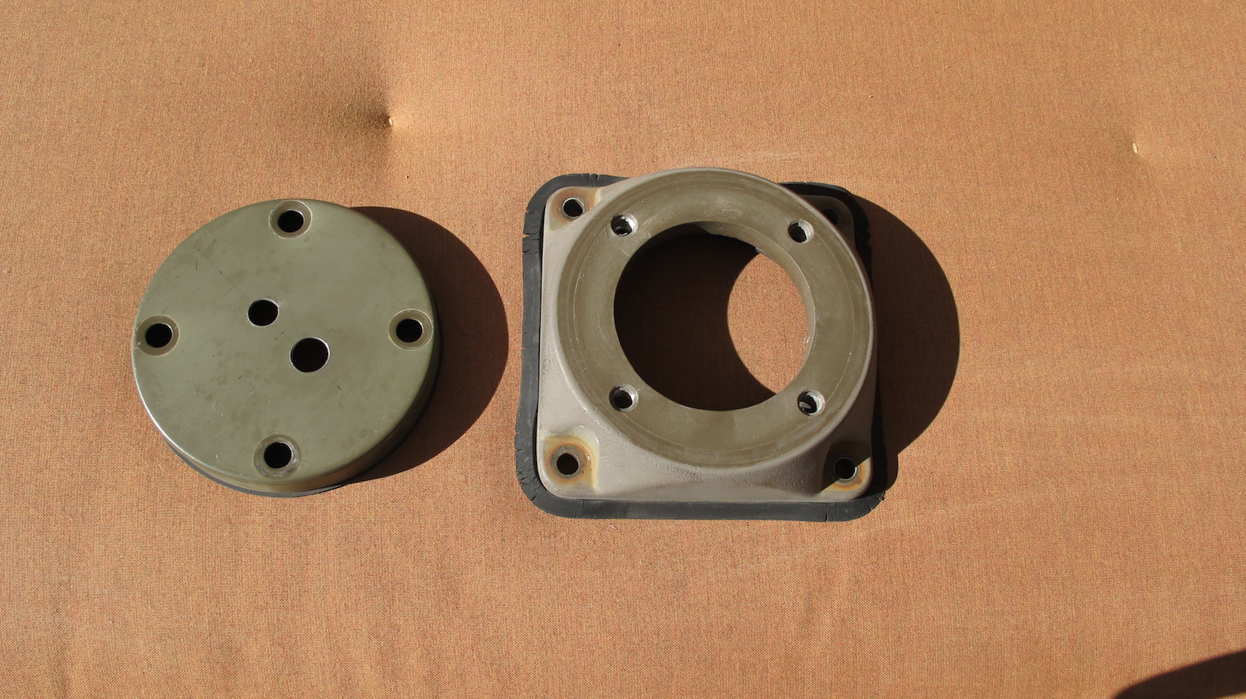

I received my correct replacement antenna cap today. So everyone will know, here are pictures of the top and underneath side. There's a curled lip on the bottom that meets with the round gasket. The side of the cap doesn't contact the base except through the bolts and the curled lip. So RF grounding should probably be done by cleaning off the bottom of the bolt heads, cleaning off the paint on the top underneath the bolt heads for the cap and the base, cleaning off the paint on the underside of the cap where the antenna studs mount, and using NO-OX-ID A on the bolt threads for the cap and the base.
Re: 710M Top Center Antenna Cap/Plate
I keep thinking I'm done with this. Previously tried to tap the cap off the base with no success. But today after drilling my antenna mount holes and cleaning burrs and paint, the cap came right off! It just sits on the gasket and is bolted to the base. The base 6 hole bosses visible underneath are NOT tapped for the 6 screws. I've drilled the holes for the CB and Ham antenna mounts. A step drill worked fine. The cap seems to be aluminum. Here are a couple of pictures:
