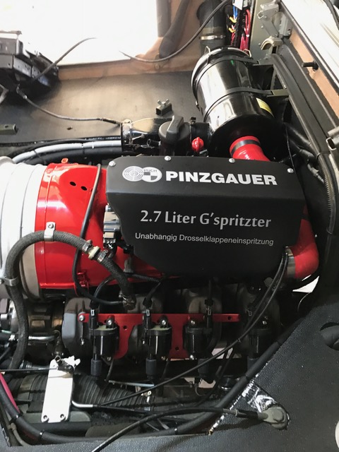

I've finished designing and building an independent throttle body injection and sequential ignition system. So far it's working great. I just have to finish tuning and get dyno results. More details to follow.

Beautiful. Are you going to be selling a kit?

Very nice! Curious how you adapted to the head intake ports, are you using the intake riser "pants"?
Hard to see in the PIX :? What injectors did you decide on? Are they EV6 or even later, what Lbs
and spray pattern, would be interesting too know.

That's under-doghouse porn at its best, thanks for sharing! The red covers are a nice touch.
Would be interested to know if you ever consider to come up with a kit, too.

WOW! I've had that idea in my head for years, but no real way to make it a reality... please consider selling a kit.

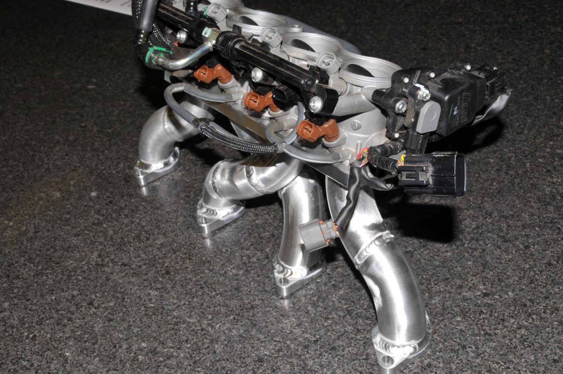

I designed and fabricated a custom intake manifold with cylinders 2 and 3 crossed over to match the runners lengths of 1 and 4.

Now that is beautiful work!

Eyeball engineering is qualitative, that said this manifold looks technically very good!
Balanced flow etc, separate throttle body/port . Looks like at least EV6 injectors -- good.
What flow rate did you settle on e.g. Lbs @ 3 Bar? Curious about the spray patter you
picked, e.g. "shot gun" 20 to 30 degrees or "laser beam" 10 degrees.

I am really envious of the skill and quality exhibited. I regret not taking the time to invest in developing my skills in this area more. Great work!
