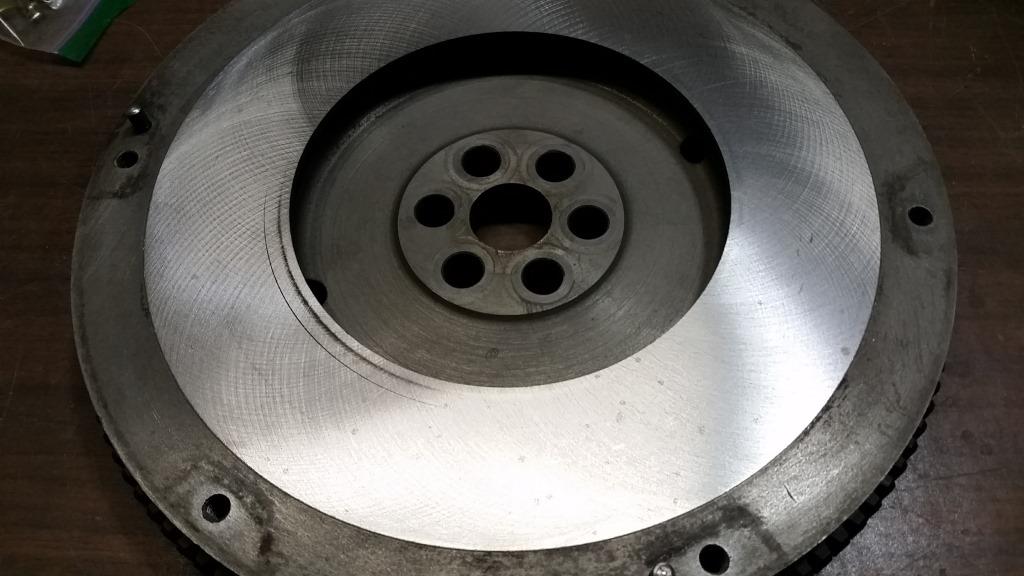

Had the flywheel machined- not lightened. I didn't want the machine shop to take much off at all, just a resurfacing. You can see the little bit of a mark remaining in the surface. It looks worse in the picture because you can't feel it at all, but it catches the light.

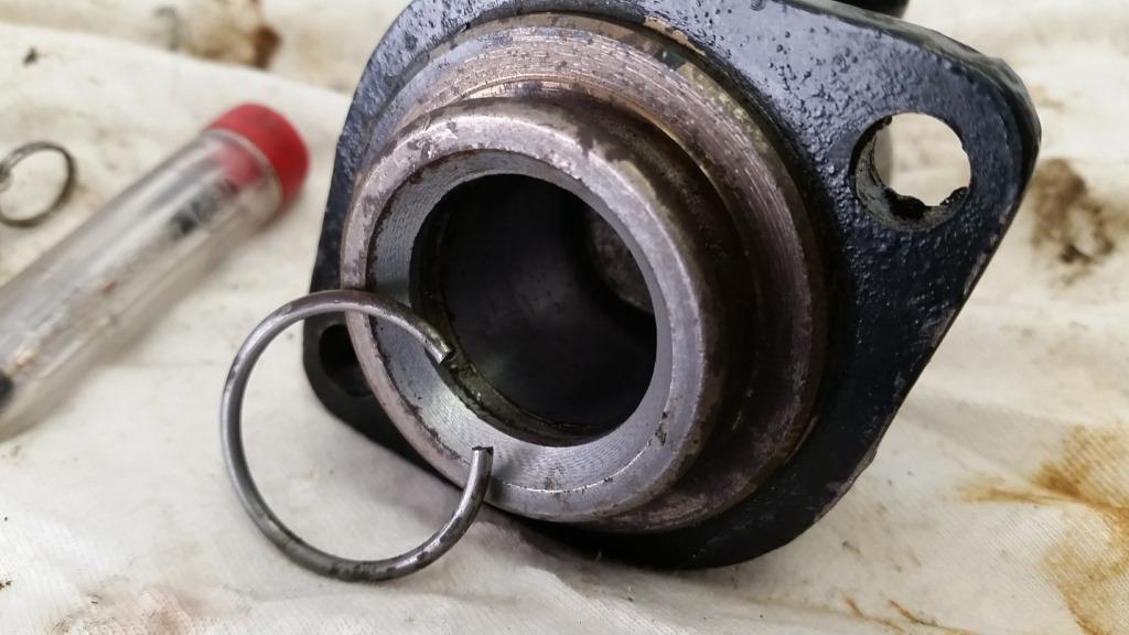

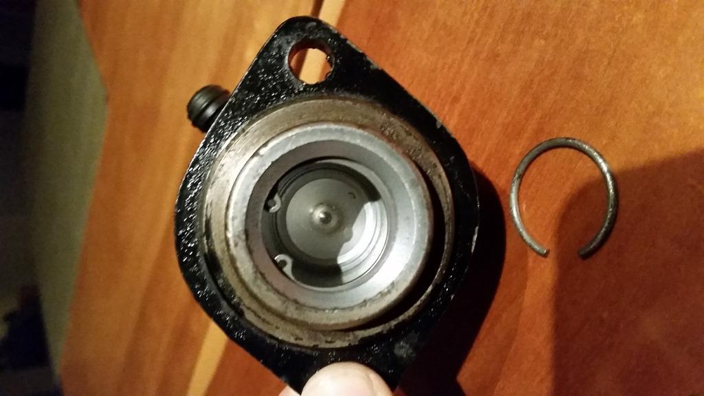

Rebuilt the leaky clutch slave cylinder. Removing the original snap ring without scoring the bore is a royal PITA. Ultimately, the only way to get it out was with two small screwdrivers working from the top edge and inching (millimetering?) it up the two screwdrivers and out. That sumbitch will be replaced with a standard snap-ring so the next guy has an easier job. I can't think of a reason that won't work. The rebuild kit is simple. I used a light amount of silicone grease in the bore since that worked so well with my locker slave last summer.

you should inspect the groove for the snap ring.
rectangular vs circle .... and use the appropriate shape of ring.

Oh Hotzenplotz... hmm, now you have me wondering. I really don't see a way for this ring to behave any differently than the original. I'll kick that can down the road for a week.

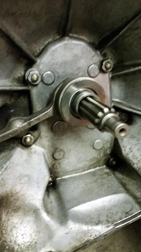

Next, I turned my attention to the gearbox. The clutch fork comes out easily once you know the trick- roll it off the pivot point instead of trying to pull it straight off. Don't smack it with a hammer! A firm, but smooth roll and it comes off. The small clips come off and that releases the TO bearing.

I cleaned up all the bearing surfaces for the clutch fork and throw-out bearing. I added some spray on graphite dry lube to the sliding surface of the bearing and gearbox shaft. Added a very small dab of silicone grease to the clutch fork pivot surfaces since they’re sealed up pretty well from contamination. Very smoooth operation now.

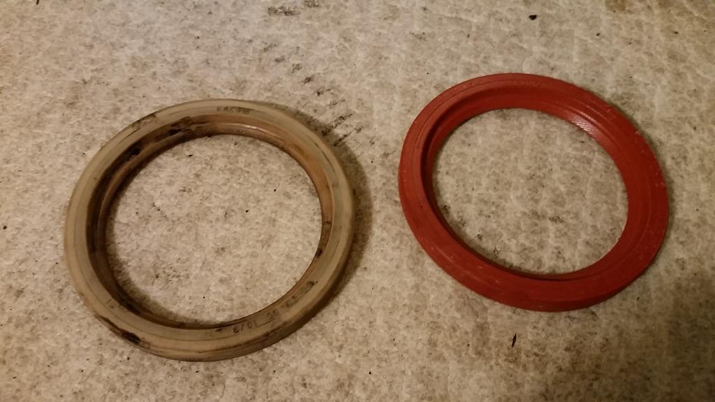

Next is pressing in the new main seal and new pilot bearing. Both went in well with silicone grease. Wiped off afterward so there won’t be any gunk build-up from the clutch dust.

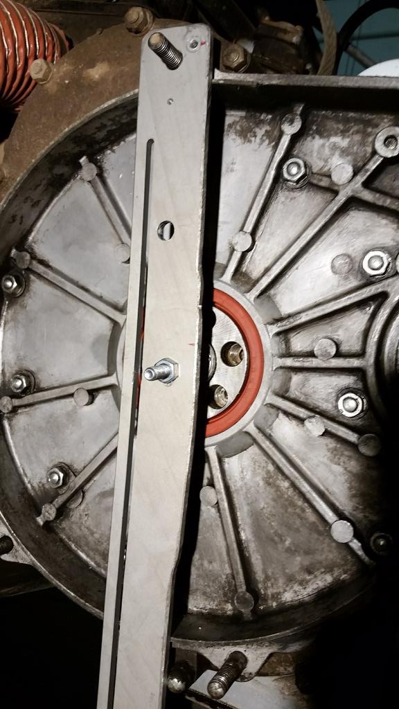

(edit) Block the flywheel with a super fancy aluminum bar tool bolted to the flywheel and 1 of the studs.

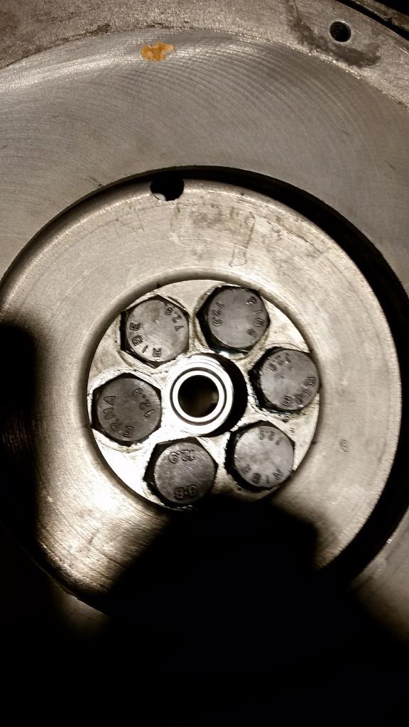

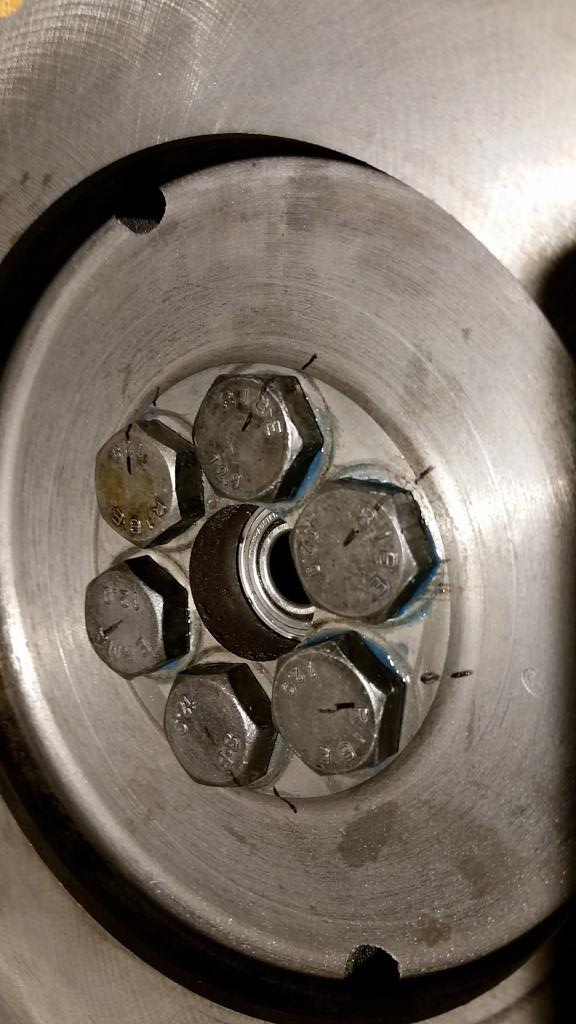

Now the task of bolting on the resurfaced flywheel… All I can say is WOW!. If you don’t have airtools, then buy the best socket wrench you can afford. After putting blue Loctite (medium strength) on the threads and under the head, the initial tightening with the Harbor Freight torque wrench was fine. You can see how I marked a corner on each bolt. The next 60 degree turn was a huge task. The cheap HF torque wrench with breaker bar was flexing too much to get the full turn. My shorter Proto was a lot stiffer and with the 30” breaker bar did the trick. Jim L says its 240 ft lbs. Those bolts have to be very near their elastic limits. The final few degrees of the turn go slowly and evenly- like the bolt is stretching. I’m still sore today.

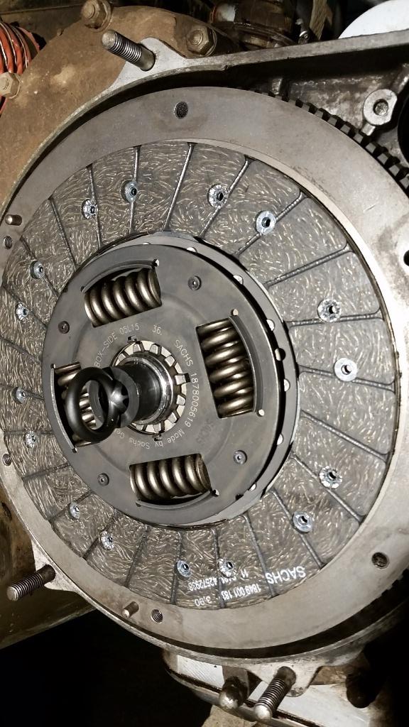

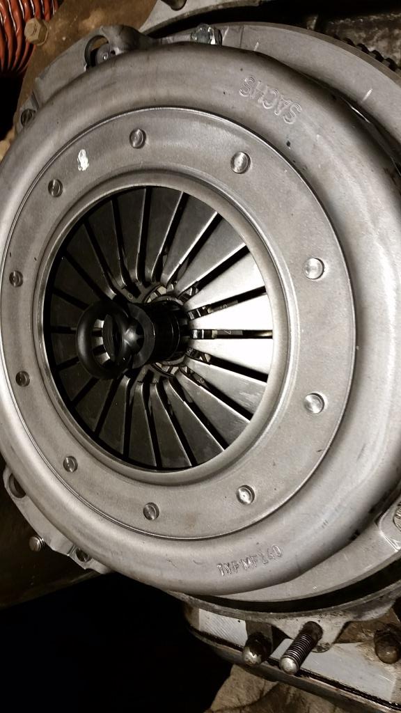

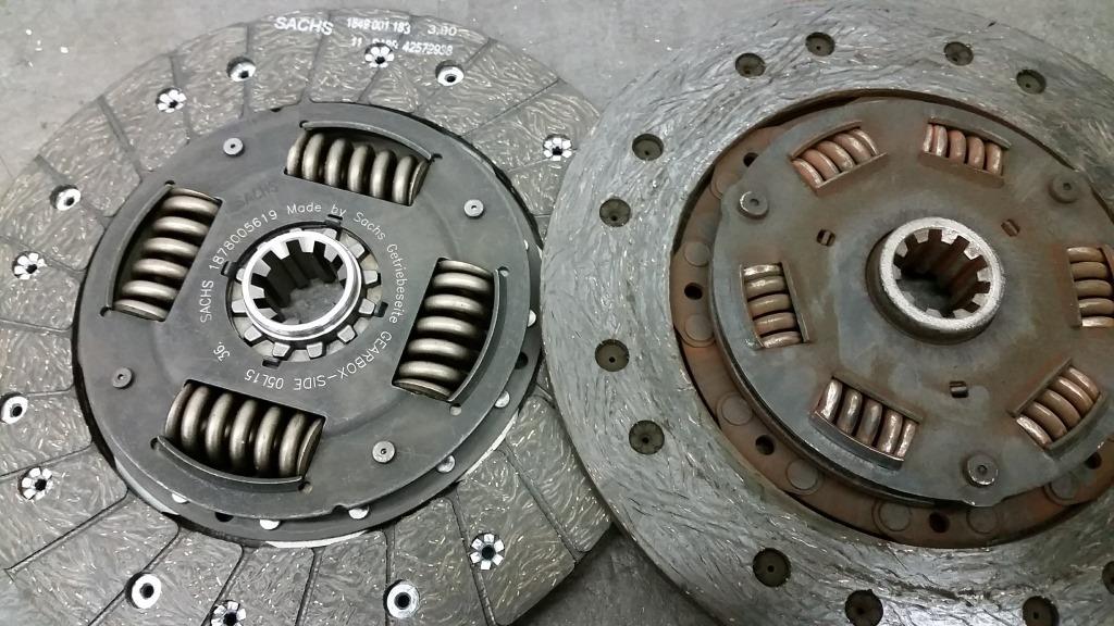

Next stop is the clutch and pressure plate. After reading up, there seem to be 2 useable clutch discs available. 4 springs or 6 smaller springs. The 4 spring 733i clutch is upgraded from the stock 6 spring or 533i clutch. Since I plan to upgrade the motor, I went with the HD clutch now. Hopefully the pedal feel won’t be harder than the original.

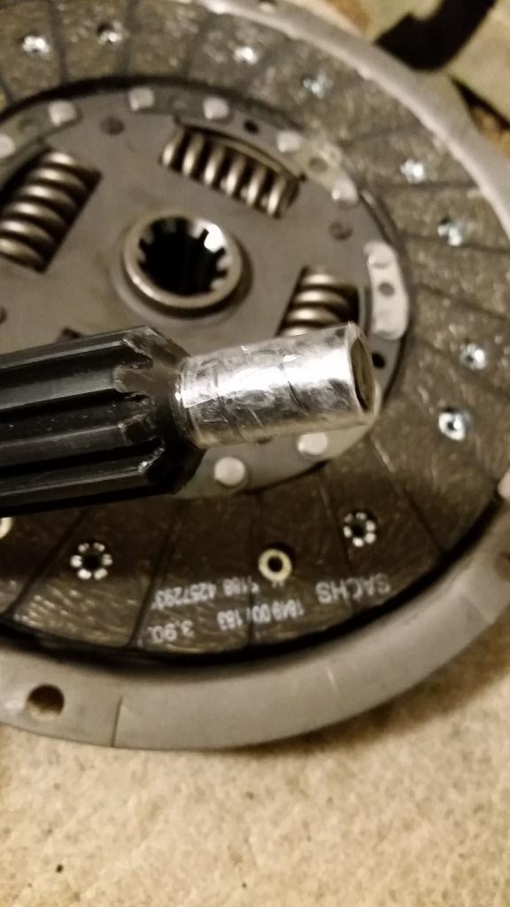

LUK has a good reputation for rebuilt clutches, so I picked up one of those. The stamping is exactly the same- Sachs MT 240. I’ll check my receipts to see where I got the pilot tool, (EI?) but the end diameter was too small for the pilot bearing and I added a few wraps of tape to build it up. It’s pretty simple to put the tool in the clutch disc splines and put it into the pilot bearing. Next, align the new pressure plate on the 3 flywheel pins and start tightening the 6 bolts in a star pattern. I need to put the final torque to them still.

Just to put all the info in one place- Per the manual, the 6 clutch cover plate or pressure plate bolts are torqued to 22Nm per Jim L that's "16-18 ft lbs in a star pattern in 2-3 steps to avoid damage to the cover. Loctite: one drop only on flywheel bolts, none on cover bolts." Hopefully the gearbox goes back in tomorrow!

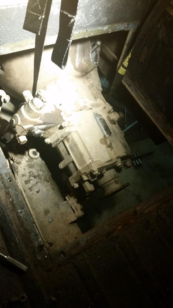

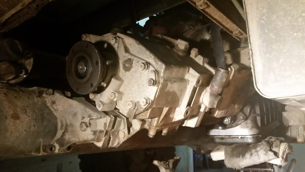

The gearbox is back in. Using the strap from above really made it simple and easy to manuever the box and turn the drive shaft until the splines engage. Super slick! Next stop- bleed the clutch.
