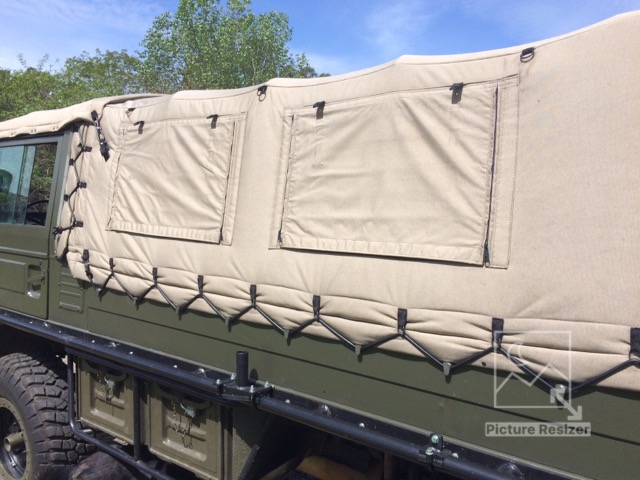

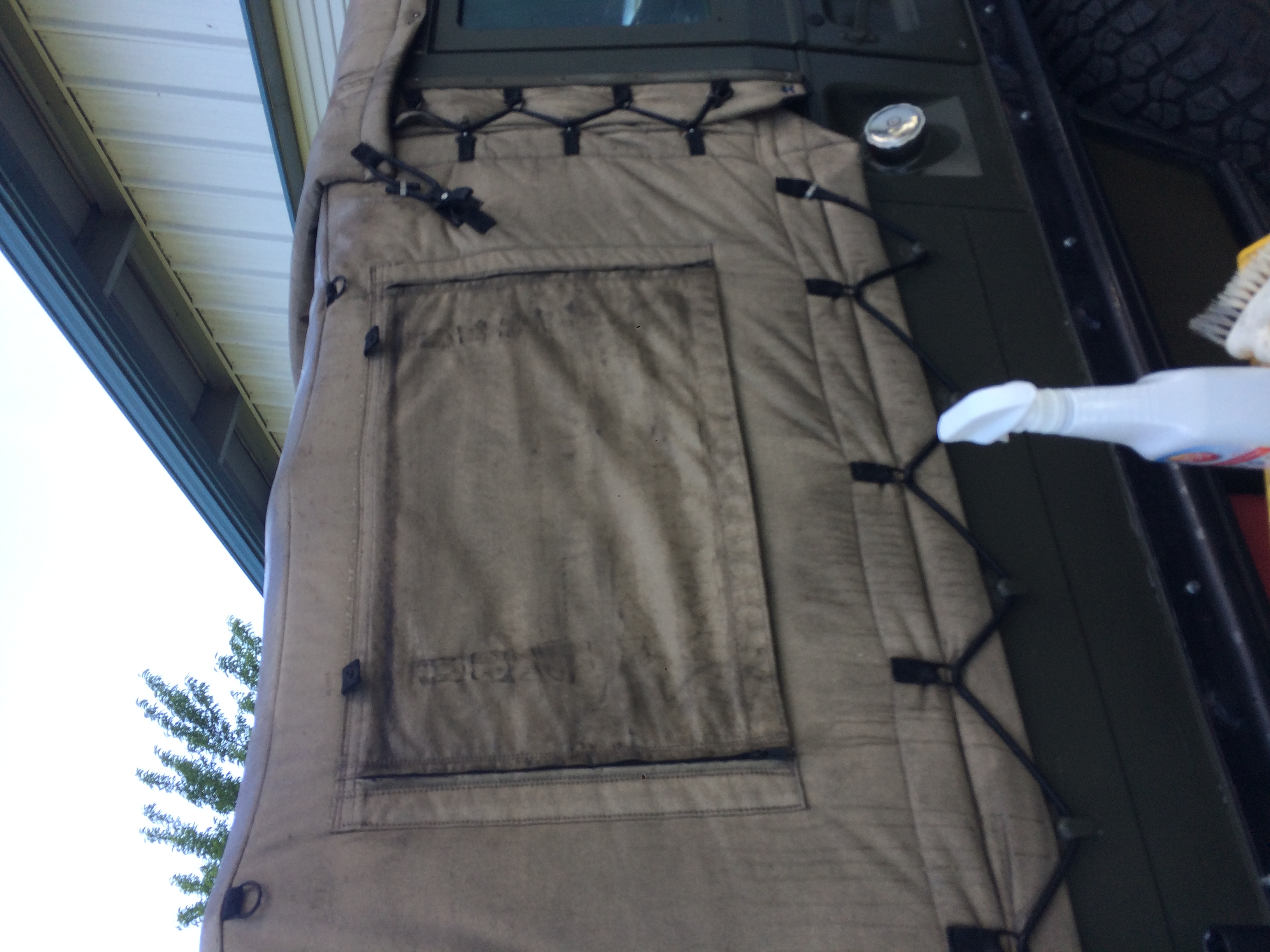

I used 303 fabric cleaner, it is actually a multi surface cleaner. While it did not get it perfectly clean it did a pretty good job. I also use a pressure washer to rinse the cleaner and dirt out of fabric with the pressure dialed down.

Not bad!

After the soft top completely dried, I coated it with 303 fabric guard. Probably 28 ounces of it.
I also coated some cushions on the deck with the fabric guard, forgot to put them away and the rain came down pretty hard. Pretty good water repellant I hope the UV protection is as good!
