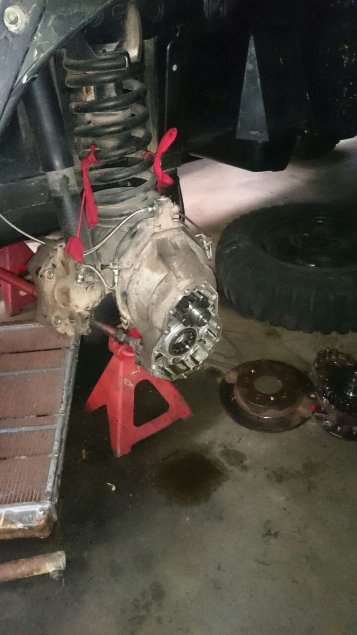

After a long time,, here's a continuation of the build...
Portals are out to be machined for a different PCD and with studs fitted

Just to share some of the Mods I have decided to run on the Pinz, in consideration of the super hot weather and commonality of parts in our part of the world:-
1) Re-machine new PCDs 139.7 , 6 holes to match most Pickup Trucks PCDs here.
2) Separate Oil Cooler for the ATF away from the radiator
3) Add on Engine Oil Cooler
4) Fit in adapter to use commonly available Toyota Oil Filter.
5) Recore the radiator and remove the built in Transmission Cooler
6) Simplify the piping and routing for the Engine Coolant
7) Junk the old AC and add on a more efficient AC with double blower.

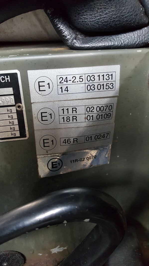

Anyone knows what do these notation means?
- What are these notations?

this are copy labels from mark of conformity of break´s, lights, seat belts, seats and glasses. https://de.wikipedia.org/wiki/ECE-Pr%C3%BCfzeichen
Re: Reborn as Curry-Pinz
Thanks for this, learn something everydayThe true Pinzgauer´s wrote:this are copy labels from mark of conformity of break´s, lights, seat belts, seats and glasses. https://de.wikipedia.org/wiki/ECE-Pr%C3%BCfzeichen
