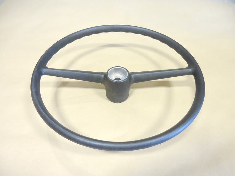

Has anyone restored a steering wheel successfully? Mine is badly chipped and generally scabby. A professional restoration costs a fortune. Does anyone have any advice?

I've seen good articles on restoring them from the VW bug and bus crowds. Usually involved filling chips and cracks with an epoxy or other material and then grinding it smooth and painting. Or get a new one - EI had some new steering wheels from a Unimog which were very similar at a reasonable price.

There are articles on eastwood.com on steering wheel restoration... And then there is $99 for this https://expedition-imports.com/4064600203
