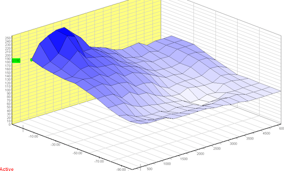

I think sharing our tune files is a good idea....i have a few maps from other peoples projects Jim shared with me when i was trying to get the system tuned initially. mine now looks nothing like any of them. its hard to believe they are all maps for the same engine. Mine is attached if anyone is curious, someone is going to tell me im nuts for sure.

Well, not NUTS, but ? LOL....someone is going to tell me im nuts for sure.
Frankly, I've found that with my map (not handy to share at this moment) that the low vacuum (pedal to the metal) end of the fuel map is fairly flat across the rpm range (where yours is quite peaked at lower rpms); this gives roughly a 12:1 fuel/air ratio which is somewhat overly rich but gives the most torque. One or two steps down in vacuum from there the fuel drops to the 13-14 range for better fuel efficiency. Myself, I'm probably nuts as I cut the fuel to zero at the highest couple of vacuum steps at 2000 rpm and above; this kills the "popping" on downhill grades. Yes there is a separate spot to program this in, but I can best see that it is happening by programming it into the fuel map. Maybe by next weekend I can get my map and show you what I mean.
But in general, I set my fuel map based on the fuel/air ratio from a wideband sensor (which you should have, too). As I said, WOT (wide open throttle) should be on the rich side at about 12-13:1. It can be leaned out at less than WOT but typically is still a bit rich for air cooled engines. I found out that if I leaned it out, not only did I loose power but also had to really put my foot into it and actually used more fuel if too lean. Have you looked at what your O2 sensor is saying at different operating points? Honestly, my truck mostly runs either at idle or almost WOT when being driven; hardly ever is it in between those points!
Re: Cold Weather EFI Issues
Right, i definitely did not tune with efficiency in mind. I used the wideband sensor for tuning and applied adjusments from 20 or so runs through rpm and vacuum ranges with the desired a/f set for somewhere near mean best power, i believe 13.3 or so. then i shaped it by hand a bit to make it smooth and fix some of those errant pops on decel. I run with the o2 sensor off above -70 kpa, and below that i try to keep it at around lambda for the exhaust smell and sake of the plugs. i also used 20% accel enrichment. i get 11 to 12 mpg on the highway averaging about 3800 rpms, whatever that equals in speed, maybe 60ish. i do find there is a huge difference in the power the engine produces in colder weather....wish i had larger valves
