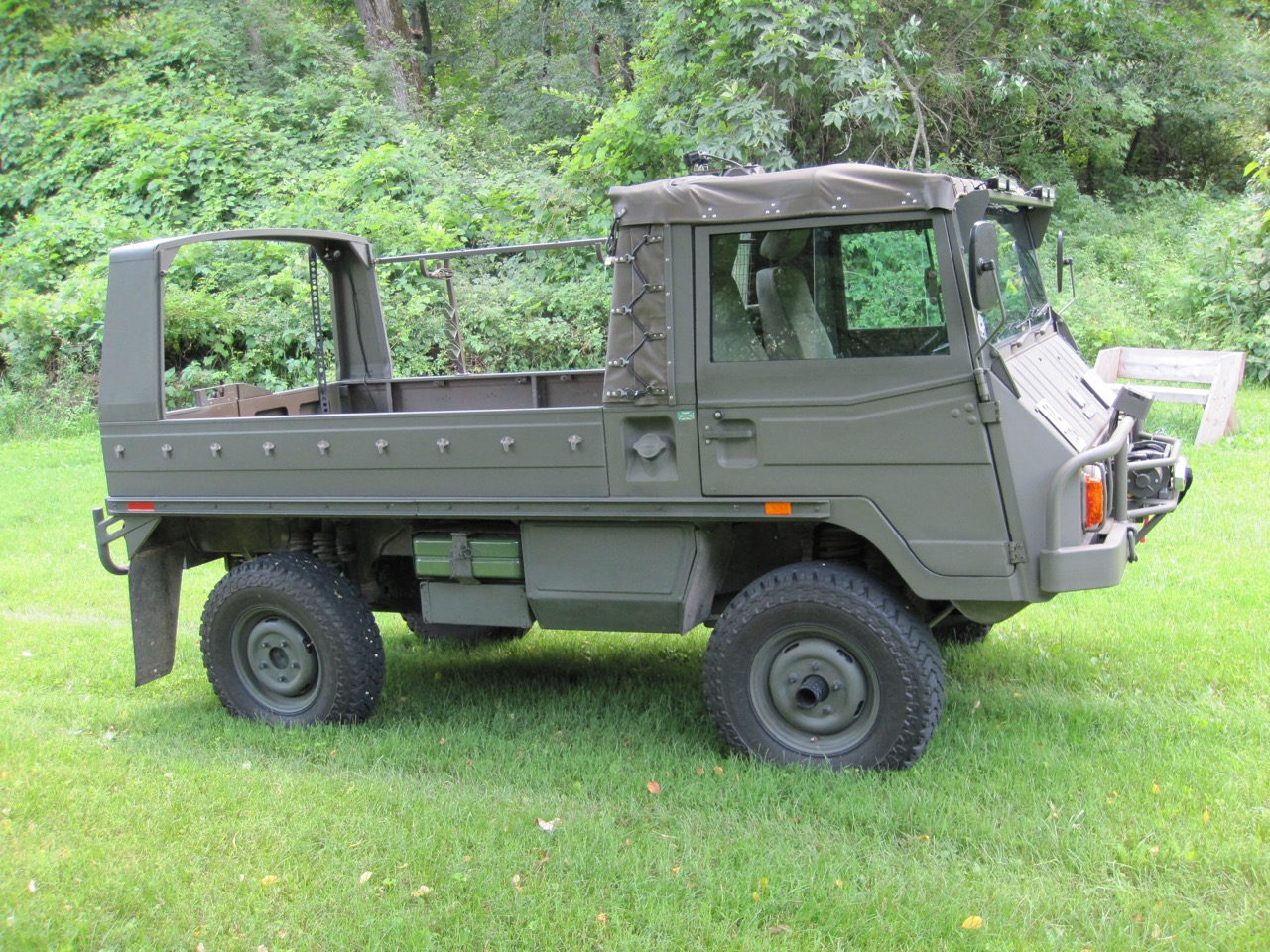

Here are a few photos that may help:
Parts are illustrated here: https://swissarmyvehicles.com/pinzgauer ... p-hardware
The bulkhead has no additional hardware, just 4 holes for the hooks to to go in to. I added extra snaps to keep the divider a bit tighter and less drafty.
The side flaps of the cab divider have to be folded to the inside when attaching the rear top.

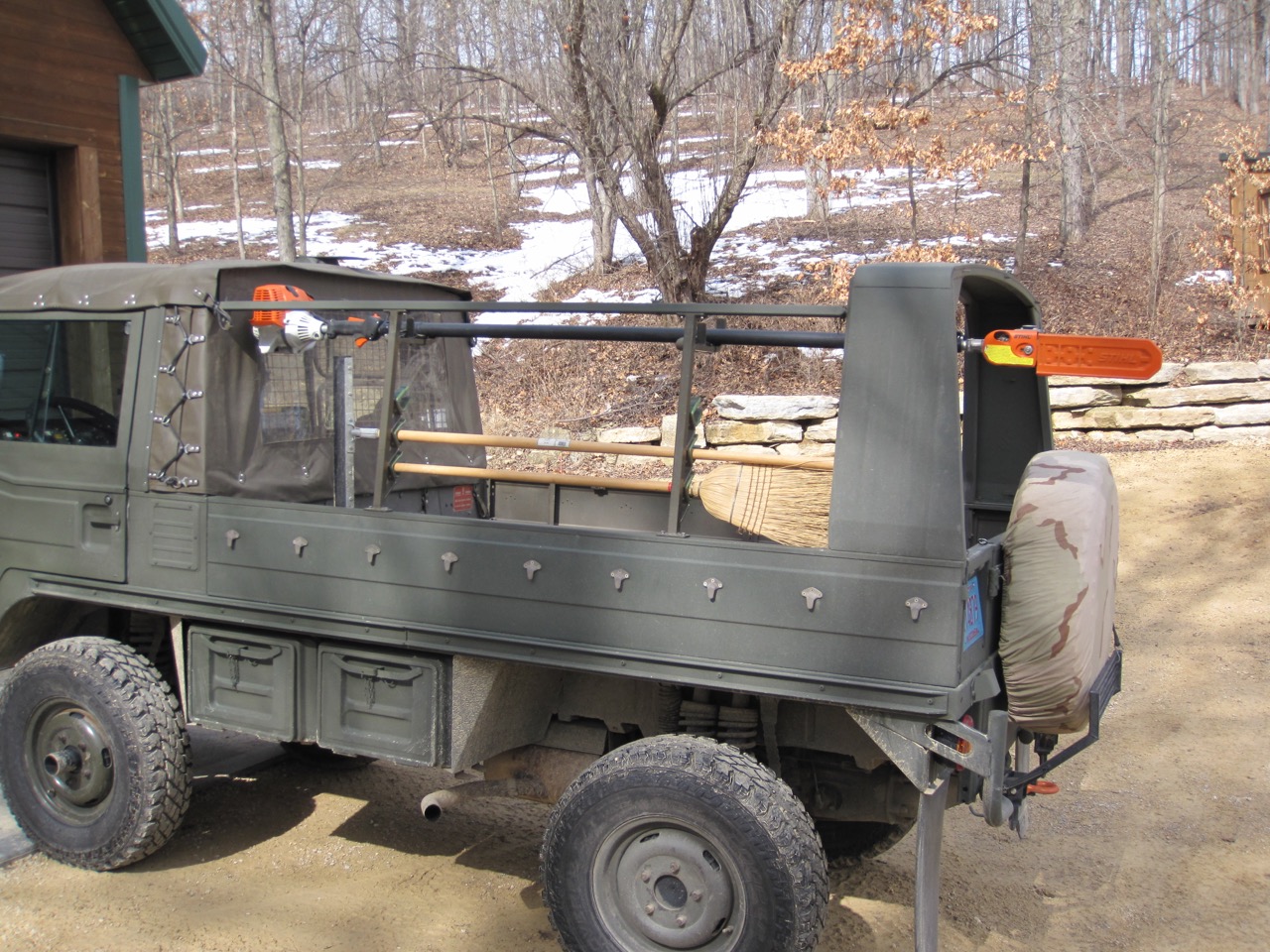

While on the subject of “what the heck are these?”
What are the lighter green rifle rack looking things visible in your second photo on the left hand side?
My truck has one set of them located more towards the back on the left side but I have no idea what they’re for and the manual yielded no results.

Posts: 1644
Re: Cab divider question
My understanding is that they were intended to be rifle racks.
That Pinz didn't come with them installed but I added them for carrying shovels, rakes,fishing rods, etc..
