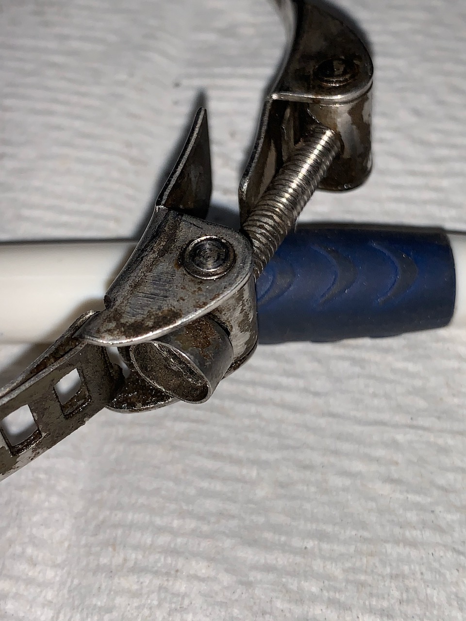

I lost the screw that is on the clamp. There are two clamps. One large clamp and one small clamp.
It is stainless steel this clamp. As is the screw. So no magnet is gonna find this thing for me. Trust me I thought of this already. In fact I even tested the one screw I didn't lose to see if it had any magnetic properties whatsoever. None. Nada. Zip.
The four screws that complete the split boot are available from SAV or could be fabricated. But that is not what I'm looking for.
The screw that tightens the ring clamp together is what I need. I could go the hardware store and get something that is close...…..but the screw I am missing has a very unique collar at the screw head. If you look at the clamp I'm talking about you'll see what I mean.

Is this what you're looking for?
You could probably use this type of screw also. Available from McMaster.com and likely Fastenal also.
Screen Shot 2020-03-20 at 6.36.34 PM.jpg (471.17 KiB) Viewed 6168 times
Or I can remove the screw/bolt on my old clamp and mail it to you. PM me with your address.

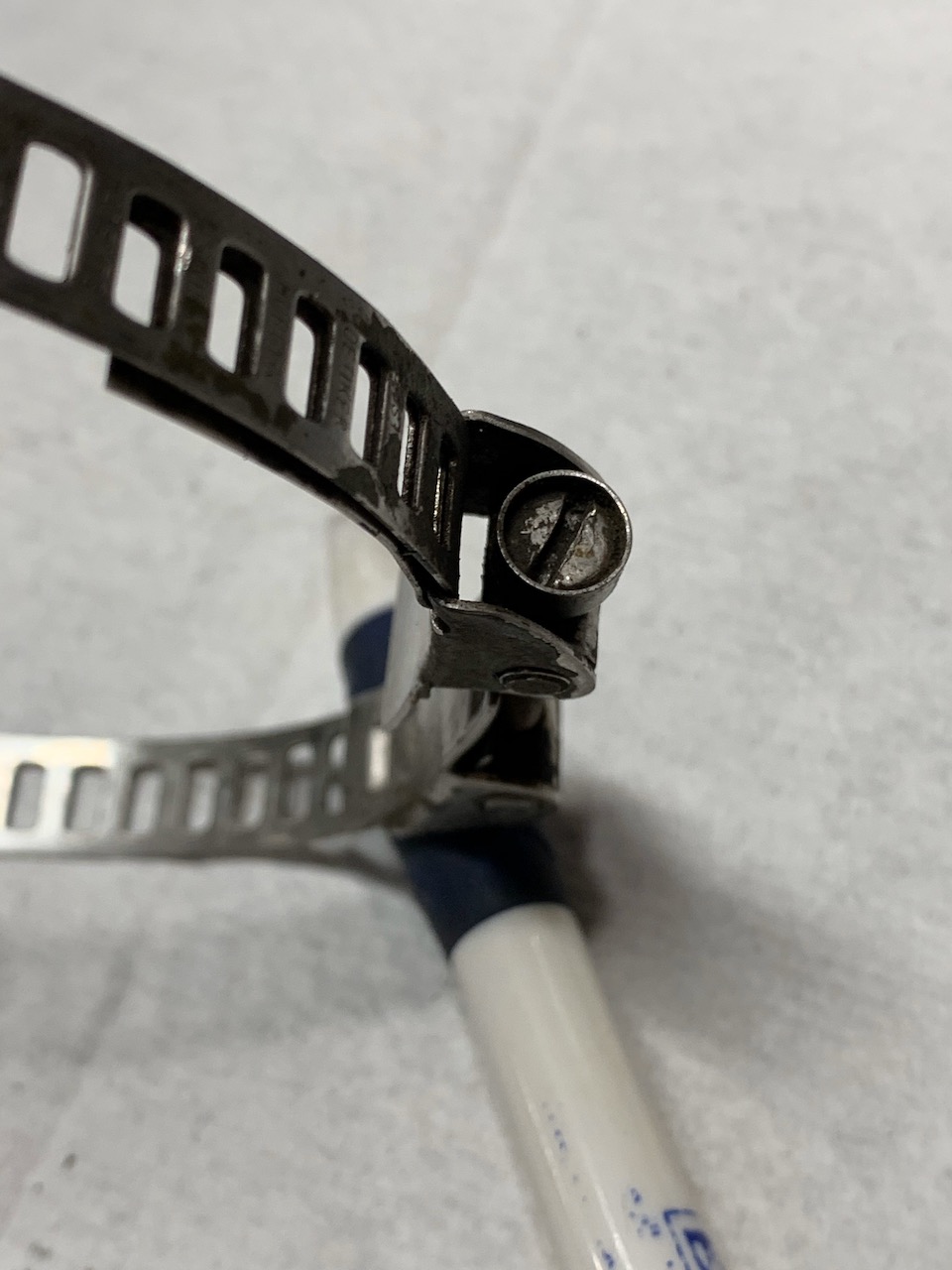

"..but the screw I am missing has a very unique collar at the screw head"
Its only purpose is to prevent a screwdriver from slipping out of the slot; a screw with a washer will do.
