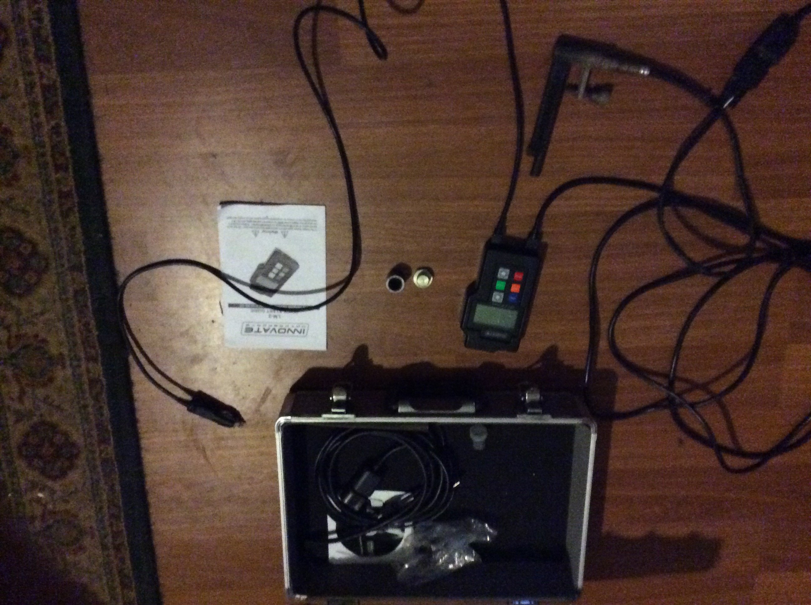

These Innovate exhaust gas readers are great for basic fuel mixture tuning, achieving the desired/correct air fuel ratio (stoichmetric). You can simply clamp the oxygen sensor into the tailpipe for basic mixture setting or re jetting your carbs for altitude etc. They are also great for LPG tuning when used in this manner as well. FYI the black box can be eliminated and a simple dashboard gauge can be used instead for the purpose of keeping an eye on the air/fuel ratio of your cylinders fitted with oxygen sensors. However the black box does have a data logging capability...dashboard clamps are available for this unit which is approximately 100mmx200mm. You’ll see the stainless bung RMEL spoke of as well, these can be added to one pipe (hottest cyl) as production EFI cars do or use two after first the Y joins (4cyl) . For pinz just before the heat exchanger, or go all out as RMEL has in his 710 and put one on each header close to the cyl heads. I’d consider this overkill unless you were converting to fuel injection or probably still overkill unless you were doing an independent throttle body EFI as designed for the bikemaker 712.
Which reminds me what happened there? Did the forum get any more information on how that work of art performed? It Looked really promising with the using of the relatively cheap production motor bike ITB’S. anyone heard how that turned out after testing?
