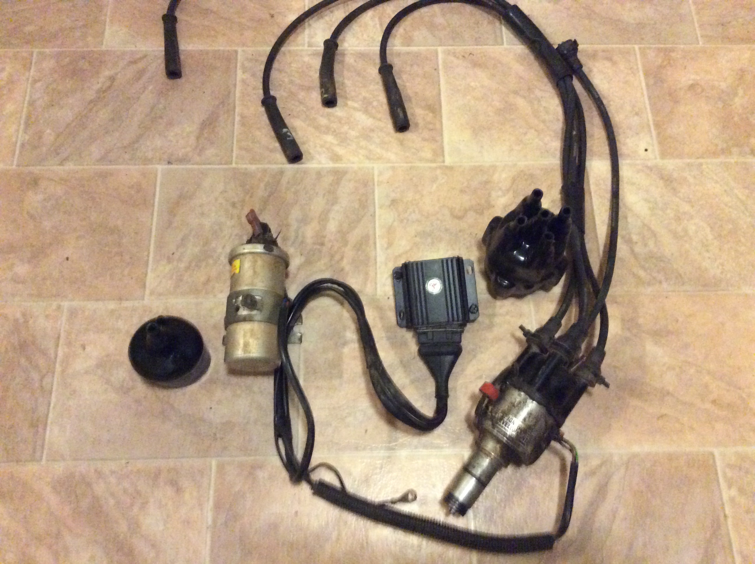

Just one more thing...pictured is my old ignition (now comes with as spare).
It was by no means a cheap or bad ignition in any way, it’s just that the SSI is far superior by having a strong multi sparked ignition all the fuel is getting burnt on each compression stroke instead of burning most the air fuel mixture and sending the unburnt fuel out the exhaust valves. It’s a no brainer...MSD ignitions increase torque and ignite more of the combustion chamber gasses therefore wasting less. The is equivalent to more torque for better economy and is the reason why race teams have been using MSD ignitions for the last 30 odd years. It’s a well documented easy way of increasing any combustion engines performance.
The ignition above is just an early VW ignition converted from points to electronic (Hall effect), the module (box thing) mounted inside the cab and therefore I was never able to drown it.
It was always reliable and performed as well as any 1980’s (if not better) electronic ignition. Scorpion ignitions from NSW, Sydney Australia built it approx 20-25 years ago and they are still in business. However when I enquired about a spare module for peace of mind his quote on this part alone was more than Ricks Pinzi SSI UNITS and gave me the MSD capability that my old one did not. Cheers Rick.
Rick if you happen to read this I’d be interested in a version 1 switchable advance curve unit as my dual fuel set up may benefit from this, if you have any old ones lying around let me know...I’ve been meaning to contact you via your website but never seem to Find the time. Cheers.

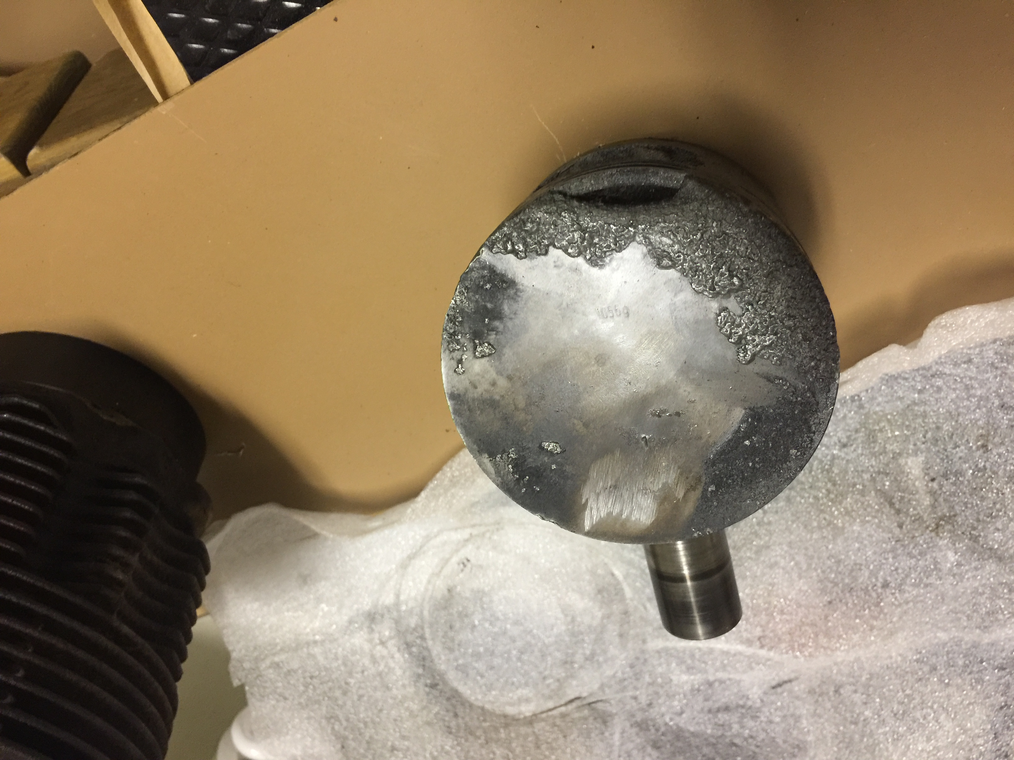

After melting my #3 piston, I want to add a temperature sensor to monitor #3 and/or #4. I found a 12MM CHT SENSOR designed for air cooled engines to be attached under an engine bolt or spark plug. Has anyone added this type of sensor or any other?
Yeah I had a CHT pickup under the #2 military spark plug (the recommended placement). Worked well... but are you sure that plug is seated properly over the ring pickup?? There's no way to test the compression with the plug in, obviously. Anyway, it did work for years and the temperature it showed was reasonable, but it seemed iffy having it under the spark plug. I just now had to take it out since I switched to EI's civilian/electronic ignition and the large metal cover on the plug boot did not leave enough room for the pickup.

“Has any board member ever overheated a Pinzgauer air cooled engine to failure point? “
I melted my #3 piston, does that count?

Looks like #3 was running very lean and thus hot. Lack of fuel flow or
a vacuum leak. If you haven't pulled the other jugs yet -- and you may
not need to, get a borescope in the other 3 cylinders and see what the
tops of the pistons look like. If your lucky, and the other 3 are good,
you could get a replacement jug and pistons (or bore the jug to match).
There are several sizes, 92, 92.5 and 93mm. The piston you pulled
should have a size stamped on it, the size depends if the motor had been
serviced when active, or serviced prior to export.
