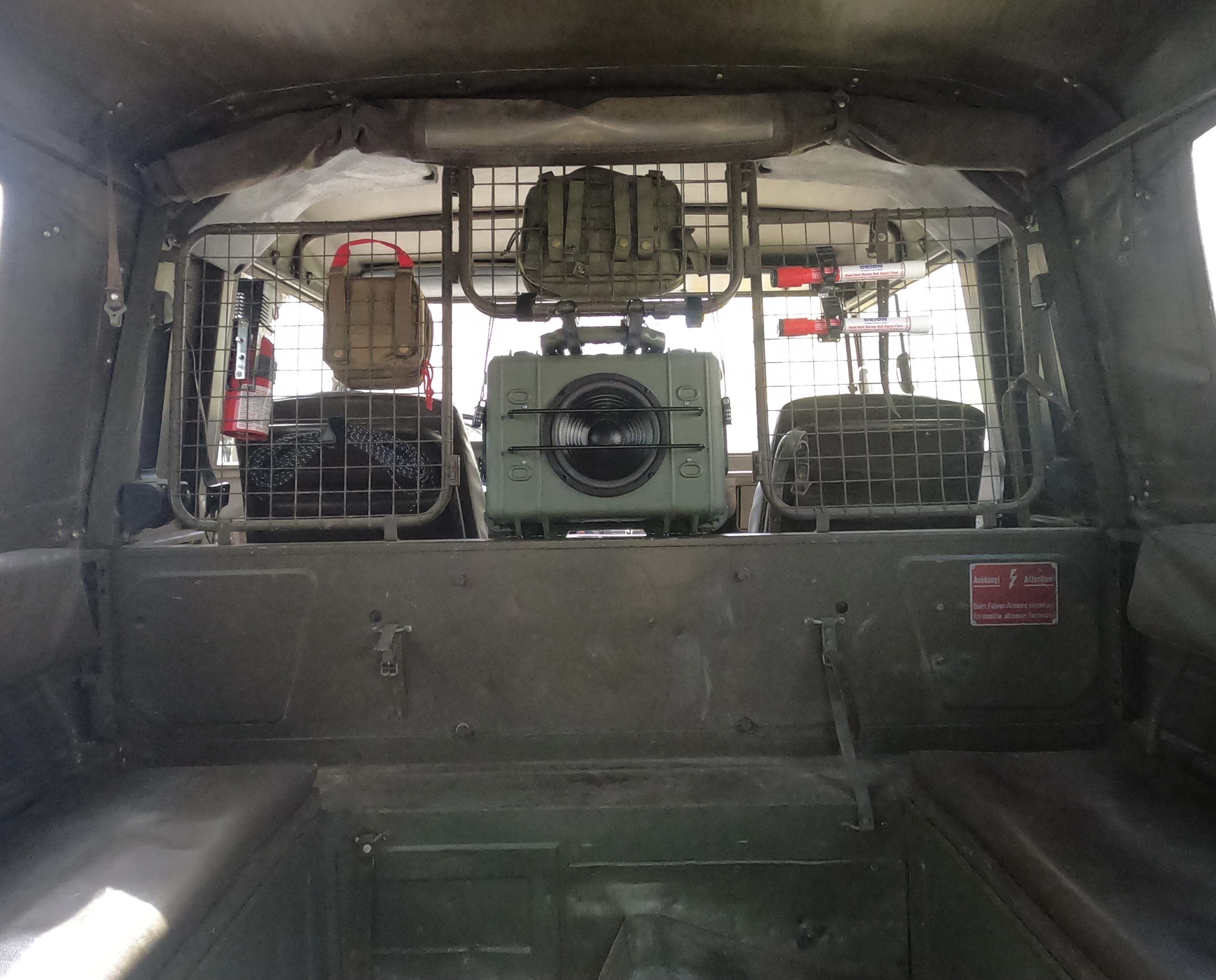

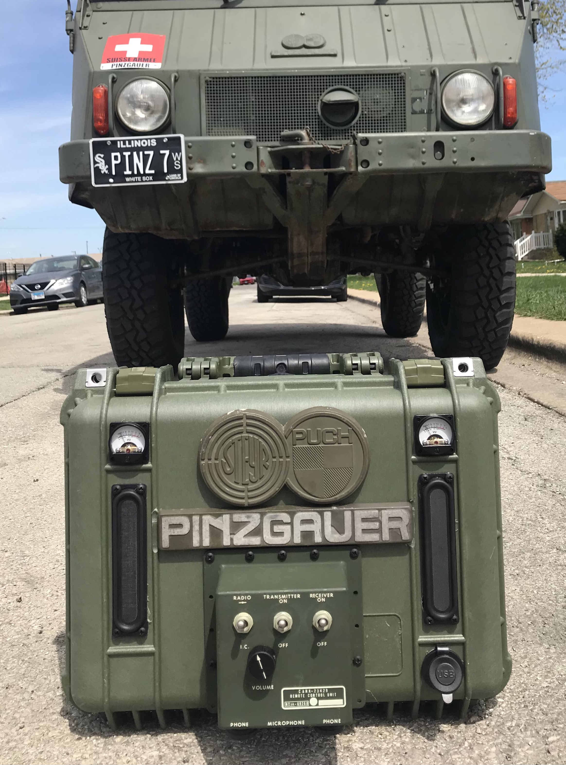

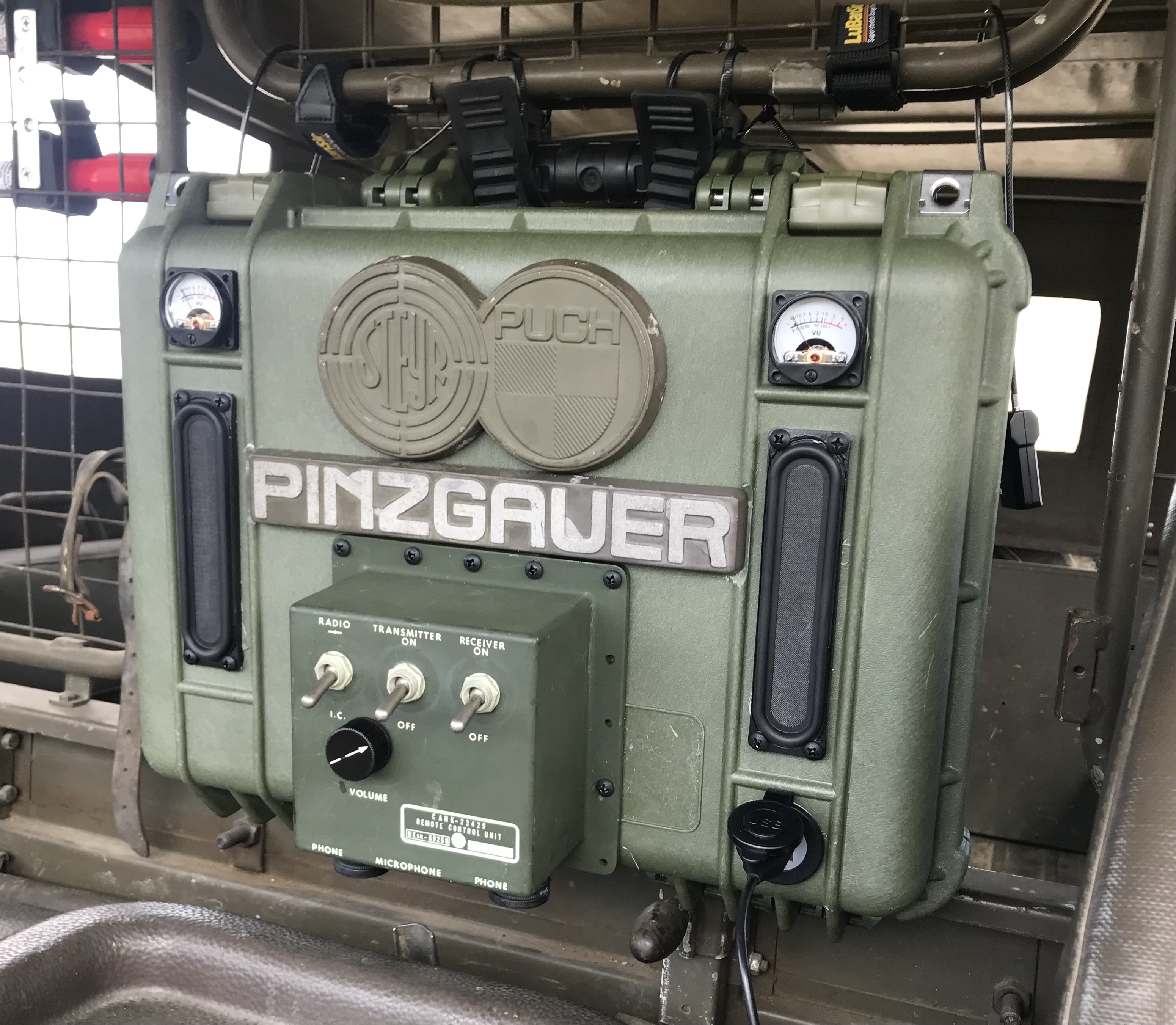

Here’s my solution to the lack of a sound system in the Pinzgauer. I worked with Hifi Case, who builds Bluetooth speakers out of vintage luggage. I used a Pelican 1450 case, which fits the Gate hole perfectly. The speaker can come in and out of the vehicle, as it’s Lithium Ion battery powered. It has Bluetooth and a 1/4 cable jack, VU meters, front, side, and rear speakers, and usb charging. I used an old army radio control box for the switches and volume. He did a fantastic job bringing my idea to life, and I couldn’t be happier.

The thing looks like it could have been issued by the Swiss military. Well done!
