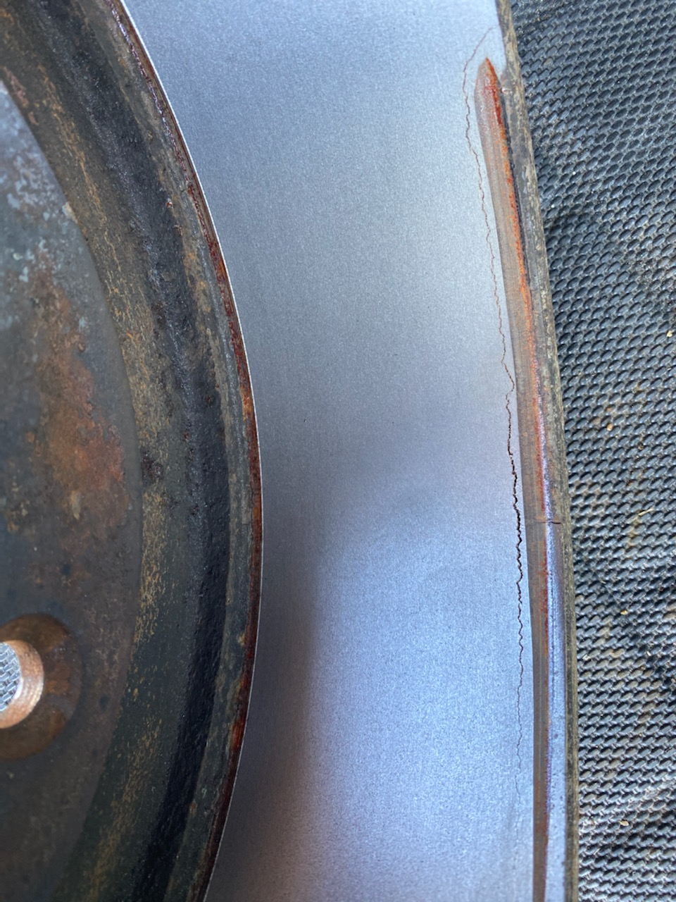

I retrieved my drums after resurfacing today and all but one look great. One was found to be cracked so I have to order new anyway.
pinz drum crack .jpeg (381.15 KiB) Viewed 19634 times
