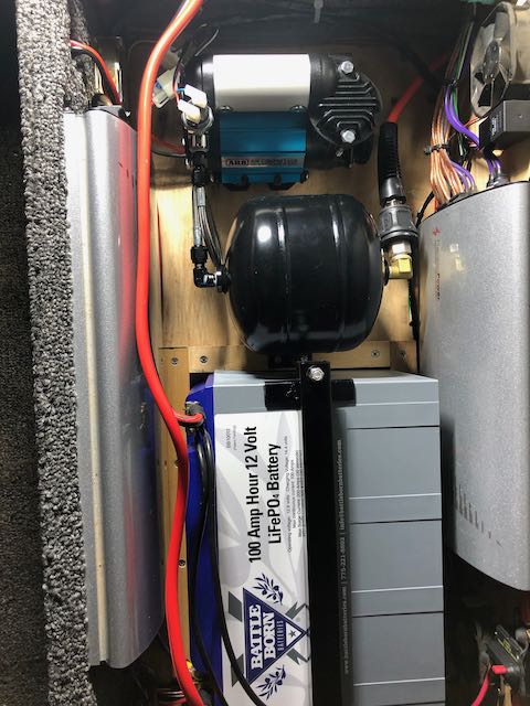

Last year I had it with my 4 Yellow Tops in my 710K and switched them out for a Battleborn
100 A-hr battery, charging via a REDARC dual-input multi-state charger BCDC1225D. Sources
from either the Alternator or roof Solar. A huge reduction in weight, and enough freed up space
to toss in a ARB compressor.
Power Box.jpeg (94.03 KiB) Viewed 10509 times
Just some initial feed-back, hope this helps.
