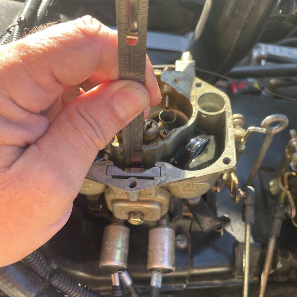

I recently set the floats in my Zenith carbs, the needle valves in each took 2-1mm shims. Shims come in .5mm and 1mm thickness. When you add shims, the fuel level will drop 4 X the thickness of the shim. 1mm shim = 4mm fuel drop.
I found it easier to measure the fuel level in the bowl while I was verifying the shims. Use a small ruler and mark off 18.5mm. I was able to get it exact and the engine runs great now.
I had installed 2 new float assemblies that I bought from Scott, which is actually 4 floats total. There is a float for each barrel.
You can remove the top by removing 5 screws and the accelerator pump rod at the upper arm. Angle the top right and the arm will come out and go back in. Leave the fuel line connected.
