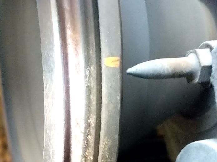

Ignition is Pertonix with original cap & wires (not civilian). Timing was set by Andre and me two years ago, and IIRC is set at 8mm. Might have the Unimog spark plugs in it.

So....adjusted the timing to be about 2-3mm advance when cold, and no improvement.
I don't think it's a mechanical thing because when it idles high after coming to a stop, it'll idle down correctly if pulled down by letting out the clutch a bit and releasing it.
It now has the correct Pinz spark plugs, and correct timing, but still not dropping to the right idle after it's warmed up.
