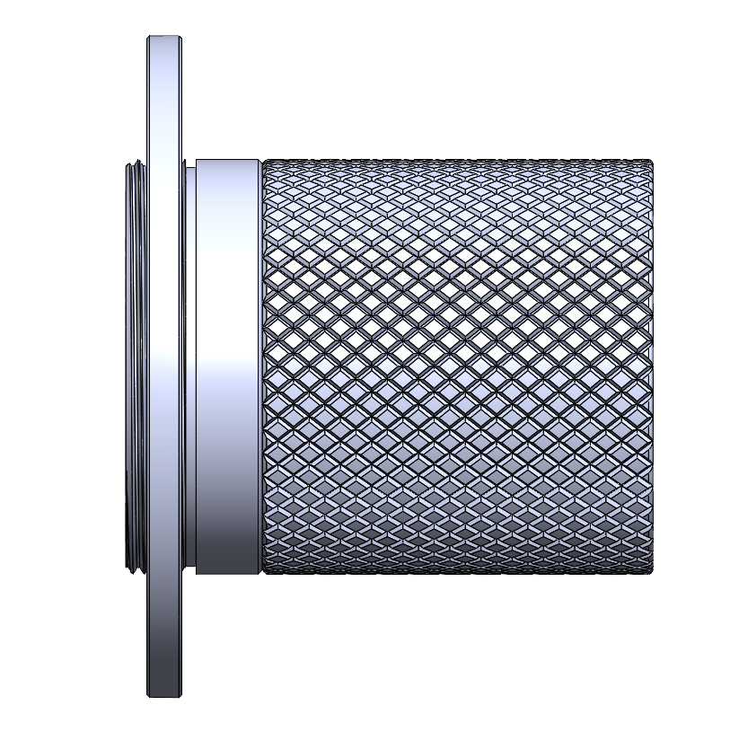

If you can just get a idea of what the flange part should be thickness and OD and the OD of the step portion I will draw something up.

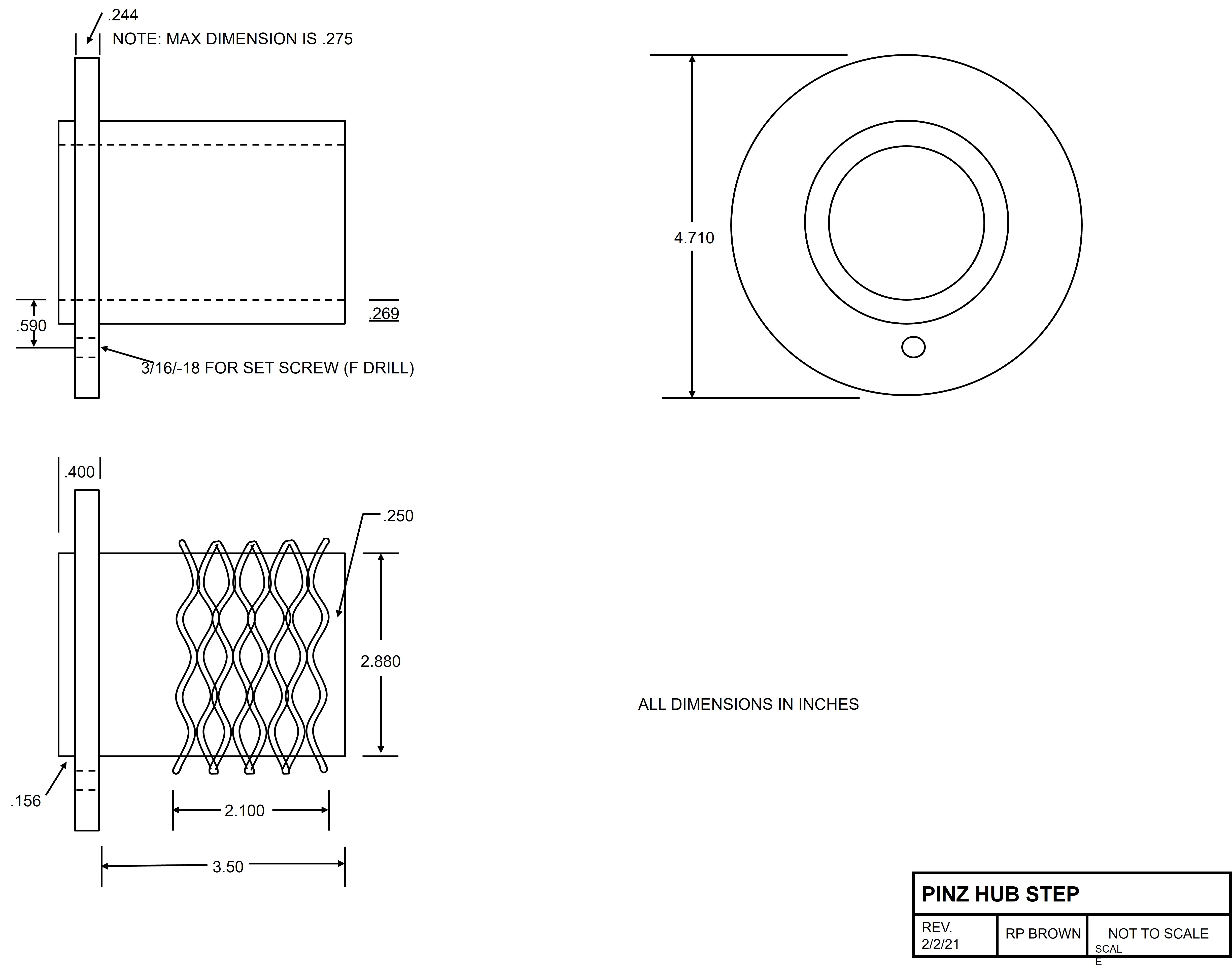

I ended up building me own. Here's the dimensions I used. The flange is just less than the gap between the wheel and the brake housing so that it won't interfere with wheel mounting. The set screw keeps it from rattling once installed. There's nothing magic about the wall thickness on the step itself - mine was based on some scrap I had lying around.

Here is my idea based on your dimensions. The two piece design keeps the price down and makes it so they are slightly adjustable to take out any play. I know that the main issue going this route is they could come lose but with some red loctite and the friction between the threads and the face against the hub I do not think it would be a issue.

This looks great to me.
I'm in.
How much would you charge me for it? I would like to buy 2 sets, for all 4 wheels.
Also, do we need some form of rubber pad between the hub step an the wheel, to eliminate rubbing of aluminum against metal?

Do you mean for the flange or where the center piece butts up against the hub or both? Since you can lock it tight I am not sure how much it would move and rub really.. The center piece would rub as its tightened but not sure after that but I wouldn't think the center of the rim would flex much if at all??

I would like to eliminate any rubbing against the wheel (if I can help it), be it flange or center piece.
Maybe some sponge tape could help achieve that.
I also think the center of the rim won't flex at all.

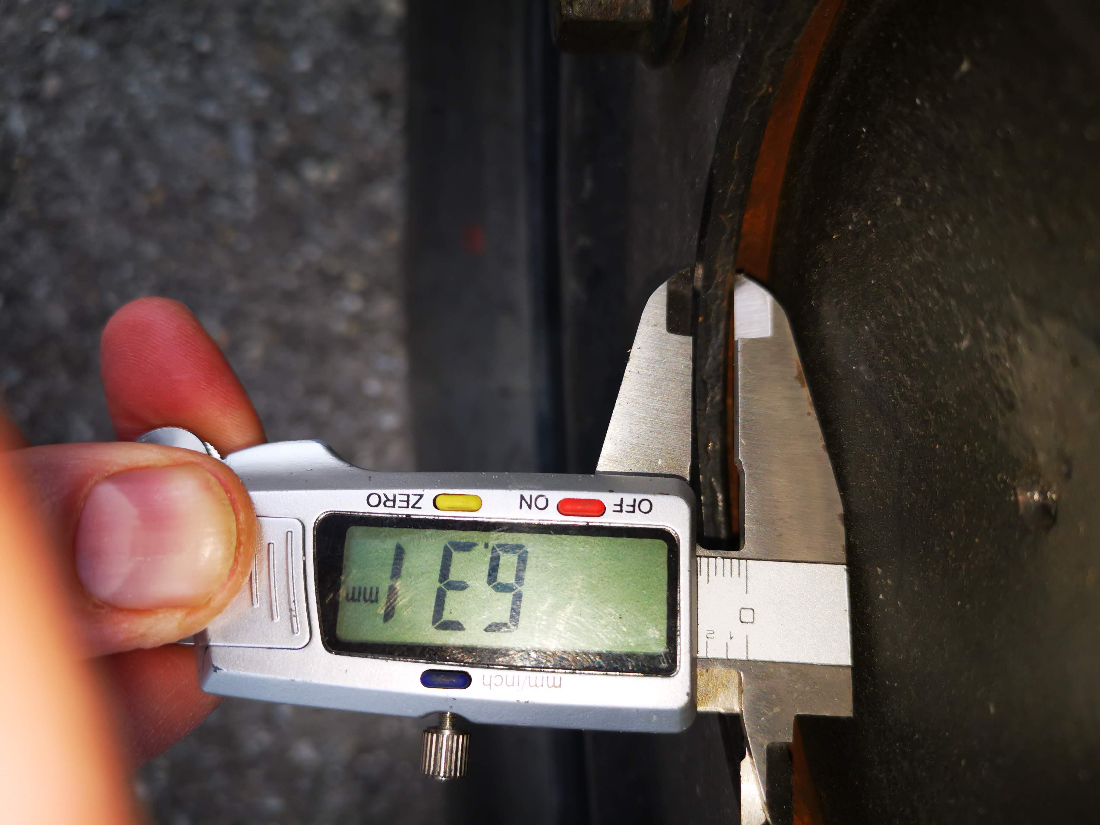

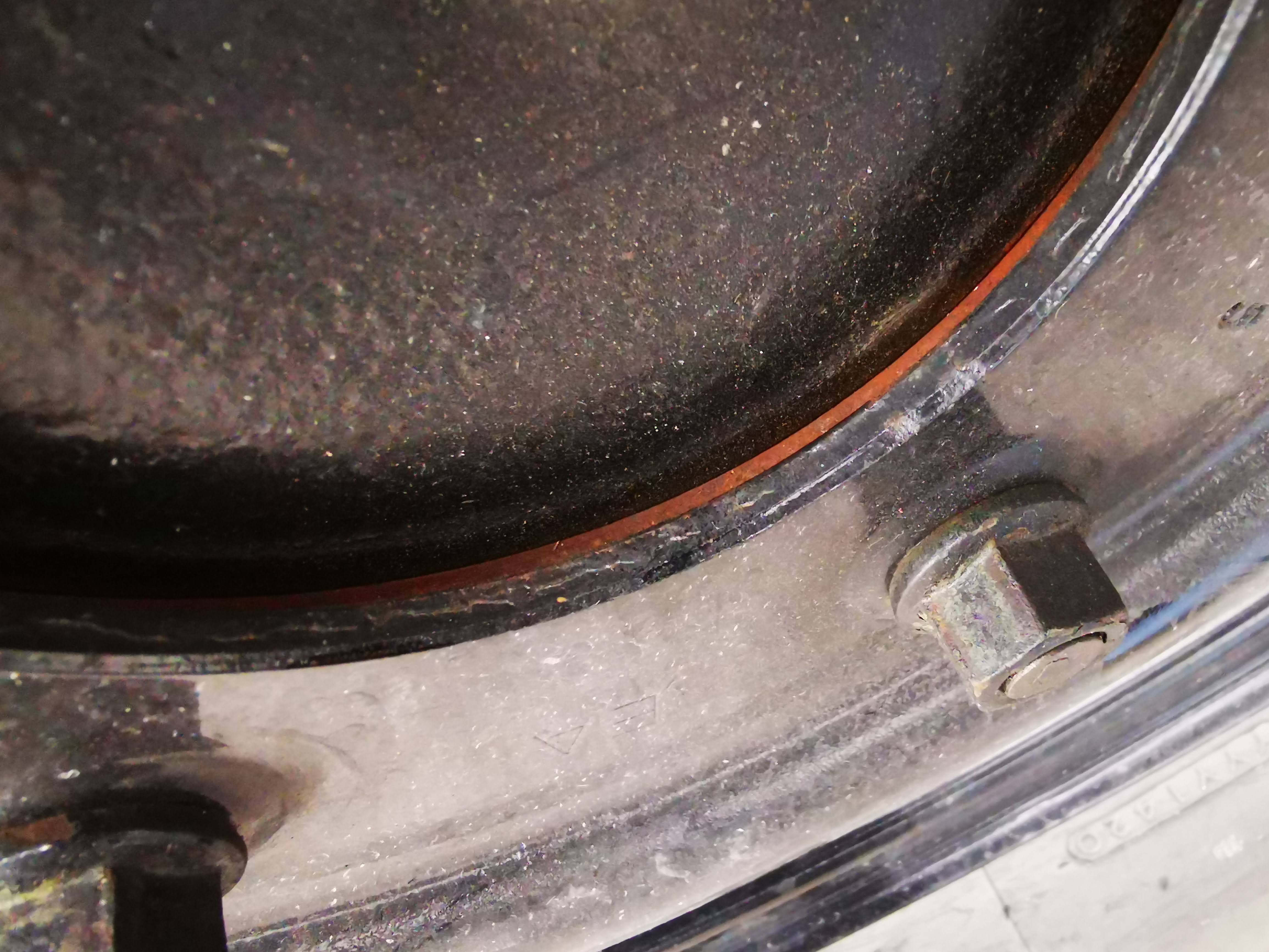

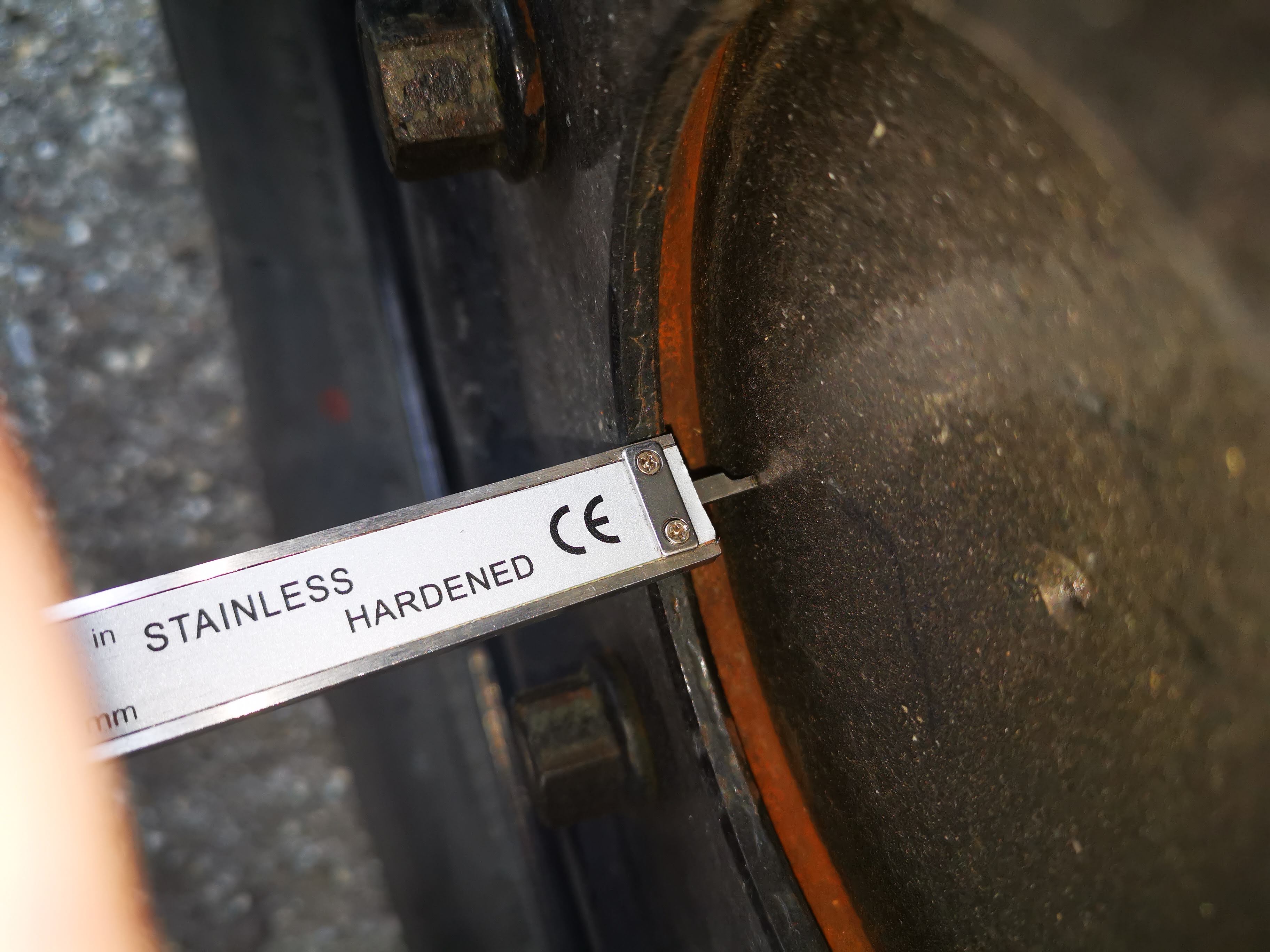

checked my measures today (mm), Pinz 710M ex Swiss army
rim closeup.jpeg (645.53 KiB) Viewed 14464 times
internal diameter.jpeg (387.19 KiB) Viewed 14464 times
rim thickness.jpeg (375.16 KiB) Viewed 14464 times
gap 8.8mm.jpeg (690.75 KiB) Viewed 14464 times
