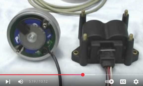

PinzSSI 1.0 introduced 2013 (1.x version a couple of years later not sure if a 1.1 or 1.2).
> 1.0 is the only module version that can drive the primary Coil winding DIRECTLY. The A/B outputs
can sink several amps to ground acting as ePoints such as a Pertronix ignitor.
> The Coil pack used is a 3.0 Ohm primary, and not likely to fail. If coil does fail, a replacement MUST
have a primary winding no less than 3.0 Ohms or the module will overheat. These high resistance
Quad packs are VERY hard to find.
> A possible alternative is a pair of 3.0 Ohm wasted spark Harley coils.
> If you have a 1.0 version it has a relay on the Coil board to switch power ON to the Coil and module
via lower 12V battery. The Coil has a 3-pin connector connecting back to the module via the harness.
** IMPORTANT Note: 1.0 Coil Pack will NOT work on any PinzSSI version other than 1.0.
Only a Wasted spark Coil pack with a 3.0 Ohm primary can work on 1.0
A more modern Coil pack with built in Igniters will NOT work on 1.0.
This image is a PowerARC ignition for a VW introduced before the Pinz. Same Coil used.

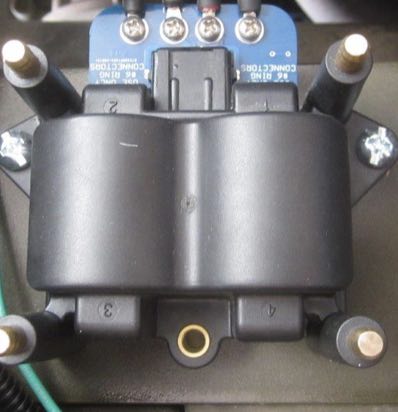

> 1.x Coil is used from 1.x on through 3.0. This is a CUSTOMIZED coil pack to maintain compatibility
with the module signalling levels. Coil includes a terminal board embedded in the connector housing.
Board includes circuitry to drive the primary windings AND maintain module compatibility.
> Speculation why the Coil changed was a lack of available high impedance Quad packs.
Industry moved to higher voltage output but lower impedance primaries, ~0.5 Ohm EXCEEDS module
capability. A likely generic Coil used is IGN-4 tower pack common for Megaspark applications.
> Power delivery changed; Coil power direct from the bottom battery, module power from the switched
24V Carb solenoids BUT with a 300 Ohm resistor in series to drop the voltage to 12V for the module.
** IMPORTANT Note: There is NO off-the-shelf Coil Pack replacement without modification.
This image curtsy of PinsSSI installation manual, shows Coil pack with ckt board modification.

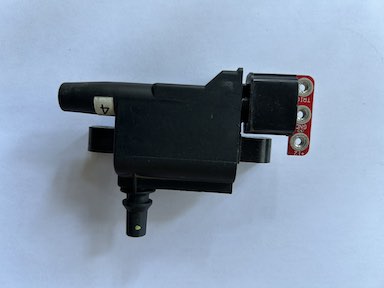

> Different Coil, modified pair of wasted spark, each with two HV terminals. Similar approach to adapt
to module using a terminal board (+12V, GND, Trig) embedded in connector housing. Board circuitry is
simple, this "smart" coil has built in driver (Mazda Protege 1999-2003 wasted spark Coil).
> Speculation why the coil change -- to consolidate part types. This coil was used broadly across many
PowerARC options, for 2, 4, 6, and 8 cylinder use cases, with 1 or more of the same coil.
The weakest link with the 4.0 version is the "Mazda" coil pack. This was not a good choice IMHO.
Image shows one removed Mazda type coil pack with embedded circuit board.
As used on a Mazda, the vertical HV terminal has a stem that connects directly to a Spark plug (COP)
the other HV terminal, horizontal, connects to a second spark plug with a cable. PowerARC re-purposed
the coils by removing the stem and connecting a boot/cable to that terminal -- a spring is necessary
for electrical connection. Also there is the additional embedding circuit board for compatibility.
There is evidence of "failed" 4.0 units. One potential issue is the propensity for the HV cable with a
right-angle boot to pop off the "stem" terminal. Now running on two cylinders it can result in
"un-clamped" overvoltage which could lead to a stressed igniter. What causes the cable to pop off is
the Spring being too long, over compressed internally, resulting in a force pushing it off.
** IMPORTANT Note:
Make sure the Spring for the vertical HV terminal extends no more than 3/8" beyond the end of the
right-angled boot! Use a small Zip tie at the base to secure.
Although there is no fundamental reason why the Mazda coil isn't reliable with good HV connections.
