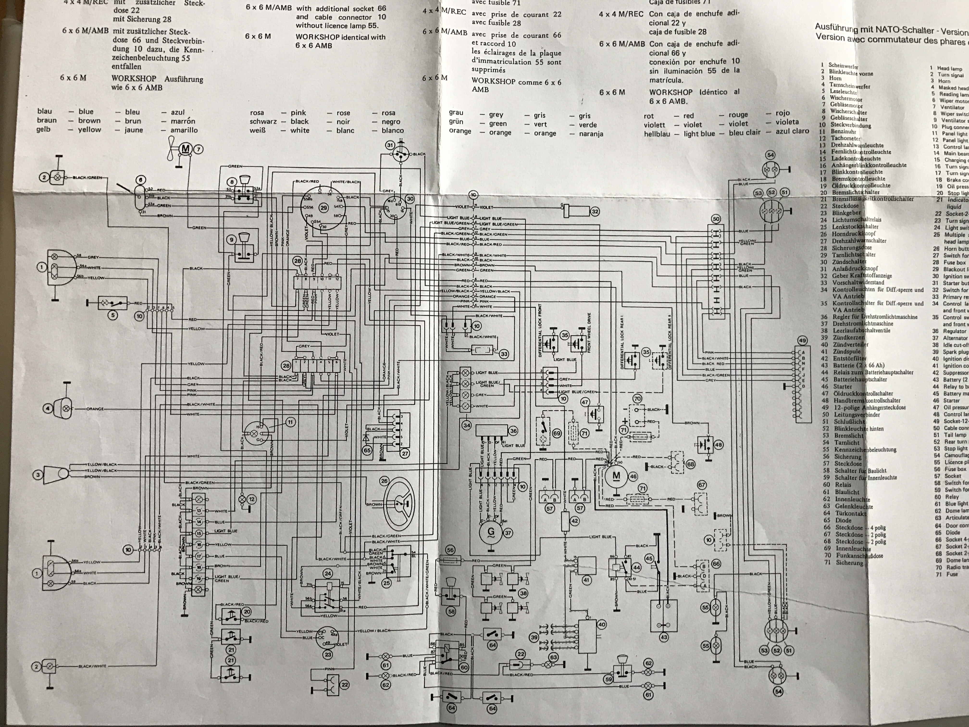

Didn't know I had a copy of the Austrian version schematic, attached. It's simple !
On the Swiss version the front and rear turn signals are separated and essentially a dual circuit
for front and rear and two blink sources from the hazard switch.
The Austrian is one circuit for left and one circuit for right with a common blink source. So if you
are not blinking on the right side but are blinking on the left that isolates your problem down.
Either a bad connection to the right terminal on the directional switch or all your bulbs on the
bad side are dead or a corroded connections.
The stock blinker needs a load on it to blink e.g. the filaments of the light bulbs.
