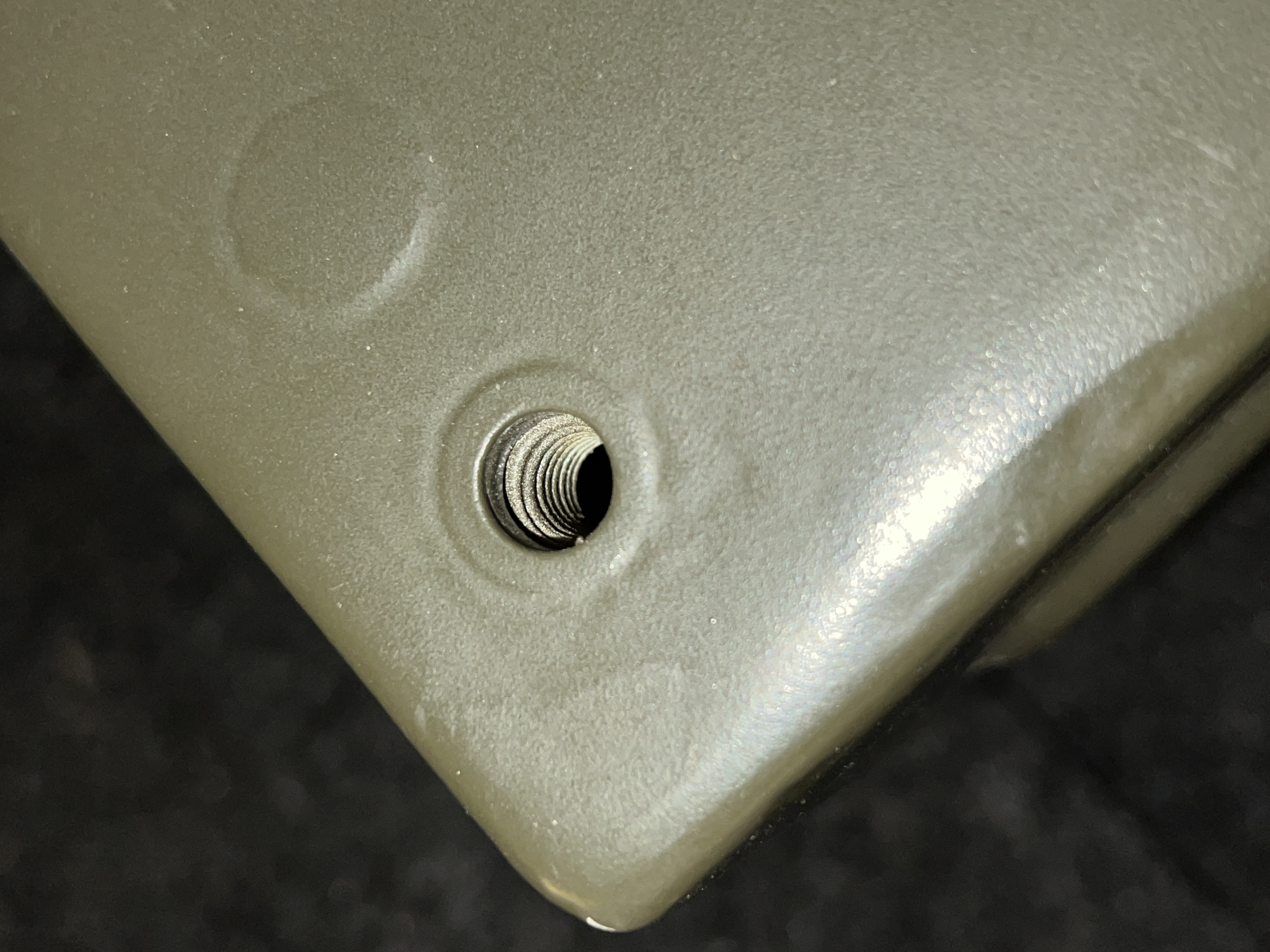

Good afternoon. I have what may be a silly question. How do you get to the lower nuts below the floor/shelf that the table supports rest on? My truck didn't have the struts installed. There are bolts in the holes. That just spin but won't back out. I really hope that aren't captive nuts in the frame channel that have broken free. I thought they would be in the corner of the fuel tank box, but no.

Those are nutserts/rivnuts and yes, yours are spinning.

See photo attached.
