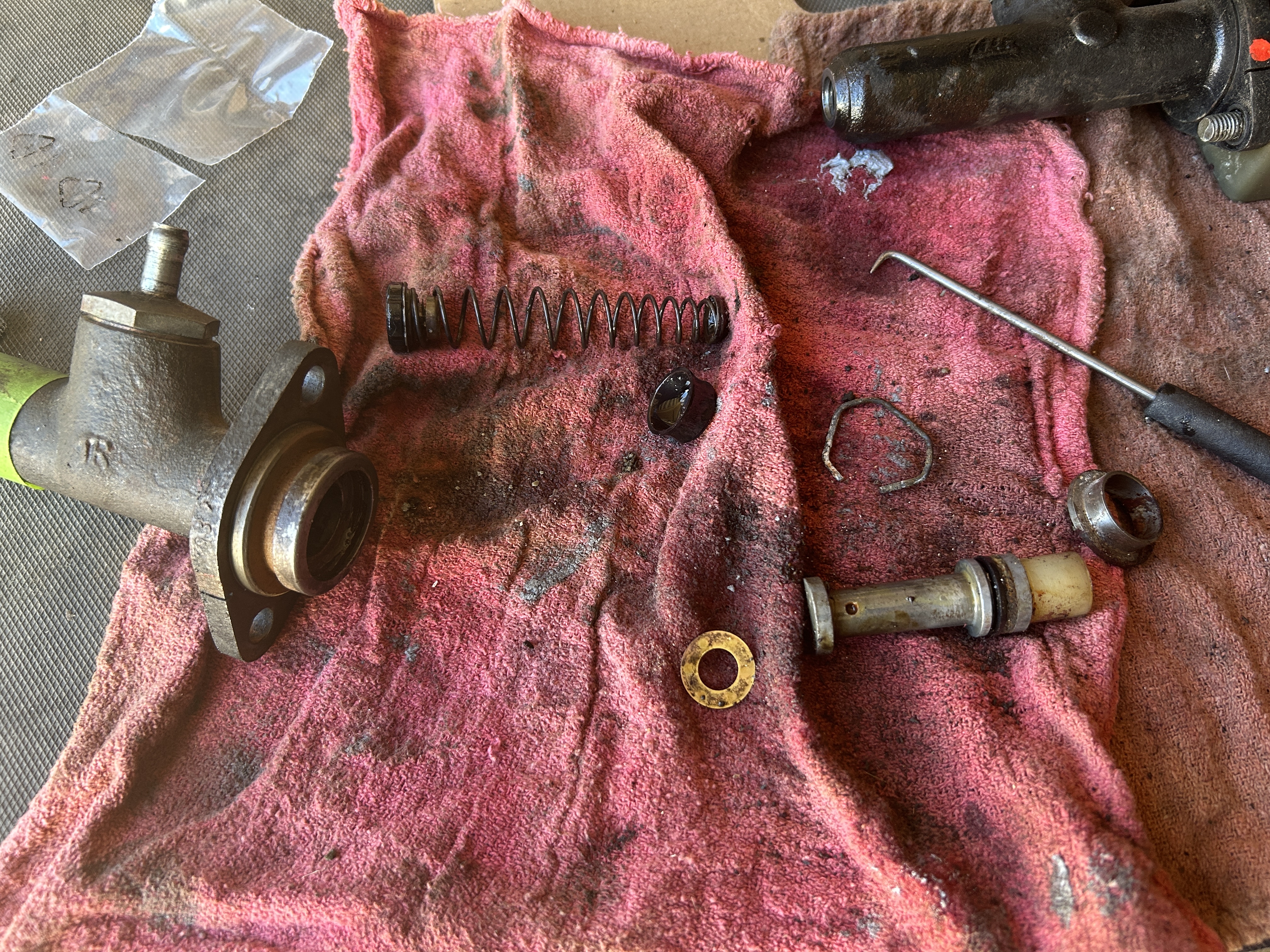

Bled the lockers today and got them all working as they should. Nasty, dark, lumpy fluid all gone, replaced with new DOT 3. Replacement rubber elbows/lines on order.

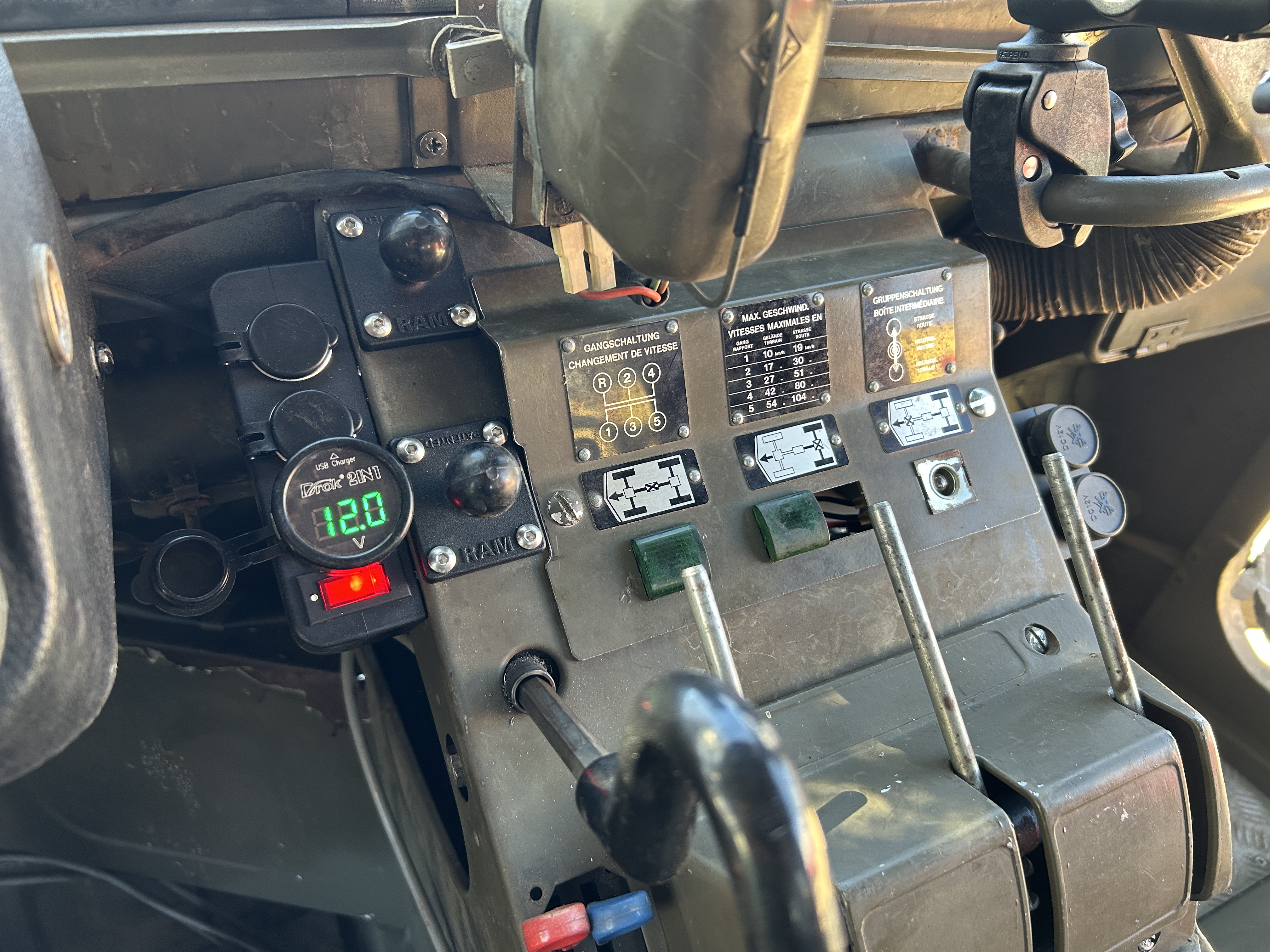

Looking a little more put together. Mounted 2 ram balls for mounting a camera and my gps map display. I need to invest in an I pod mini to display onx offroad. Another clamp on mount is currently holding my GMRS radio. I added a pic from rebuilding the locker cylinders. Surprisingly, they were still working with all the junk inside.

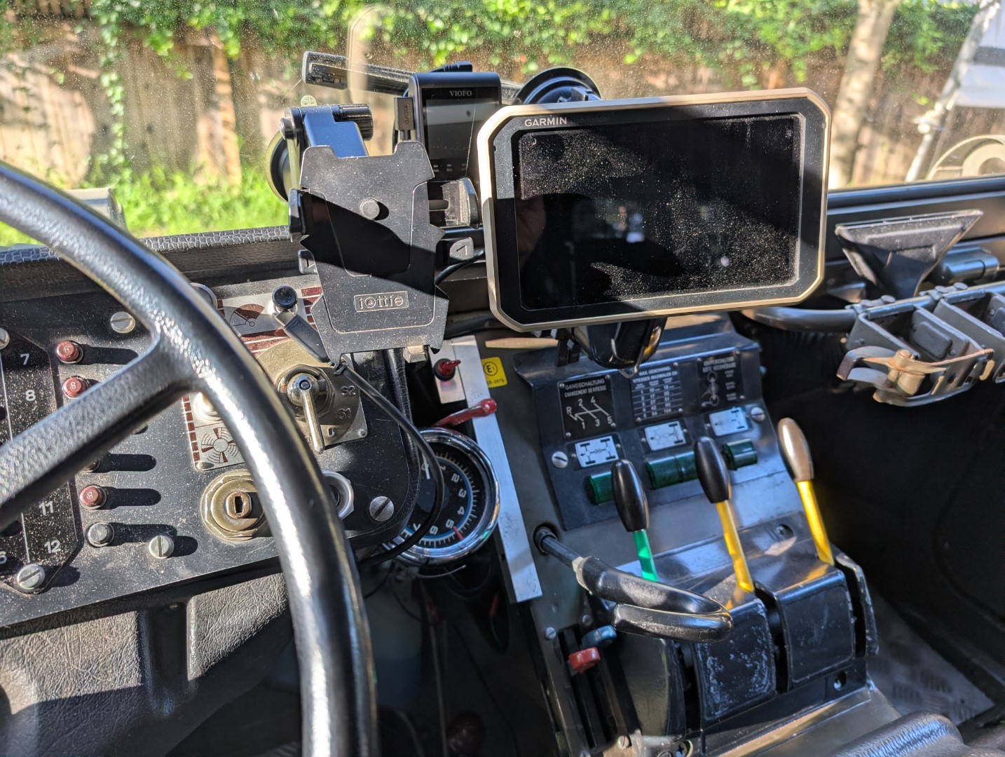

Here's how I set up the phone holder, dashcam, and GPS mount. And tach.
I find keeping things up higher helps with keeping focus outside.
The GPS mount is a suction cup to the windshield, but also secures on top of the wiper motor.
The phone mount is also suction cup to the windshield, but also with a support bracket to the top of the dashboard assembly.

ChickenPinz wrote: Sat Mar 28, 2026 8:14 pm Here's how I set up the phone holder, dashcam, and GPS mount. And tach.
Looks great. I agree, higher is better. I have had mixed results with suction cups. But I still use them on occasion.

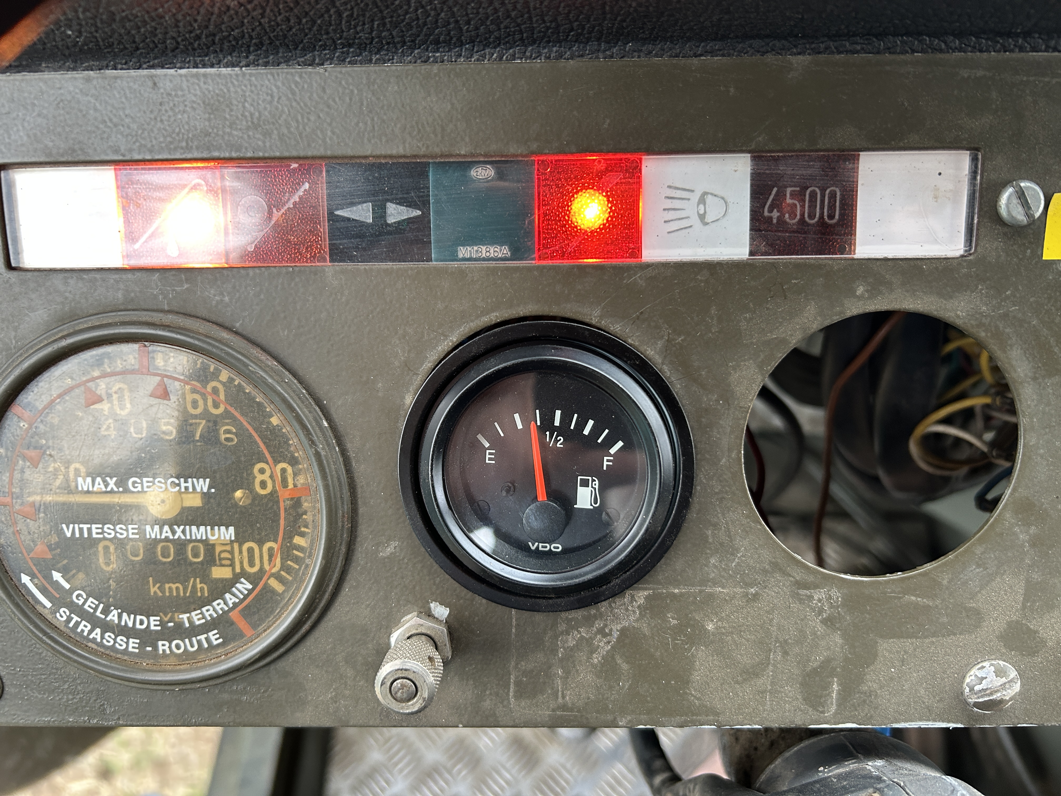

Got the VDO fuel gauge installed and working. I metered in 10 gal of fuel and watched the reading change. I estimate +- 13 to 14 gal of fuel total in the tank at this point. I will fill it up at some point and calibrate the high side. Also removed the old hour meter, not sure if I want an oil temp or just blank it off.
