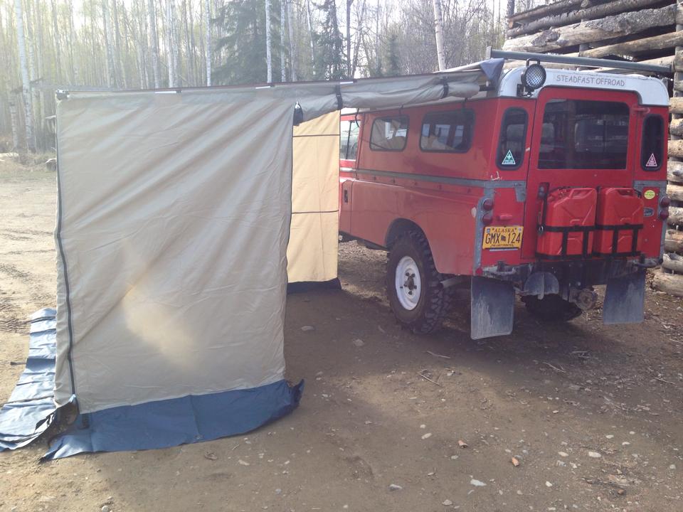

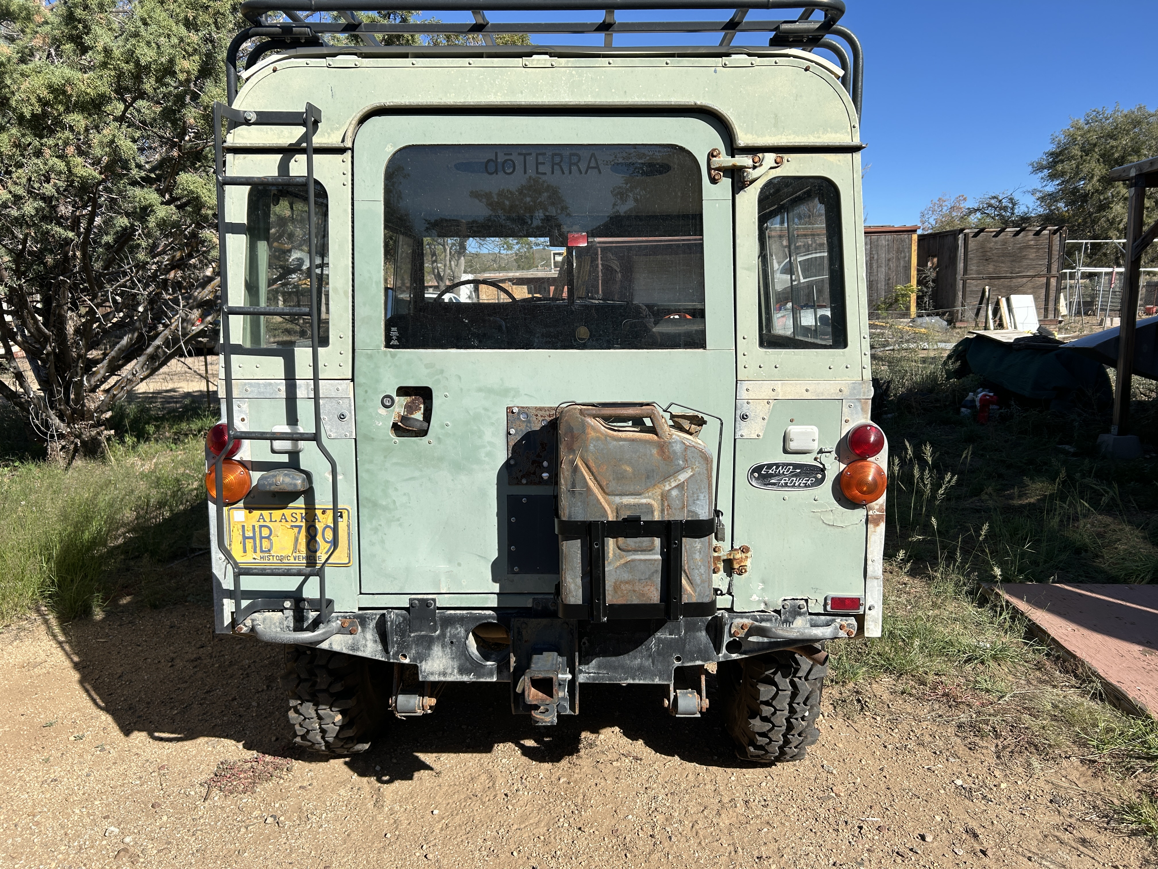

I do agree, spilled fuel is always an issue. I switched to the NATO-style fuel cans up in Alaska, as they work so much better than the US-style cans. They have never leaked a drop in years. I could never get the US style to stop leaking. I have used the basket-style can holders on some Land Rovers. The only issue I have had is the cans swelling up in the sun and jamming in the holders. The cut-down "Jeep" style doesn't have that problem, but they don't hold the can as securely.

Ya, I only use genuine NATO (Wavian) cans as well.
Expansion at altitude can be a pain. I remove the safety pin
and if need be I can pop the top with the can in place to
depressurize so it can be removed.

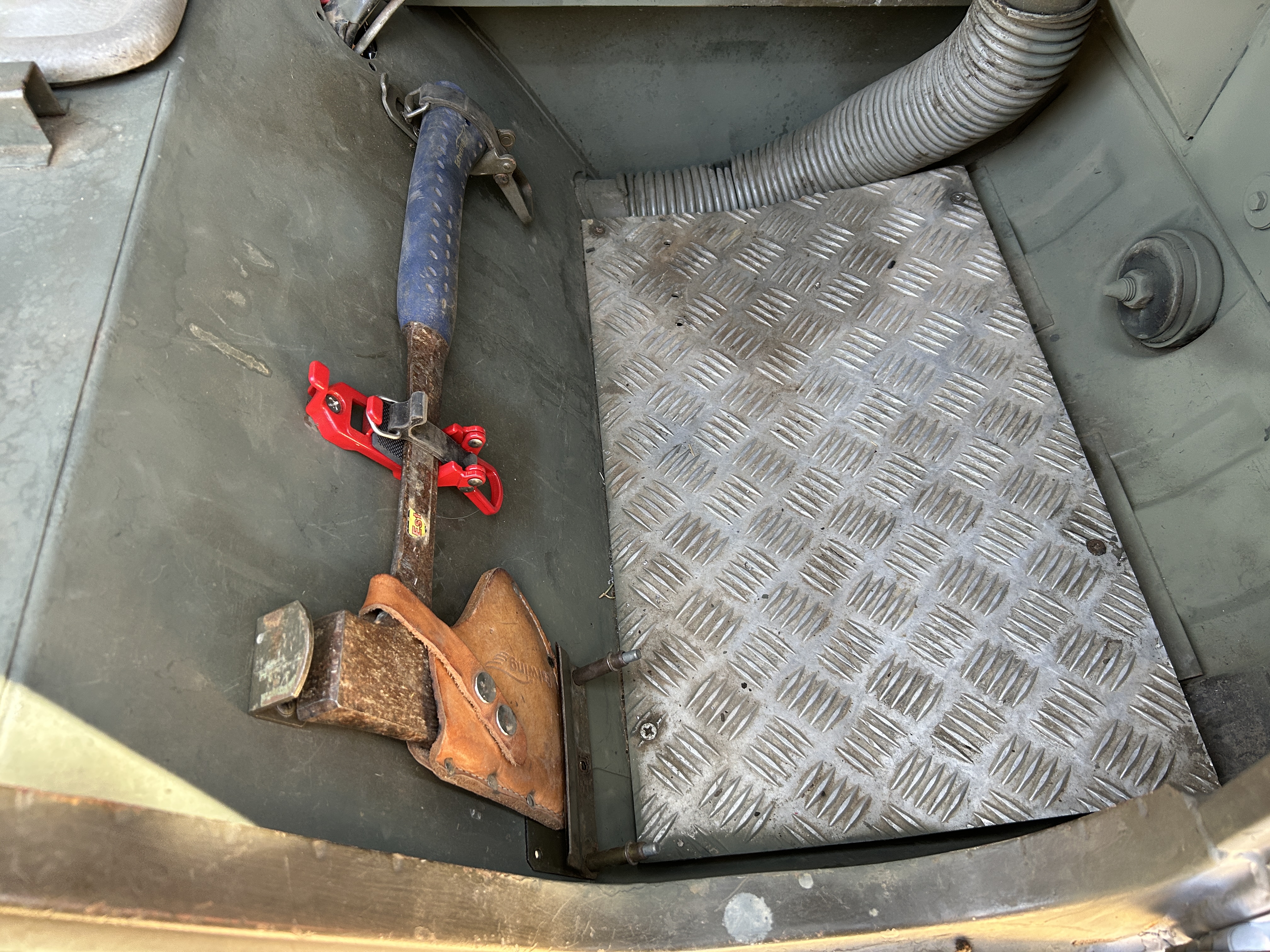

I was able to modify the Pinzgauer Axe mount a little and add a clamp. It now holds my old trusty Estwing hatchet nice and secure in the passenger foot well.
Regards,

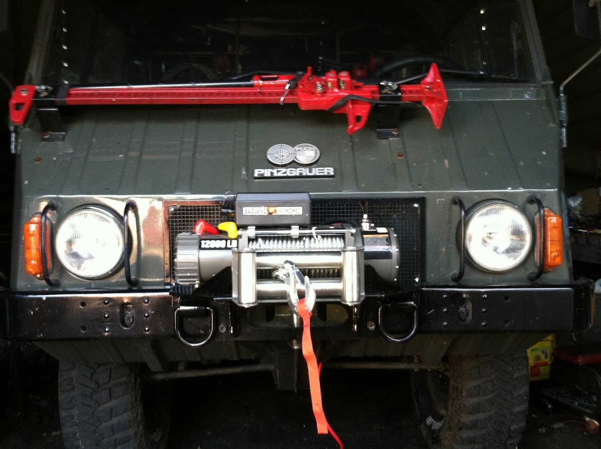

Starting to think about a winch mount. I have seen several that allow retention of the stock bumperettes. Most of the traffic on the site is pretty dated. Unfortunately, I'm late to the party, but who is still making something like this one? (not my photo)
Regards,

Alaskantinbender wrote: Sun Apr 05, 2026 2:45 pm Starting to think about a winch mount. I have seen several that allow retention of the stock bumperettes. Most of the traffic on the site is pretty dated. Unfortunately, I'm late to the party, but who is still making something like this one? (not my photo)
That one was built for me by Andre at Fat Fabrications. I understand that Andre is contending with some health issues at the moment. If he's unable to assist, then I would point you toward 3saurus who is local to me and has access to the design in order to replicate it.
