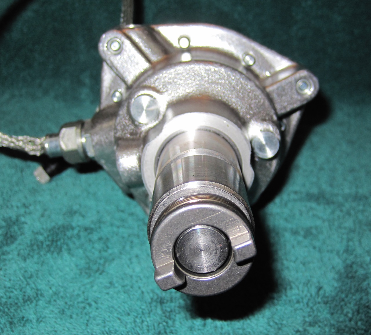

Audiocontr is correct that the cog on the base of the shaft is offset and will only engage one way, however dirt/grime/crud could be interfering with the cog engaging properly. Careful polishing of the walls of the hole followed by cleaning and oiling is definitely a good idea.

Haf-e and pcolette are correct, the cogs have to line up with the engine in order for the module to go all the way in. It can only go in one way correctly.
Turning the Phillips screw in the center of the disc will also tell you if everything went in OK. If the screw won't turn (clockwise), the engine is stopping it, so it is in all the way. Laying the old and new next to each other would be a good idea to verify the possibilty of different shaft lengths keeping parts from mating.
I think the belt is too loose to turn the engine, which is why the disc would occasionally stop while rotating the fan.

Thanks guys for the input. I think everyone was at least partially correct. I left the clamp bolt loose when setting the engine to TDC. I would get the light set and then rotate the engine. What was happening was as I would rotate the engine, the disc would start to turn and then stop. The unit was popping up ever so slightly and at some point the connection between the mated parts was lost. To get to this conclusion, I pulled the unit out again. I checked the old distributor and noted some very slight damage/roughness to the ears on the end of it. So, I carefully cleaned the heck out of the cylinder walls, removed the spring and cleaned the cog at the bottom to make sure I got all of the crap out of the indented pieces. After feeling pretty confident I had it cleaned up well, I re-oiled it all and put the spring back. Before re-installing I confirmed that when I was rotating the engine the indented piece at the bottom of the cylinder was rotating as well. It was, so no issue there. I then re-mounted the SSI Unit and it was seated properly. Then, as I rotated the engine, I saw the disc rotating as well. At the point the disc stopped I noted the bottom of the SSI unit popped up slightly. So, after re-seating it properly I then tightened the pinch clamp to keep the unit from popping up. I set the engine at TDC, got the disc to trigger the red light, then rotated the engine two revolutions and the light was back on. So, the timing was correct according to the manual.

Thanks Ed. You too. It was amazing to me that just a thin layer of oily gook that had accumulated over the years could cause such a problem. After the cylinder walls and shaft were cleaned thoroughly the unit went in and came out much more smoothly. It still is tight; but very manageable now. Cheers and thanks to all for the input.
