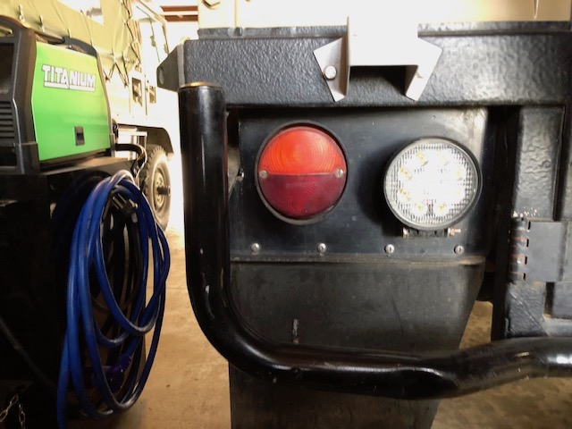

I made a taillight conversion about 8 years ago, sticking with the
stock Taillight housing, adding a dedicated flood backup light,
splitting the functions out separately. The backup flood is very
helpful on the trail for obvious reasons. Pix attached.
Don't ask, long forgot how I re-used the existing wiring harness.
That said I have to figure it out again as the same conversion is
slated for the 712. Though that rig has a long list of to-do's before
that conversion.
