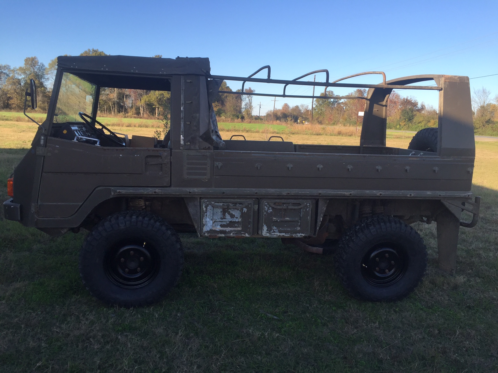

Not yet. I've been covered up on other projects. I did get my wheels all ready. Hopefully I'll get to it soon. Will post pics and results I promise!ImageImage

Great looking aggressive tires. The biggest I could put on were 33" and they did well with no rubbing anywhere.

Tires mounted on rims and rims mounted on Pinz!
Fits great - no rubbing or binding anywhere.
Success! 8)

That looks killer! I may be the next to try this! :)
Let me know down the road (after having it hit few bumps and such) and tell me if you encounter rubbing.
If possible, could you get the steering full lock in one direction and snap a pic of what kind of clearance you have? I'd greatly appreciate it!
