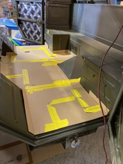

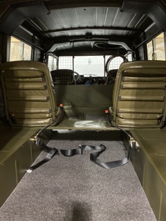

I used a product called "BedRug". it is a synthetic carpet product with about 3/4" of foam padding sold as custom truck bed inserts. However, the company sells, or sold, the sheet good product in 10ft lengths. I just made my own pattern. It can easily be removed for inspection of the floor or drying if wet. I will attempt to upload pics.

Very nice. I did a K that looked kinda like that, although I went over the wheel wells too. Made a nice difference.
