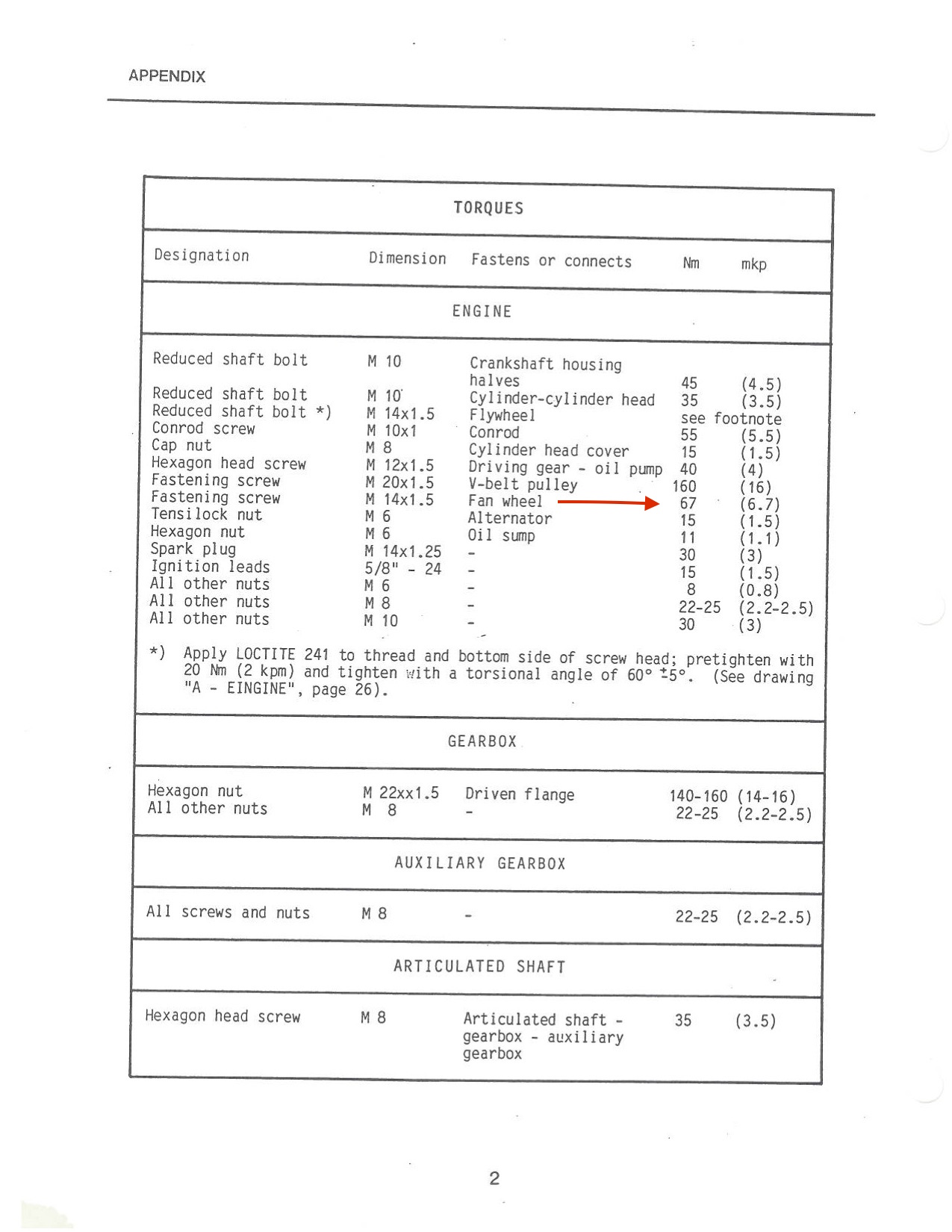

You set to the belt to the factory recommended torque and the alternator shaft threads stripped? Can you confirm the torque that you used?
Thank you.

67 N•m.
I'm thinking the threads were likely damaged when I acquired the truck. All good now with a new armature shaft & retaining nut (and a bit of blue loctite)

Wow 67 nm is just under 50ftlbs. I am looking at the torque specs in the Service Manual annex and it says 6.7 nm which is about 5 ft lbs. :shock:
I am not giving you a hard time and I think you may have miss-typed. I recently did a belt change and that just felt too loose to me. My inclination was to keep tightening! Thats why your post caught my eye.

According to my Appendix, 67 Nm is correct for the fan bolt:

Paul - Thanks for the correction - I was in the wrong column.
