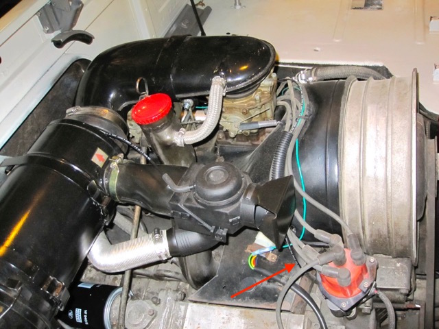

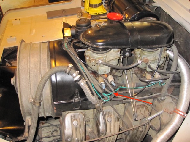

Here are a couple of photos to help out. The red arrows indicate the vacuum line. Note that the rubber elbow in the line at the distibutor contains a small ball that acts as a restrictor so not too much vacuum is drawn thru the distributor. A distributor vent kit is available with part #7101095080 that contains the line, elbows and restrictor.
- IMG_0567.jpg (109.65 KiB) Viewed 13604 times
- IMG_0578.jpg (112.45 KiB) Viewed 13604 times

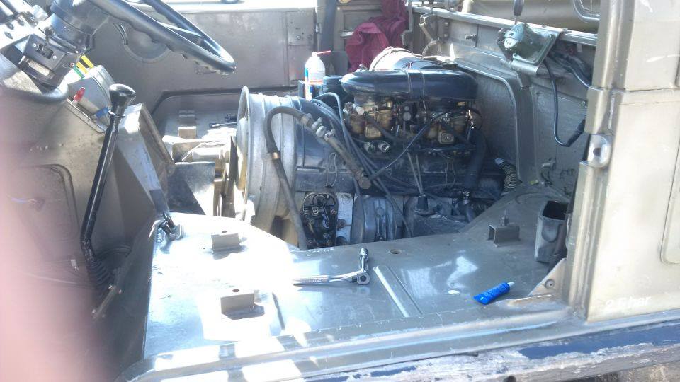

Wow, so mine is different.... I have a picture from when I was checking valves... Any chance that vacuum line was deleted in the Austrian version??
- 12074536_10153236107596314_854057499151353708_n.jpg (70.26 KiB) Viewed 13597 times

It's very possible the Austrian version didn't use the vented distributor. A NOS late model distribtor I purchased a couple of years ago did not have the vent fitting.

By the way, on the last picture in the post, I see the vacuum line to the brake, and another going to the back of the engine. In my truck that is the one going to the distributor. Where is that vacuum line going in that truck??

That vacuum line heading towards the rear of the engine connects to a valve in the air intake and then over to the air horn. This was the later revision from Styer to use warmed air from the heat exchanger. The valve in the air intake is temp controlled to open and close the air horn intake via vacuum. This was a kit at SAV (part # 7121195019)
https://www.pinzgauer.com/showdetails.p ... 7121195019 that I've installed on both my 710Ms to improve cold weather functionality. It's not a magic charm but does work.
