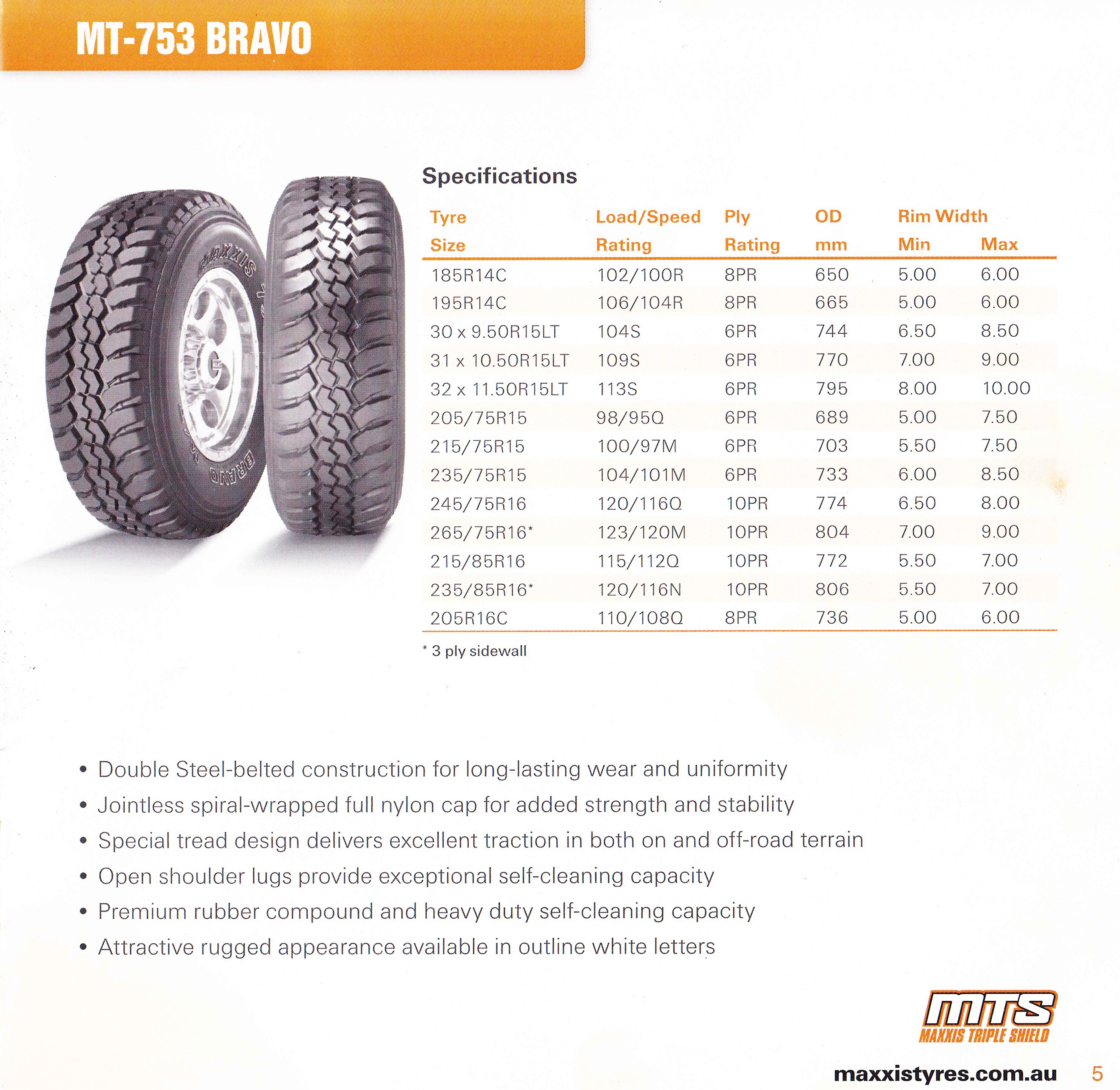

Hmmm - I did a search for Maxxis MT 753 Bravo 185r14c site:us on US sites and also came up with a blank but there are plenty of hits on the Aussie site. The 185 wide version on a 14" rim fits on a Haflinger no issues.
This is out of the Maxxix Brochure
The Maxxix MT - 754 Buckshot Mudder is available in the US but it is 27x8.5R14 but I think this might be just a bit too big in diameter for a Haffie.
