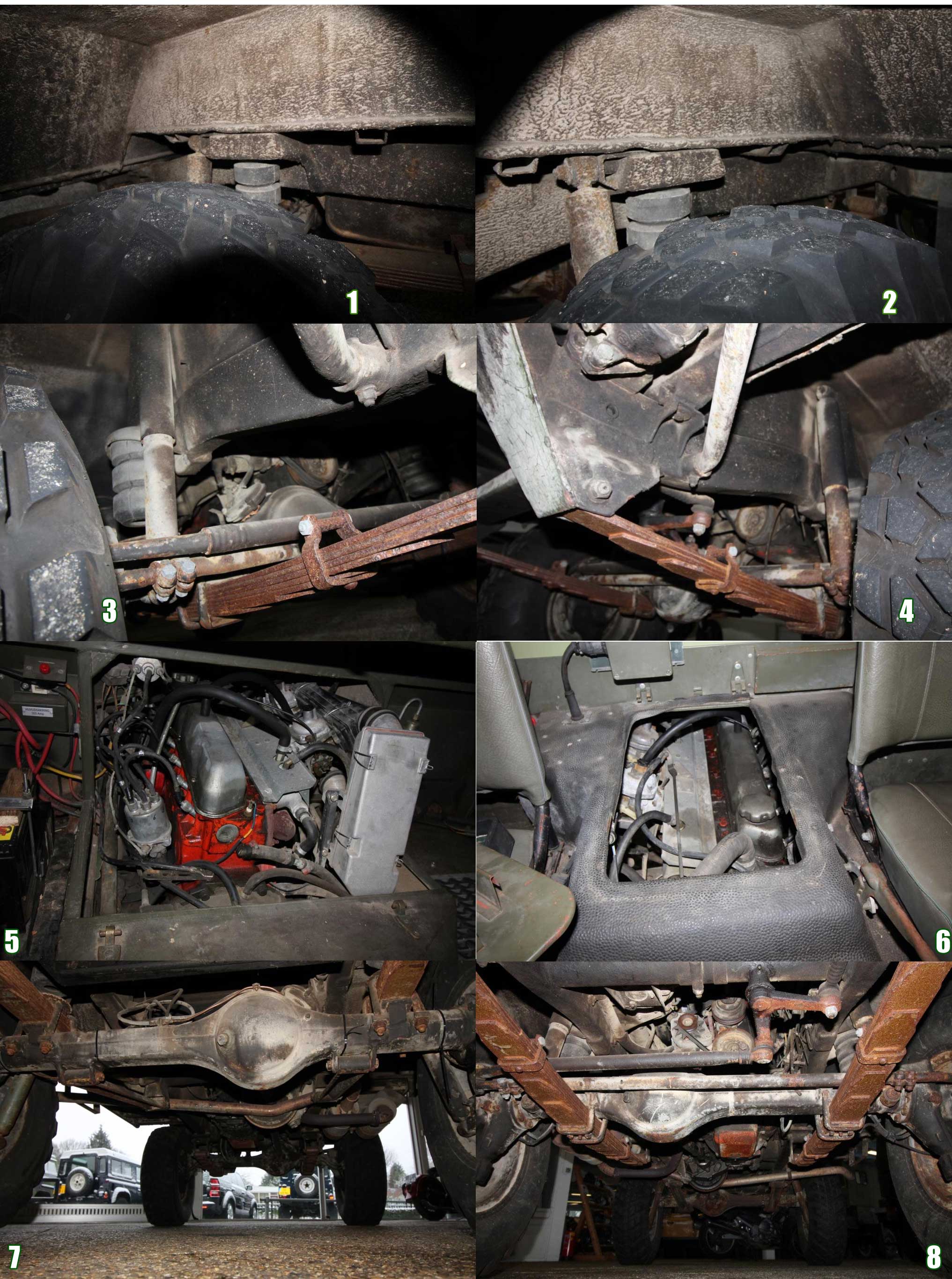

I threw together a montage of all the under-neath shots, and then did screen grabs of the front left and back right to provide more data.
I made the montage so as not to take up so much bandwidth for the site. Apologies in advance!
So, as I said, most of the rust looks superficial on the underside components, and not body related. That might be a really rusty oil pan(?) ,8 that could be cleaned up but might need replacing. I see some controller arm, perhaps steering related - images 4,8 - that has some rust as well on the end. The bolts look newish. Hubs look to have some superficial rust as well.
Engine (5,6) looks like it could use a steam cleaning. While not apparently leaking, it looks "damp" enough to maybe consider a head gasket if it has dried out over 40 years, I don't know how these vehicle wear. There is a maintenance log. I am positive it is not in English.
Leaf springs - images 3,4, 7,8, - rusty and look a bit nasty. Would want to replace. Same with the shocks. I am hoping some of these elements are standard size, or perhaps have cousins in other vehicles.
I also see wire ties (?!) going across the rear axel/dif (7) and don't know what that's about. Also what might be a new brake line (its shiny) arcing up over the top.
Any thoughts appreciated!
[img]
This is the montage.
[/img]

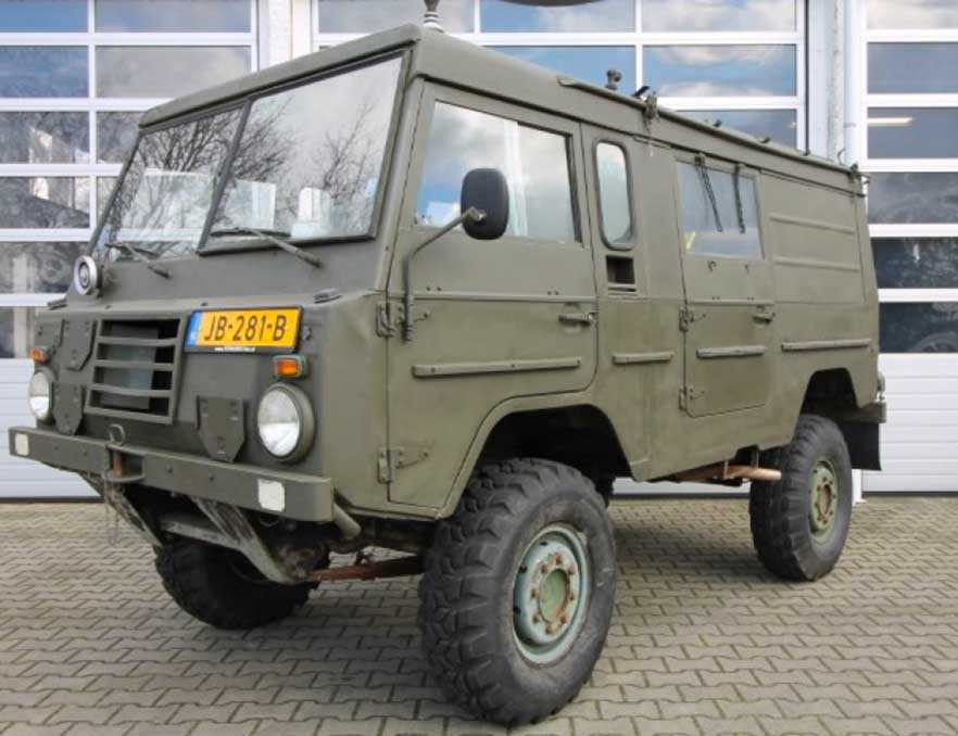

[img]
Front left
Front left
[/img]

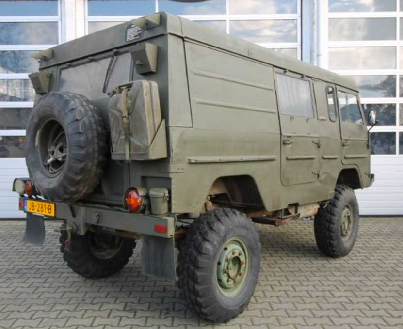

Back right
Back right

...front springs are little bit to low. They need some work to bring them back in shape an a new paint and grease.
It has the seldom and expensive 3 piece manifold with the watercooled aloy intake.
TH also offers a alu/zinc C303, just 1700€ more. But here the front springs are dead.
But you don´t need much work on the body, only new paintjob.
Anyway, on both cars you need a minimum of 3-5K€ (Parts) + time to fix the technical problems you will have. So far my experiences working now on the second Volvo I have.

Those pics aren't really what you need to see. It can't be said enough that rust in the wrong places on these can turn a $12K truck into a $3K truck instantly. He needs to take the cover off the fuses, use a flash and take pics so you can see the windshield frame as much as possible. The rubber trim is easy to lift up to get pics of the floor area... the extreme lower rear corners- Bottom of the doors- Under the seats- the floor around the back seat brackets.
Shocks are easy to find, new springs are not.

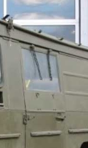

Are those wipers on the side windows?
Volvo C303 Side Wipers.jpg (28.91 KiB) Viewed 8712 times

Post by one2many »
Not wipers but rubber straps for holding the "black out" board over the window so that sniper in the distance doesn't spot you.
Although some do still have headlight wipers.
