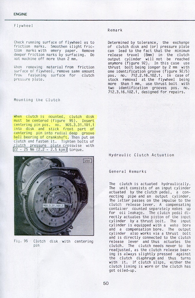

Just another point...
I just read in Pinzgauer technical old (july 16, 2006) at 'Clutch problem:
M. Wehrman: "When I replaced the clutch in my K I used the pilot tool that came with the Auto-zone kit,only thing I had to do is wrap the end with a few turns of aluminum tape to match the Pinz pilot brng. EZY!! Mark"
Jim LaGuardia:"For an alignment tool , the splines are the same as GM 10 spline , MBZ(early 4sp),BMW 733i, or Toyota Landcruiser(60's to late 70's)"
Buzz: "On the tools, I actually own an original Swiss clutch disc centering pin. It came in a case of Swiss shop tools that I bought with my truck three years ago..."
Manual: see attched; yellowed out.
If I pull off the clutch disk, in order to pry off the clutch-disk from the flywheel and later on re-assemble; do I need a centering tool as mentioned above and as in the manual ?
In all the other posts about taking off the clutch-disk, it never mentions this, so that is why I thought it was easy with just simple tools... Probably I need to buy this part
I can just imagine if that disk was not mounted properly, even though it fits to the nut-bolts and holes when bolting back on, it would wobble and not be too good at high rpm (or any rpm)
Appreciate your comments
Best regards,
Jules

Hi Jules,
Yes, there are three manuals: Parts, Repair, and Operators, if I recall correctly. The picture you posted leads me to believe that you have them in digital form.
Yes, you do need the clutch alignment tool to reassemble the clutch disc in the proper location to allow the transmission shaft to slide through. I have the actual input shaft from a destroyed transmission that I use. As M Wehrman has written, some alignment tools may fit the clutch splines but still be too small to fit the pilot bearing, and sometimes wrapping it with tape will give a good enough fit to work. Jim LaGuardia identified some vehicles that have the same spline setup, and I'd think that you could purchase the alignment tool for one of them from a local parts supplier.
If you do not align the clutch disc as you assemble things, the transmission input shaft will not be able to slide through the clutch disc and into the pilot bearing, so you will be unable to install the transmission like this.

Hi Jules, so the process goes like this:
Remove the tranny cover plate from the bed of the truck body.
Remove the clutch cover plate, and pull the link pin (between the slave cylinder and the clutch fork) out by hand. Leave the clutch slave in place. Remove the shifter linkage.
Remove the driveshaft from the end of the tranny. Best if you mark the alignment of the end of the shaft and tranny, also mark the two halves of the shaft so they can go back together in the same orientation.
Remove the bellhousing bolts and pull the tranny backwards about 8-10cm and then lower it.
Now you see the pressure plate bolted to the flywheel, with the clutch disk squeezed between them (squeezed by the springs of the pressure plate). Before you remove the pressure plate from the flywheel, look into the center where the tranny shaft fits. You can see that the clutch disk splines are centered around the pilot bearing hole. This is what you will need to re-align by using the alignment tool. Remove the pressure plate bolts and it and the clutch plate should come loose, except that in your case the clutch plate is stuck to either the pressure plate or the flywheel. In either case, carefully pry the stuck surfaces apart. The pressure plate and flywheel area that contact the clutch disk should be cleaned of any rust (and any cleaning solvents).
If the clutch disk seems to have enough "meat" of wear surface then it can probably go back in the truck. If the pressure plate has any big scratches or spring fingers that are not even with the rest then it should be replaced. As easy as it is to remove the tranny to get to the clutch, it is even easier to NOT have to do it again. Parts are not that expensive, so it is common to just replace all: Pressure plate, Clutch disk, Throw-out bearing (on the fork arms), and Pilot bearing (in the center of the flywheel) so as to not have to do this process again any time soon.
Replacement is almost the reverse:
First, put the clutch disk on the inside of the pressure plate and put the alignment tool through the back of the pressure plate and through the clutch disk splines. As you put this assembly up against the flywheel, get the alignment tool centered in the pilot bearing. Then tighten all the pressure plate to flywheel bolts which will clamp the clutch disk. It will be centered because of the alignment tool (I have heard of people using a piece of broom stick handle when nothing else was available). Pull the alignment tool from the assembly and re-mount the tranny and the rest of the linkages.
Done!
