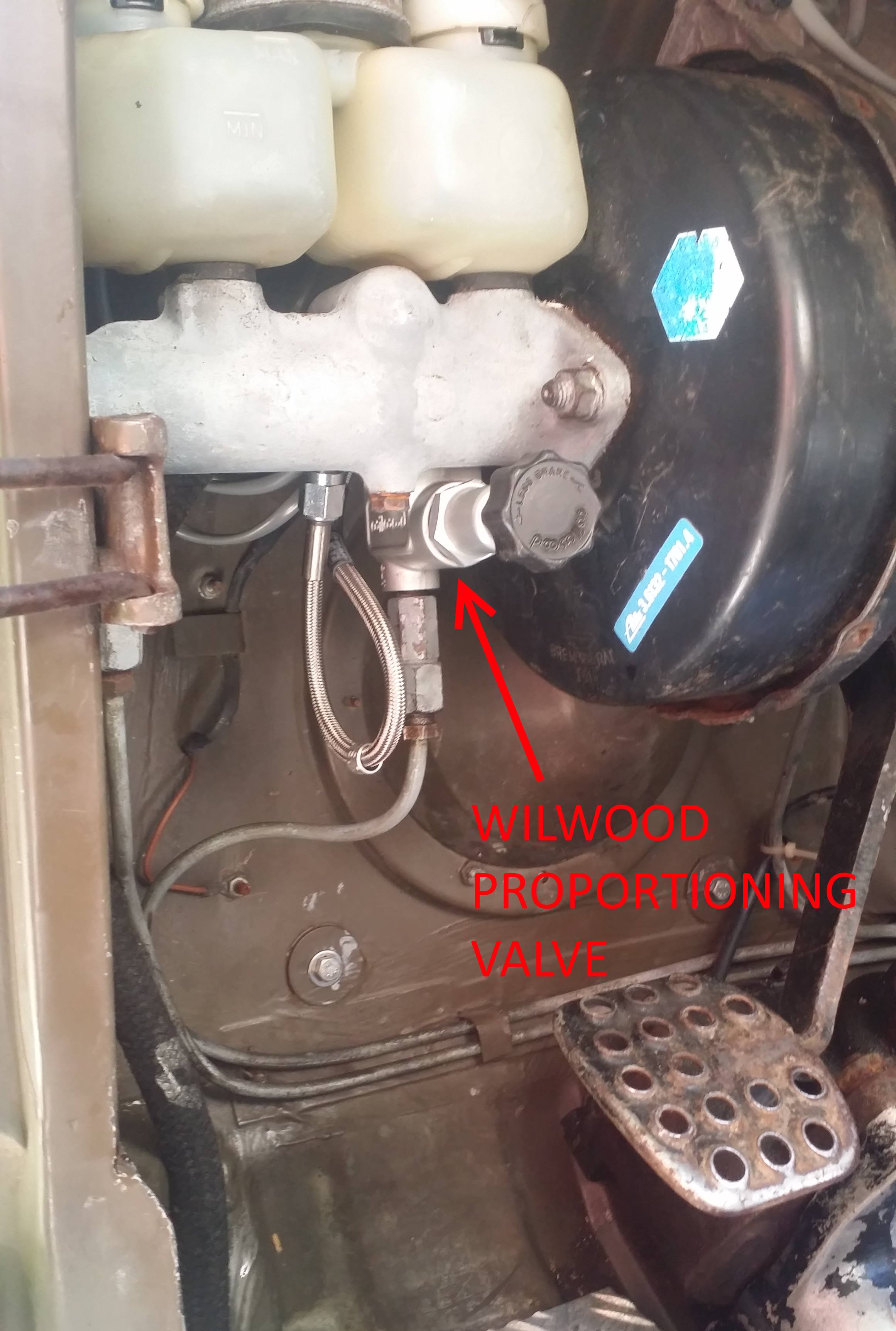

Here is a photo of the proportioning valve installed. It is working well. I can lock up the front brakes on without locking the rear brakes on the lowest setting. Will need to test it more on a variety of conditions to figure out the best settings.
I used a version which Wilwood offers with m10 bubble flares - that makes the plumbing much easier since that is what the master cylinder actually uses. I used a SS flex line to go from the master to the valve but a hard line would also work. The existing brake line was bent a bit to allow connection of the valve using the original adapters with the residual pressure valve removed. Pretty easy install. Need to still fab a bracket to prevent vibration damage.

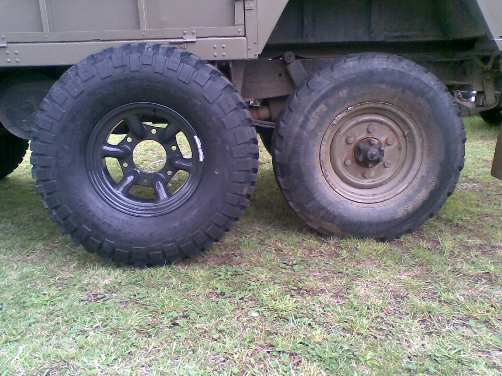

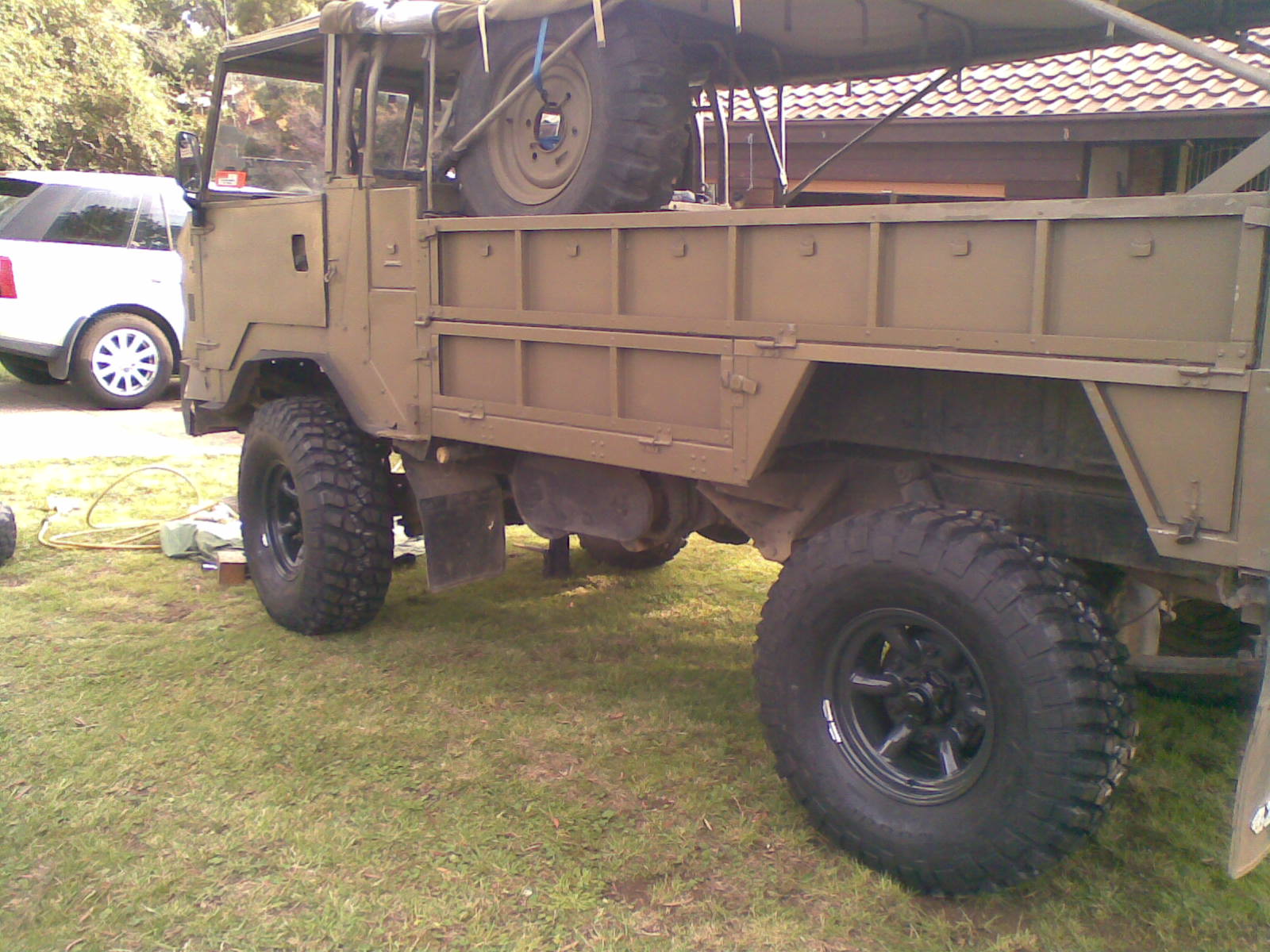

Thats odd as I have Mach 5 rims have normal rims not those round rims.
But while the company that made the rims are still in business - I believe in another form, I had heard that they no longer make the Mach 5 rims though Landrover parts sellers like Paddocks in the UK are still selling them (and getting them made) http://www.paddockspares.com/land-rover ... lloys.html but probably not a lot of use for a Pinz but does highlight they are still being made somewhere. So maybe Mach 5 wheels with a normal style rim could be found.
Here is a pic of my 101 with them on and you can see the shiny weights. The 101 does not have a LR stud pattern but has the Nato 6 stud pattern common to smaller older Mogs.
Garry
