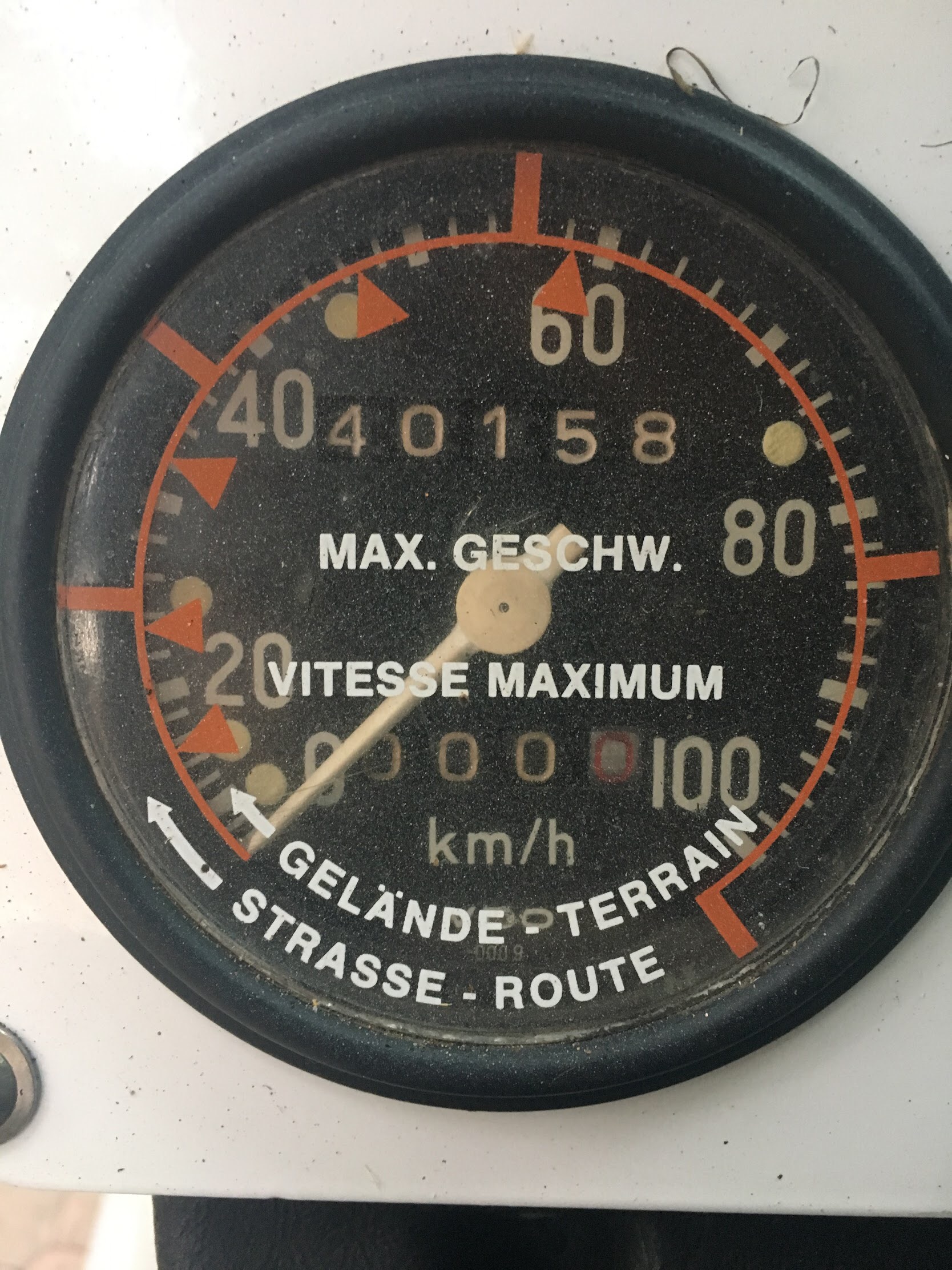

Also, the speedo only reads up to 70 km/h.
Here are a couple pics (looks stock to my untrained eye).
70 km/h speedo? Most I've seen indicated (were marked for) up to 100 or 120 km/h, any chance your speedo face has been changed out for a mpg face? Have you verified the speeds you are indicating with a gps?

Here is a pic of the speedo
Re: Converting Low Speed Transmission To Taller Gearing?
Posted: Sat Feb 10, 2018 8:35 am
That has to be a mph speedo no?
The orange speed pointers almost match up (within a few mph compared to kph)

The speedo's on these trucks often are in need of refurbishment and/or are out of calibration. Many owners convert to electronic speedos or just use a GPS. Many of the Garmin units (not all) are 24v friendly.

TechMOGogy wrote:That has to be a mph speedo no?
Here is mine
It says kp/h, but it has the 90* cable adapter on the back so it's probably not accurate
Probably going to go GPS as Ed suggested.
