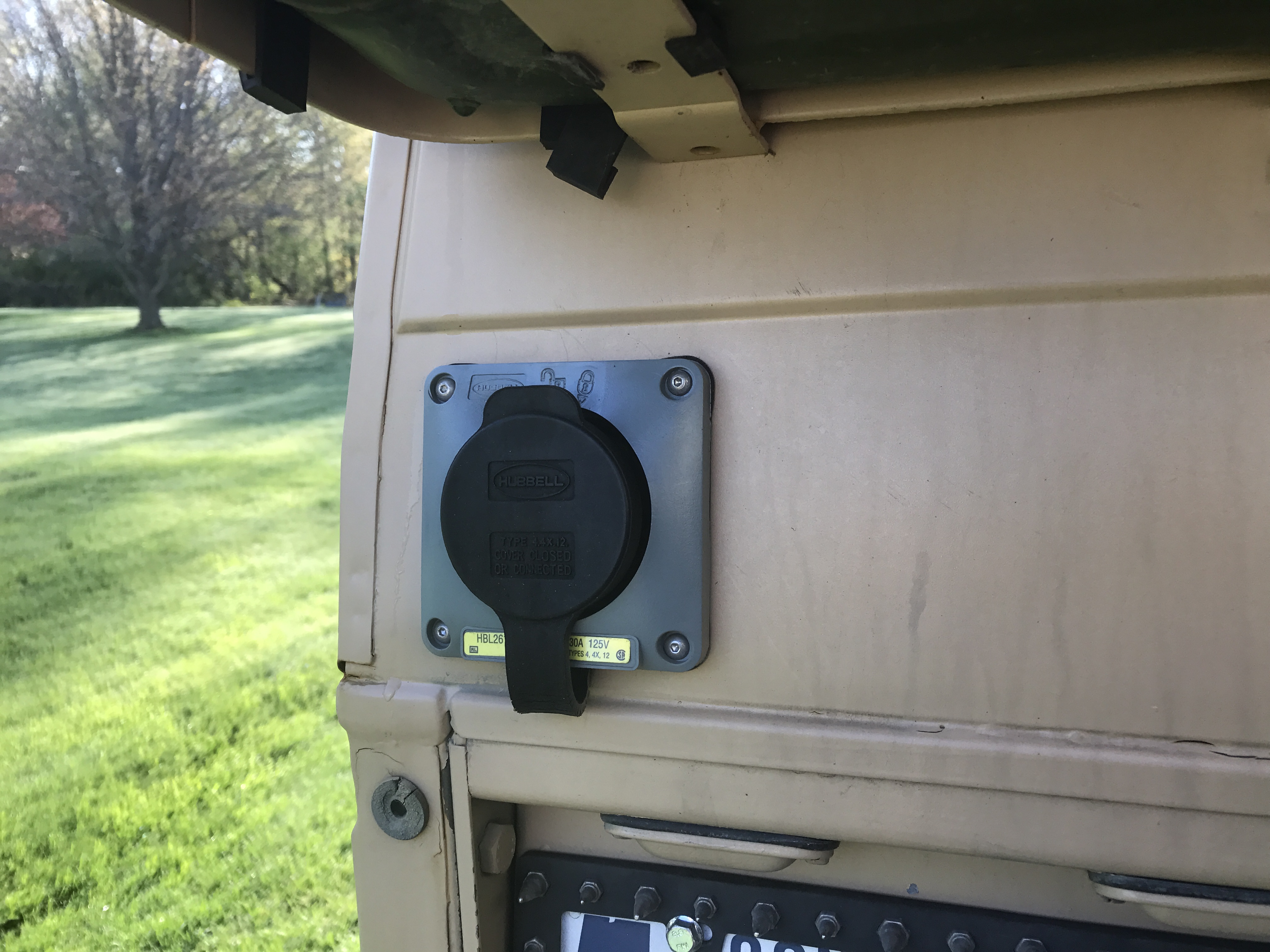

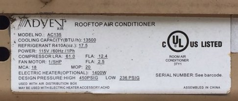

Hey there,
This is an Advent AC135 AC unit. Its a 13500BTU init that runs on 115v shore power.
It requires 3000 watts at 15amps.
It cools fairly well. It also has an optional heating coil- so I can use electric heat for those cooler nights.
I have it tied into a shore power plug on the back. I also have a power strip for other items and a battery charger/conditioner so I can use any of the 12v/24v accessories without draining the battery.
What kind of generator are you getting? I'v always wanted to get this AC running 'off the grid' but haven't found a practical way of dong it. The stock alternator isn't powerful enough to drive it through an inverter.
