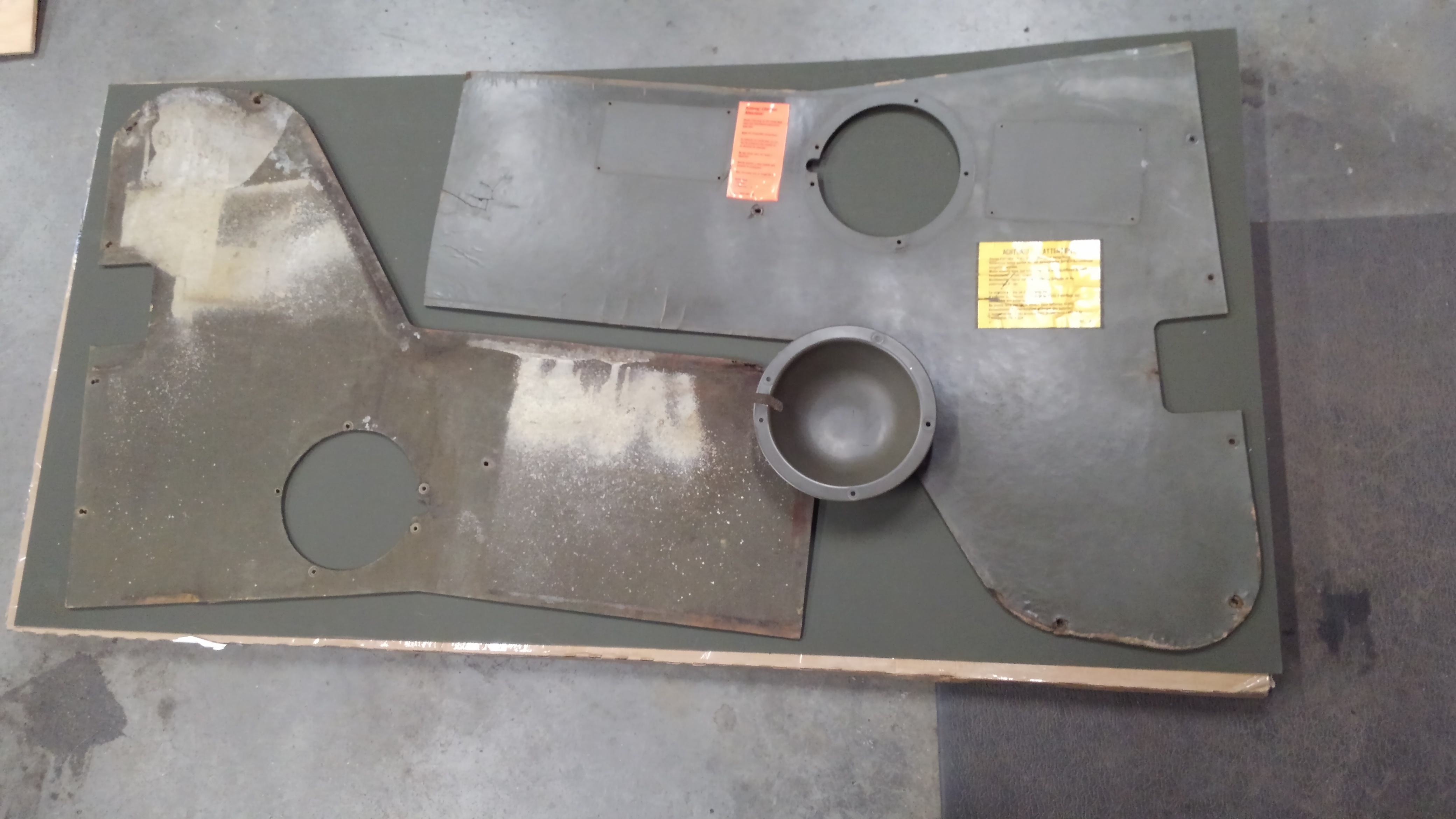

I'm about to tackle new panels on my 710 and realized a 2'x4' piece of Kydex is the way to go. If you flip one panel upsidedown, they nest together nicely with little waste. The OD green isn't quite as brown as the original color (shown with handle pocket) but close enough for me.
33 bucks or so from Knifekits.com. No affiliation, it just came up with a quick Google search. Lots of options and timely shipping.

Well, I confused myself with my own excitement!
It turns out you can't get both a right and left out of one 2x4' sheet, but you can get two of one side, be it two rights or two lefts.
I ordered two full sheets, so I've got enough material to make another R & L set. If anyone wants some diy panels, LMK!
