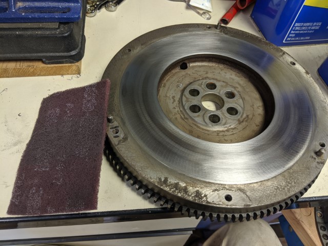

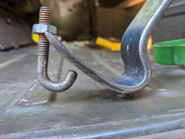

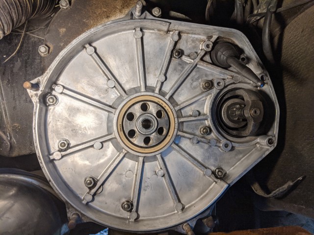

This was my first time removing the transmission, clutch, and flywheel on a Pinz, and I wanted to share a few thoughts from an experienced mechanic but one new-ish to the Pinz. Much of these bits of advice and observations have been echoed by others before me:

- Clean up (de-glaze) the flywheel surface with a red 3M pad.
- Pulling the pilot bearing out of the crankshaft was easy with a J-hook bolt and a Vaughn Superbar. To replace, just tap in gently with a large socket as the flywheel installation will push it into place later.
- I just left the slave cylinder push rod float -- it never got on the way and I didn't pull it out of the boot.
- Give that starter drive a little lube while things are open.
