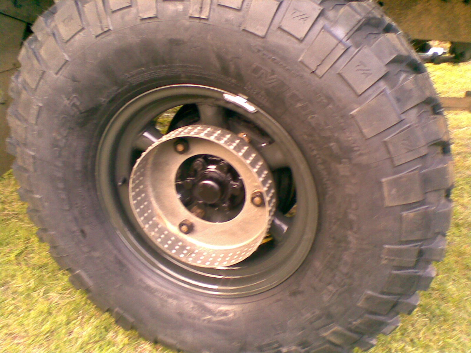

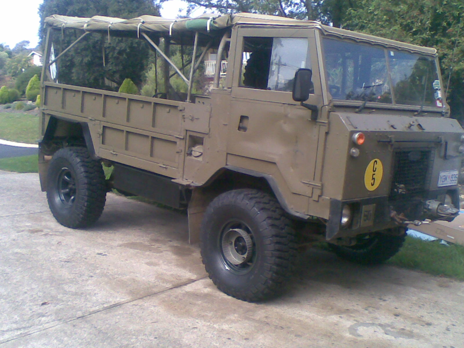

To me those things dont even belong on a pinzgauer and where ever availble on them from the factory...the only truck that had these was the 404 Mog......i just dont like them :roll:
Re: front wheel hub steps
Posted: Sun Dec 24, 2023 10:08 am
by Mr Zero
Joeri wrote: Sun Dec 24, 2023 3:00 am To me those things dont even belong on a pinzgauer and where ever availble on them from the factory...the only truck that had these was the 404 Mog......i just dont like them :roll:
Honest question, do you drive your Pinzgauer regularly? I don't know how the hub step wasn't a factory configuration. It's a much better step position and doesn't compromise the approach angle like the body-mounted steps fitted to some Pinzgauers.
Posted: Sun Dec 24, 2023 11:35 am
by Joeri
Well i own a 716k and have the original steps that are normaly mounted on the pinzgauer. They look alot like these and i had never problems with approach angles.... even when i puch them trough the mud or ground , they keep up verry well.

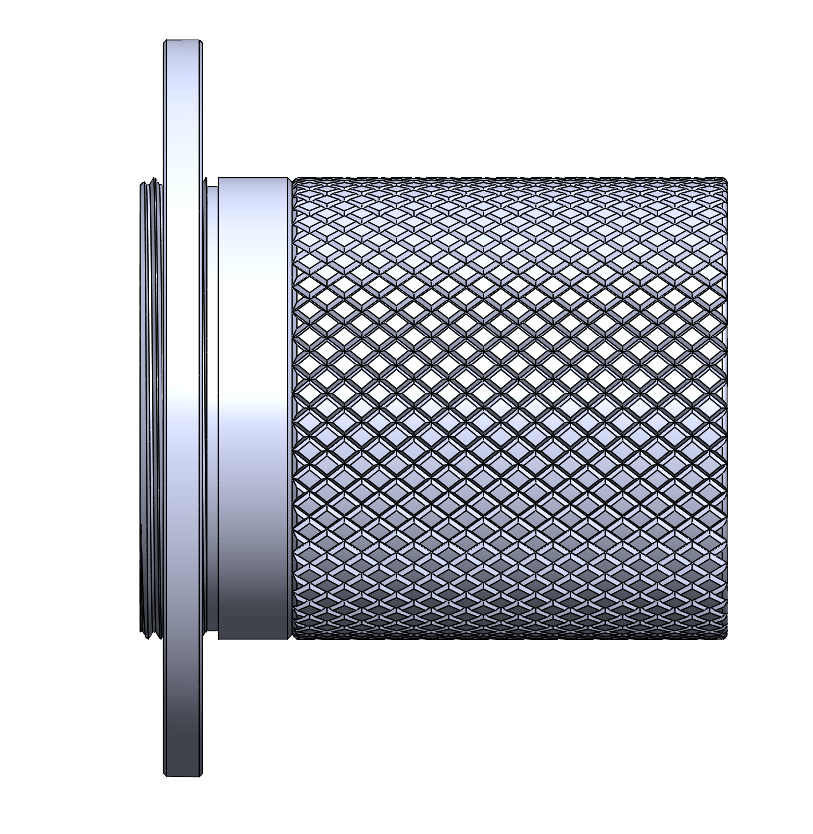

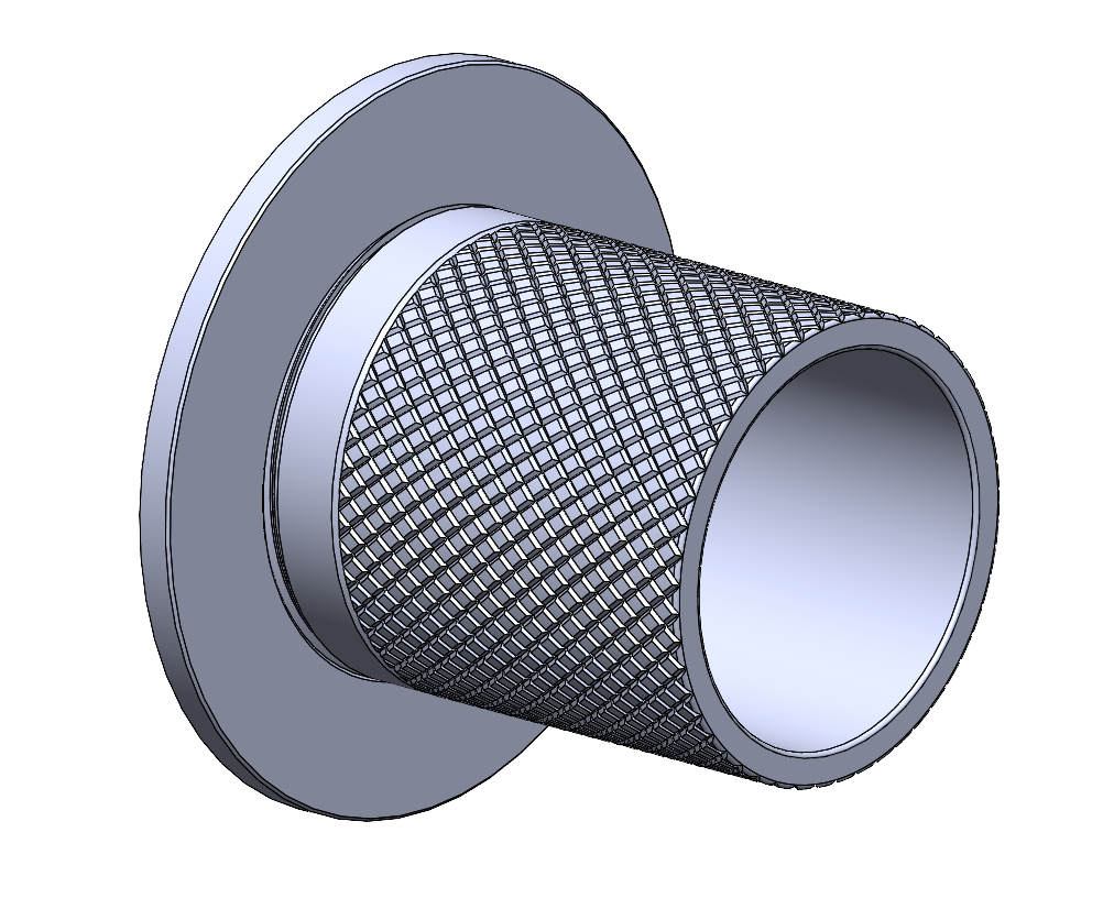

If you can just get a idea of what the flange part should be thickness and OD and the OD of the step portion I will draw something up.
Posted: Sat Dec 30, 2023 6:37 pm
by RPinAZ
I ended up building me own. Here's the dimensions I used. The flange is just less than the gap between the wheel and the brake housing so that it won't interfere with wheel mounting. The set screw keeps it from rattling once installed. There's nothing magic about the wall thickness on the step itself - mine was based on some scrap I had lying around.

Here is my idea based on your dimensions. The two piece design keeps the price down and makes it so they are slightly adjustable to take out any play. I know that the main issue going this route is they could come lose but with some red loctite and the friction between the threads and the face against the hub I do not think it would be a issue.

This looks great to me.
I'm in.
How much would you charge me for it? I would like to buy 2 sets, for all 4 wheels.
Also, do we need some form of rubber pad between the hub step an the wheel, to eliminate rubbing of aluminum against metal?
Posted: Wed Jan 03, 2024 11:18 am
by compunerdy
Do you mean for the flange or where the center piece butts up against the hub or both? Since you can lock it tight I am not sure how much it would move and rub really.. The center piece would rub as its tightened but not sure after that but I wouldn't think the center of the rim would flex much if at all??
Posted: Wed Jan 03, 2024 11:54 am
by euronash
I would like to eliminate any rubbing against the wheel (if I can help it), be it flange or center piece.
Maybe some sponge tape could help achieve that.
I also think the center of the rim won't flex at all.
Please let me know the price and how soon you can have them ready.
Many thanks!!
Posted: Fri Jan 12, 2024 2:30 pm
by compunerdy
Been a bit busy around here but will try and work on that when I can.
