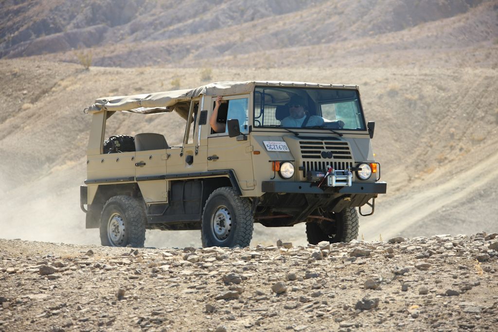

Air shocks adjust valving of the shock absorber to adjust the ride control the the vehicle to the load is carrying. I used these to control the ride quality of HD pickup trucks from empty to a heavier load, such as a slide-in camper. They do not make any difference to the ride height, but do control the dampening rate of the shock absorbers .
On the other side, air springs primary function is to control ride level. In light duty pickup, spring are usually best from the factory for a smooth ride and a heavy load ( within the truck's legal load limit) will sag the rear end and throw the head lamps way out of adjustment. I had a mid sized pickup that I added air Springs to retain the original ride height and retain the shock absorber original dampening.
The 716 is no different in function, the air springs are there to maintain ride height. It is fully automatic. There is a control switch to monitor the rear axle height and signals the air compressor under the glove box to add air to the (air)spring when the rear end sags and to release air when it is too high. As anyone can see above, the only difference in rear suspension between the 710 and 716 is the substitution of the air spring for the second coil spring. This also raised the gross vehicle weight to that of a 712. The only concession I would make to shock absorber, is that it is built into the air spring but isn't controlled by air.
My 716 was a Swedish municipal truck and grossly overload. The front springs were not shock, nor the cup pin, PLUS had another 19mm (3/4") extension to the pin. The rear also had HD springs in the rear and rotten air hoses rendering the air system useless. I never did determine which spring they were, but in the 10 years I owned the truck, the compressor only turned on twice when the truck had a load and hit a dip in the road. When the springs settled after rebound, the compressor turned off. I wish I knew the spring combination it had since it is far better than the manually controlled compressor some are being converted to when the system fails. Somewhat comparable to what people do with the Range Rover air system.
This is how my truck sat on just the coil springs, without any alteration to the suspension other than what the Swedish had done. I removed the hardtop to make a 716K into a 716KM
