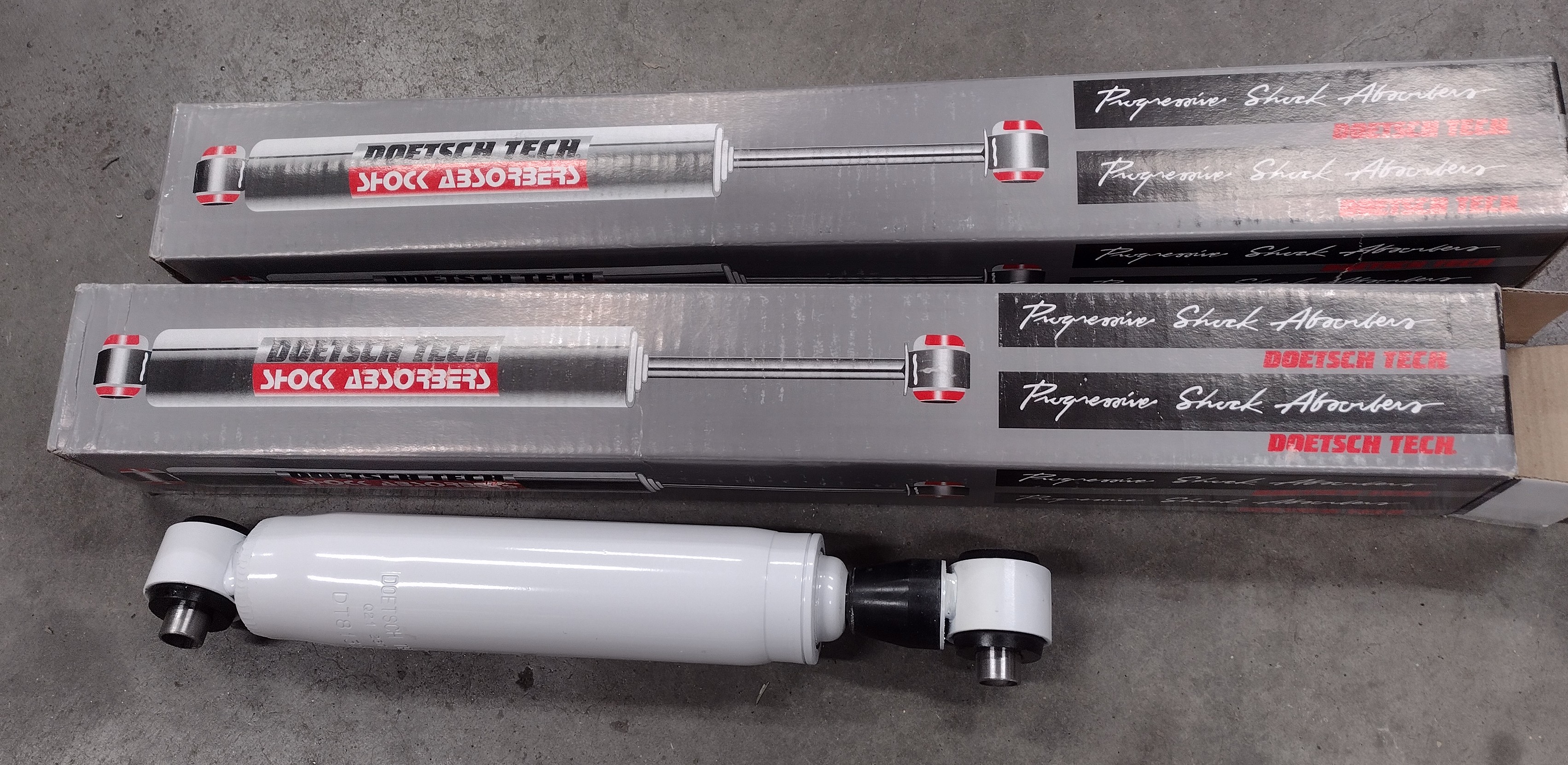

I still need to disassemble the rear suspension to see what I need to order as far as $pring cup$ go, but other items are beginning to roll in...like these new Doetsch Tech shocks! I can only imagine how much better the ride will be.

One new issue with the Doetsch shocks to be aware off is
They changed the bushing wall to thinner stock. So don’t
toque these to spec. Torque to a max of 100 ft-lbs or less
Otherwise these bushings can mushroom at the axle bracket.
Why they reduced the wall thickness beats me. But I suspect
to eliminate something unique.
Re: 710m rear springs
Posted: Fri Mar 11, 2022 10:29 am
by pcolette
rmel is correct about those bushings. I chose to press out the old bushings from the original shocks, gave them a good cleaning and then re-used them rather than use the thinner walled ones provided. That may not have been the correct path to take, but it did work for me. They are very good shocks in my opinion and really improved the ride. Have fun!
Posted: Fri Mar 11, 2022 10:35 pm
by MTPinz
Good call on swapping out the new with the old :) Those sleeves look severely inadequate for a hd rig like this.
Do you'll run with the external bumpstop on these shocks? Not sure if these shocks were designed for a different application, then fitted to a Pinz with custom sleeves, but the external bumps seem redundant if the Pinz ones are still there as mine are.

MTPinz wrote: Fri Mar 11, 2022 10:35 pm Not sure if these shocks were designed for a different application, then fitted to a Pinz with custom sleeves...
It's my understanding that these were developed in partnership with Scott at EI and are engineered specifically for the Pinz.
Posted: Sun Mar 13, 2022 5:41 pm
by rmel
That was correct -- until Doetsch started to tweak the design in a bad way.
Going cheap on the bushing wall thickness, and they also messed up the ID of the
bushing so you could not get a M16 bolt though, probably thought "heck 5/8" is
close enough" -- NOT.
