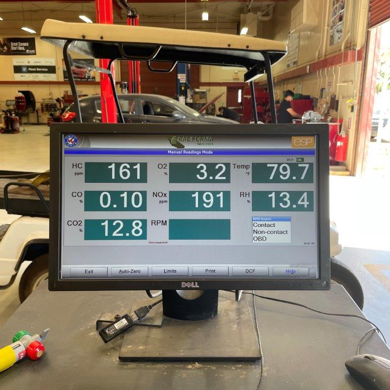

I checked the exhaust on my 710M and got these numbers. It is important that the engine is at operating temperature.
This engine has PinzSSI, so there are 3 sparks at the power stroke and the exhaust stroke. If the mixture is really rich there can be an exhaust backfire,
which is a carburetion problem, NOT an ignition problem.
