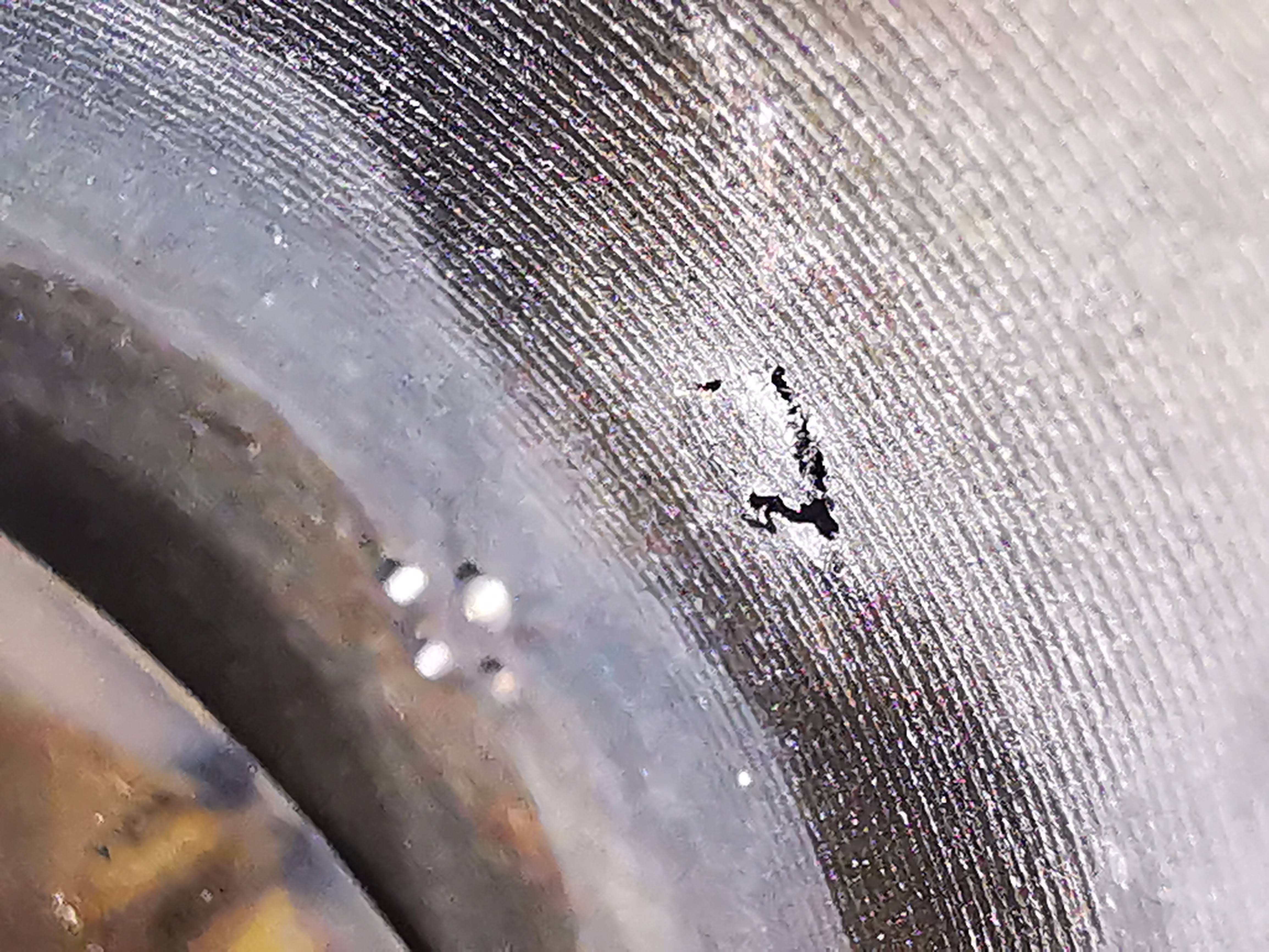

Thanks for the advice, i will still inform S-Tec, so they are aware.
I guess there is no point in bringing them to a machine shop to get the surface milled ? Enough thickness for this work to be done ?
One of the head (the one with the biggest dent actually) has a rather smooth and shinny mating surface to the cylinder. The other 3 are more rough, wondering if that rough surface is fine to seal the combustion gas properly.
Would hand lapping help for the surface finish ?
I will do hand lapping of the head to cylinder,
do i need to hand lap the cylinder to the crankcase ? or only use the Hylomar sealant you mentioned earlier ?

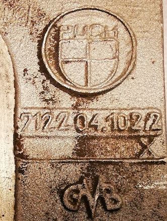

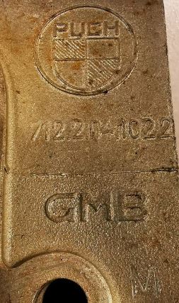

There was more than one source for casting heads. There should be a casting mark on each head.
See if they are identical. In any case, no matter how good the mating surfaces look, hand lap them.

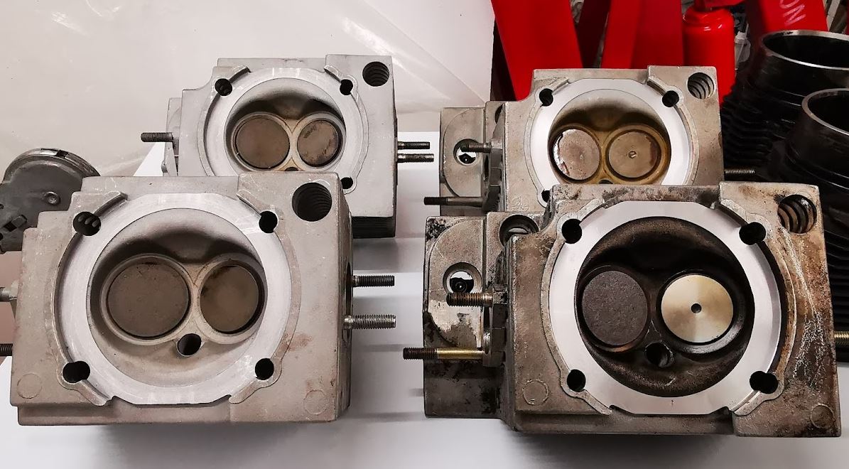

This morning i was going to pick up some new windows for our bedroom and realised i was passing by the machine shop,
the guy is specialized in classic Porsche and VW, so it thought i would bring him my heads and cylinders for advice.
He was not too worried about the dents, there is enough material on each side to seal properly. He will bring the dent down just to be sure it does not protrude too much, although its aluminum and the pressure will flatten it anyway. I left him the 4 cylinders, heads and pistons for him to check valves are seated properly, surfaces are flat, rockers don't have too much play.

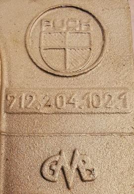

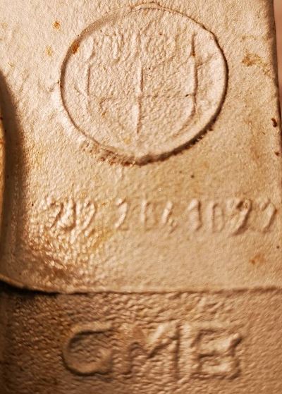

He clearly said that one head is not new (NOS) but reconditioned, but it appears to be in good shape, see pic below, bottom right.
I show the markings as well on each heads. Cylinders and pistons are NOS
So it'll probably cost me a couple of hundred boy for peace of mind.
4 heads.JPG (144.88 KiB) Viewed 10114 times

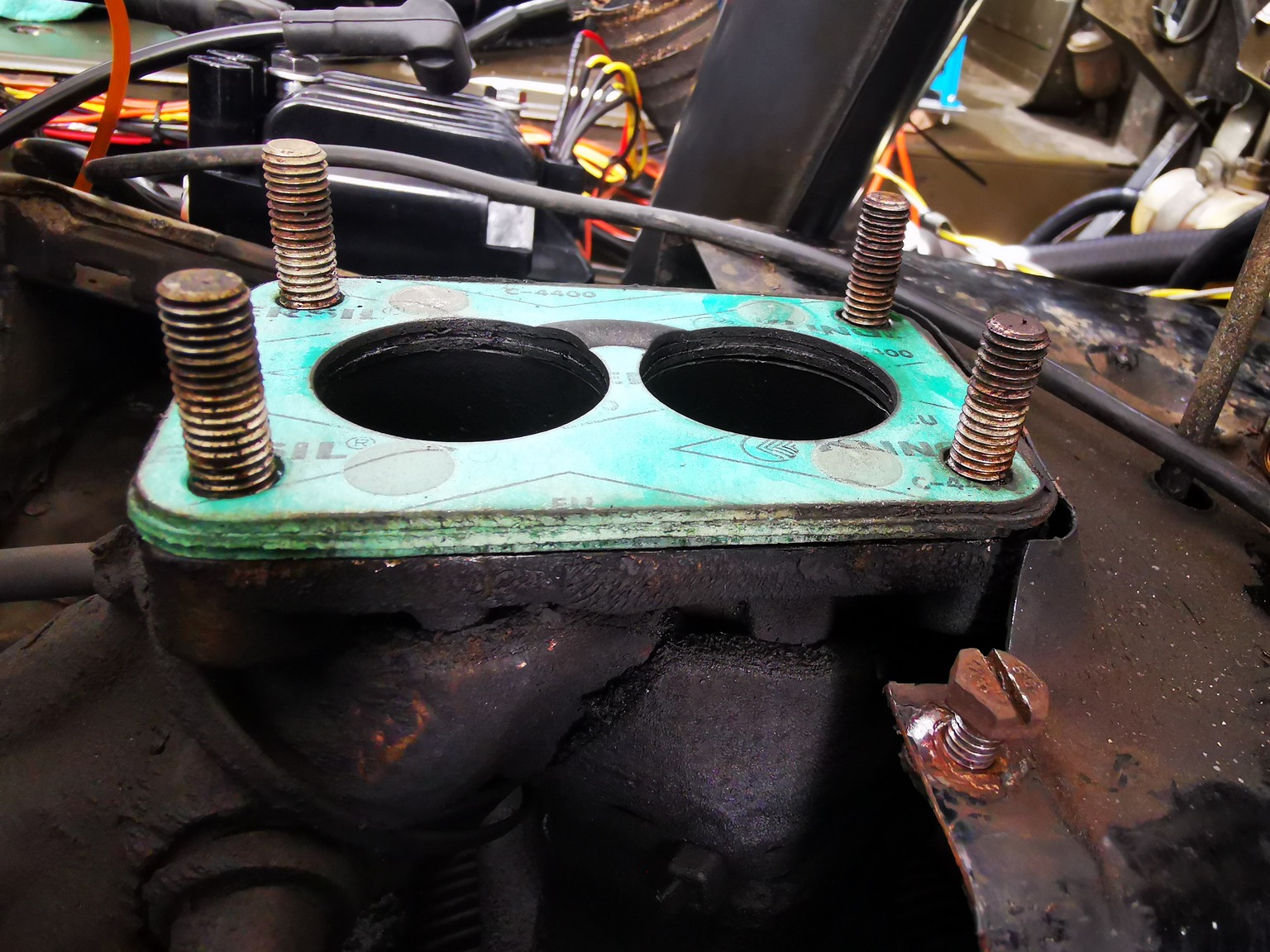

Normal to have 3 gaskets between the carb and the air intake manifold ? I have only one replacement per carb.
Hugues
From Switzerland
Posts: 1557
Re: Changing piston, cylinders and cylinder heads
The extra thickness helps insulate the Carb's from the heat of the intake manifolds.
So you DO want thickness. One layer is not sufficient, you should attempt to duplicate
the thickness.

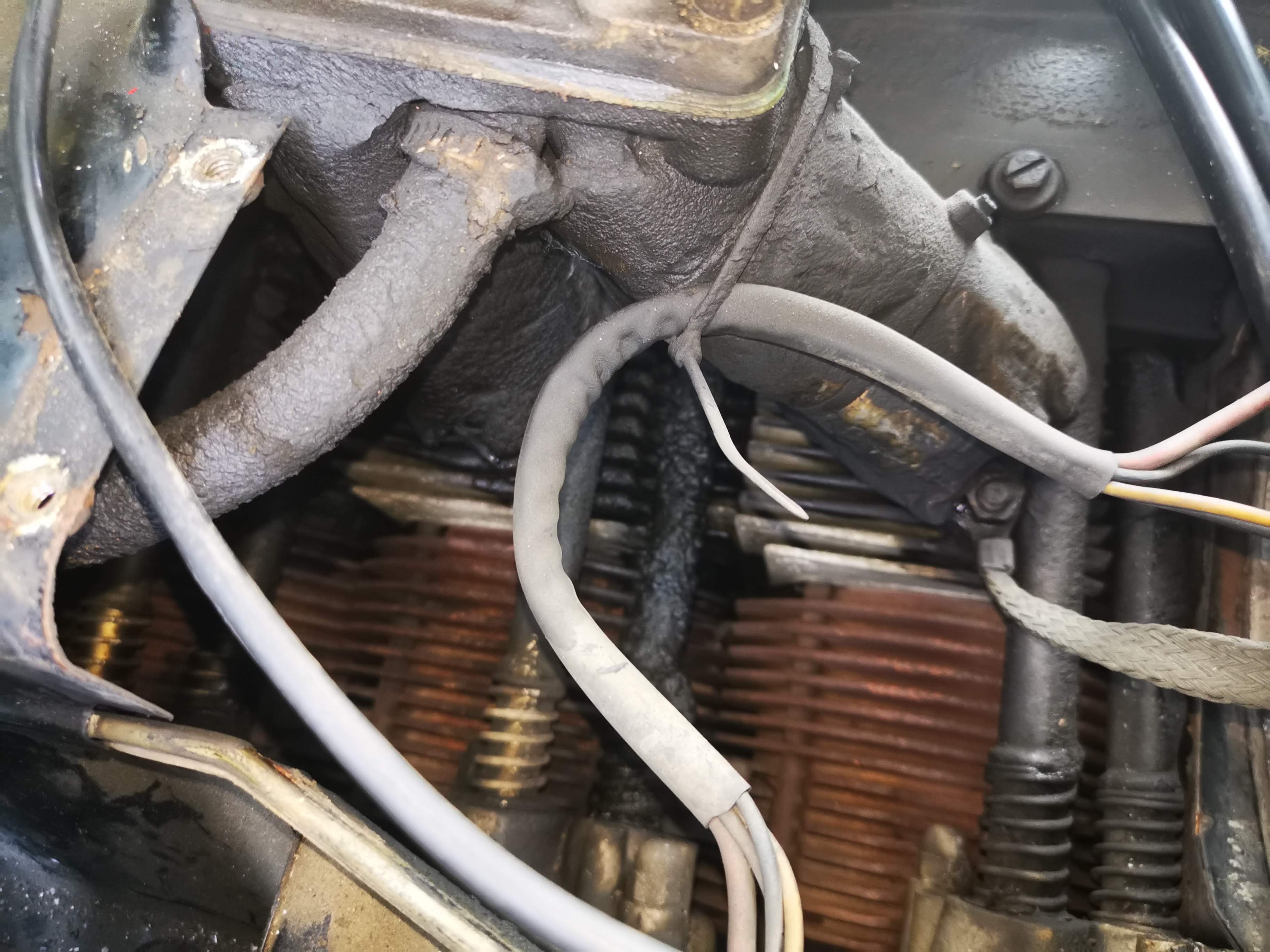

I attach a picture of my intakes, lots of gunk, but i can feel the insulation under. Can i just clean it and re-use it ?
Hugues
From Switzerland
Posts: 1557
Yup, they are insulated -- good.
Hard to remove to clean, put on with an adhesive. So just air blow them clean.

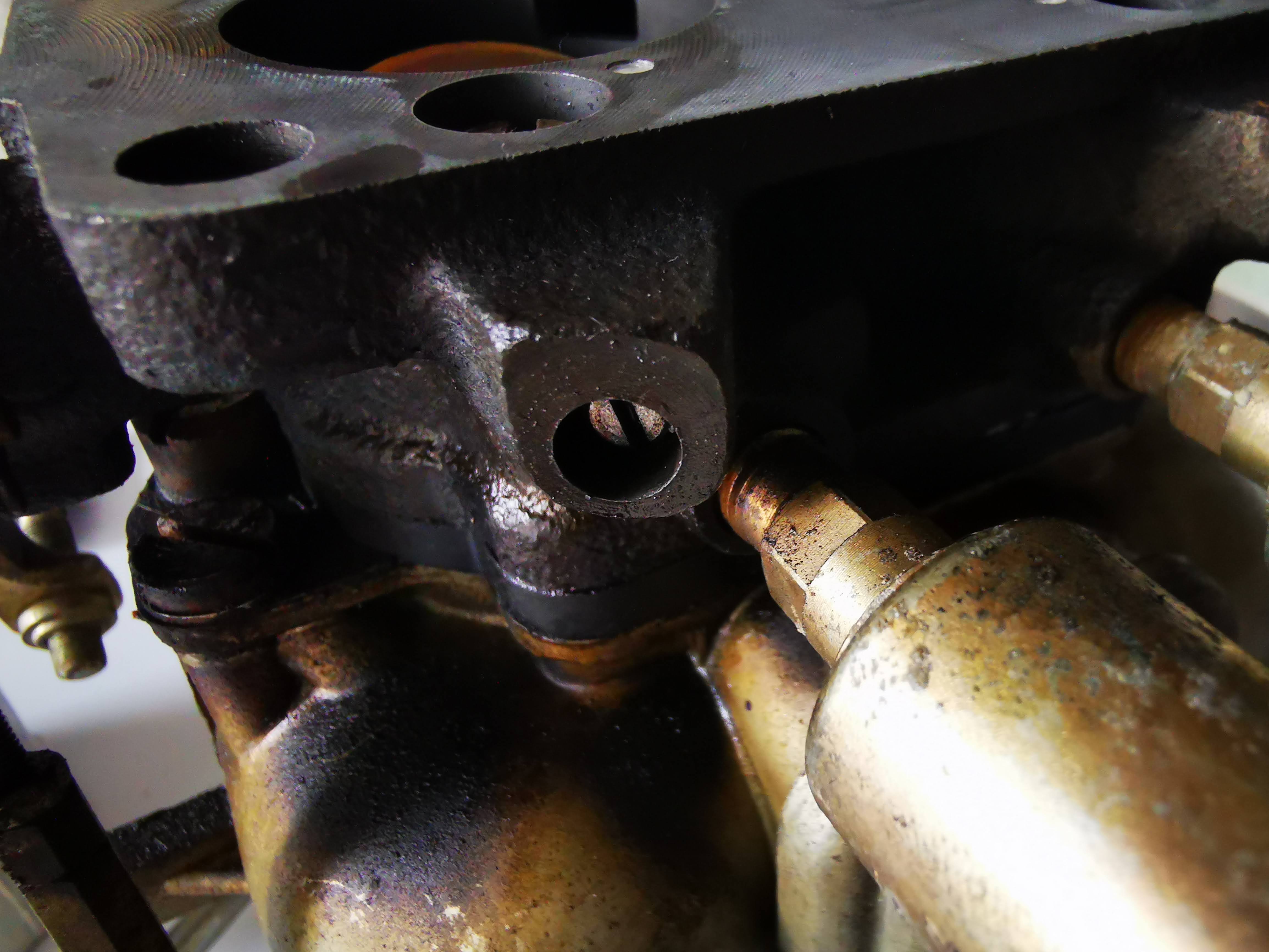

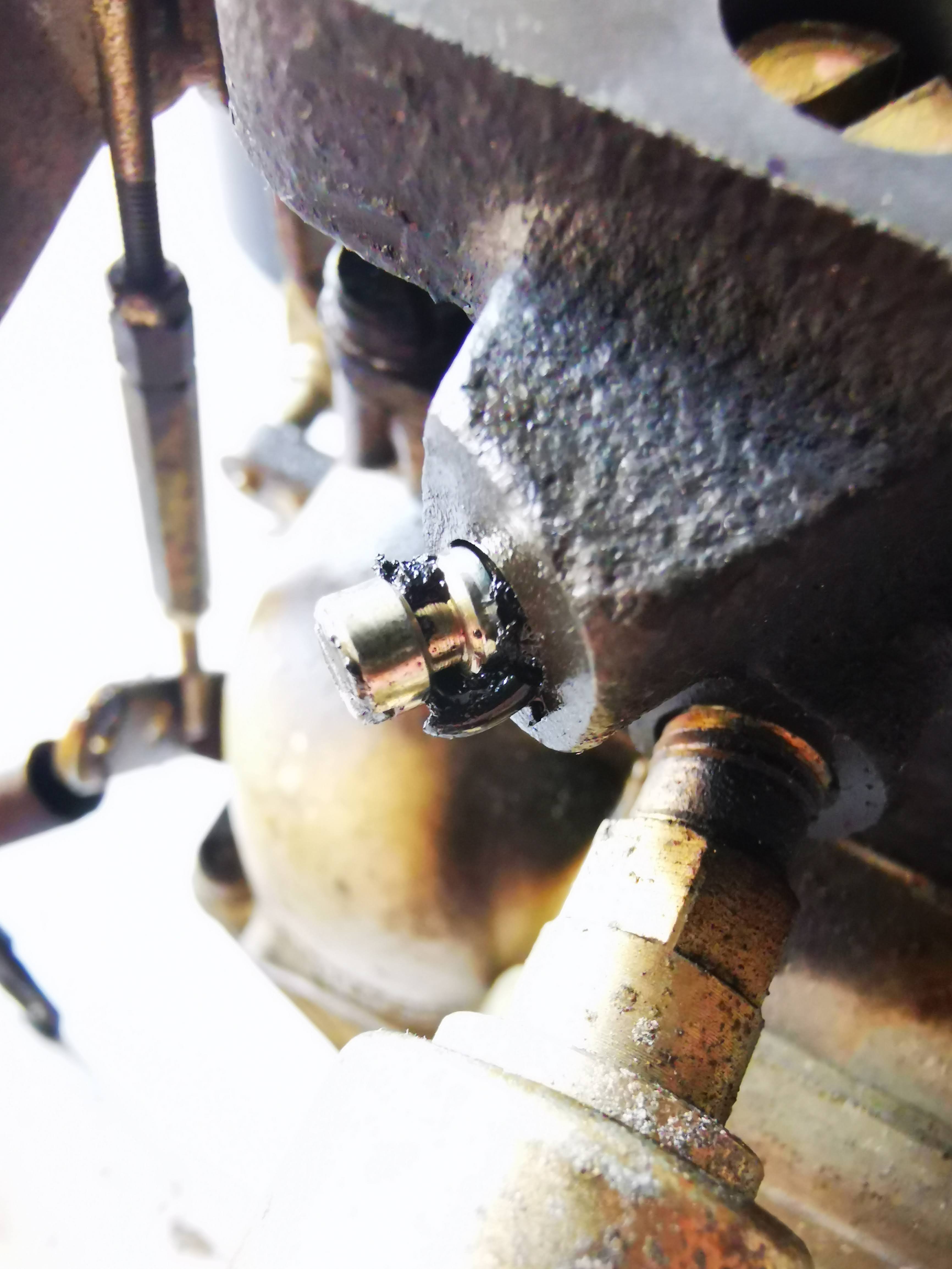

What's the trick to remove the idle mixture screw ?
I could get one out blowing with air,
but the other one doesn't want to come out,
i pushed it with a small copper wire, sprayed wd40 in, air pressure,...i think the gasket is holding it in.
And second picture, inside the carb, where the idle mixture screw comes out, the metal is a little broken, on both side,
should i try to remove this or better to leave it there ?

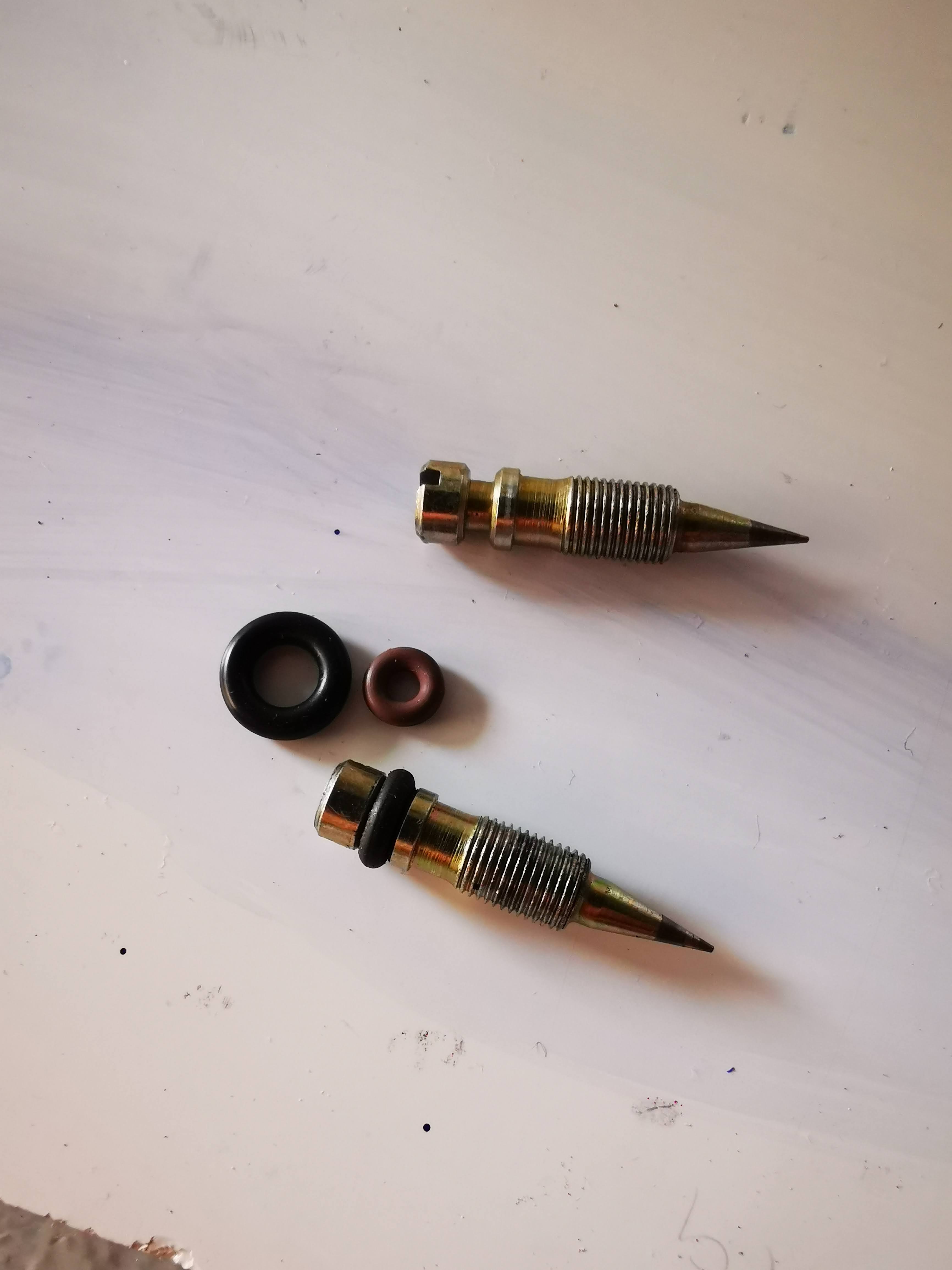

I managed to get the second idle mixture screw out, pushing gently with a needle while turning it with a screwdriver.
Now i know why it was stuck, the o'ring is all crumbling.

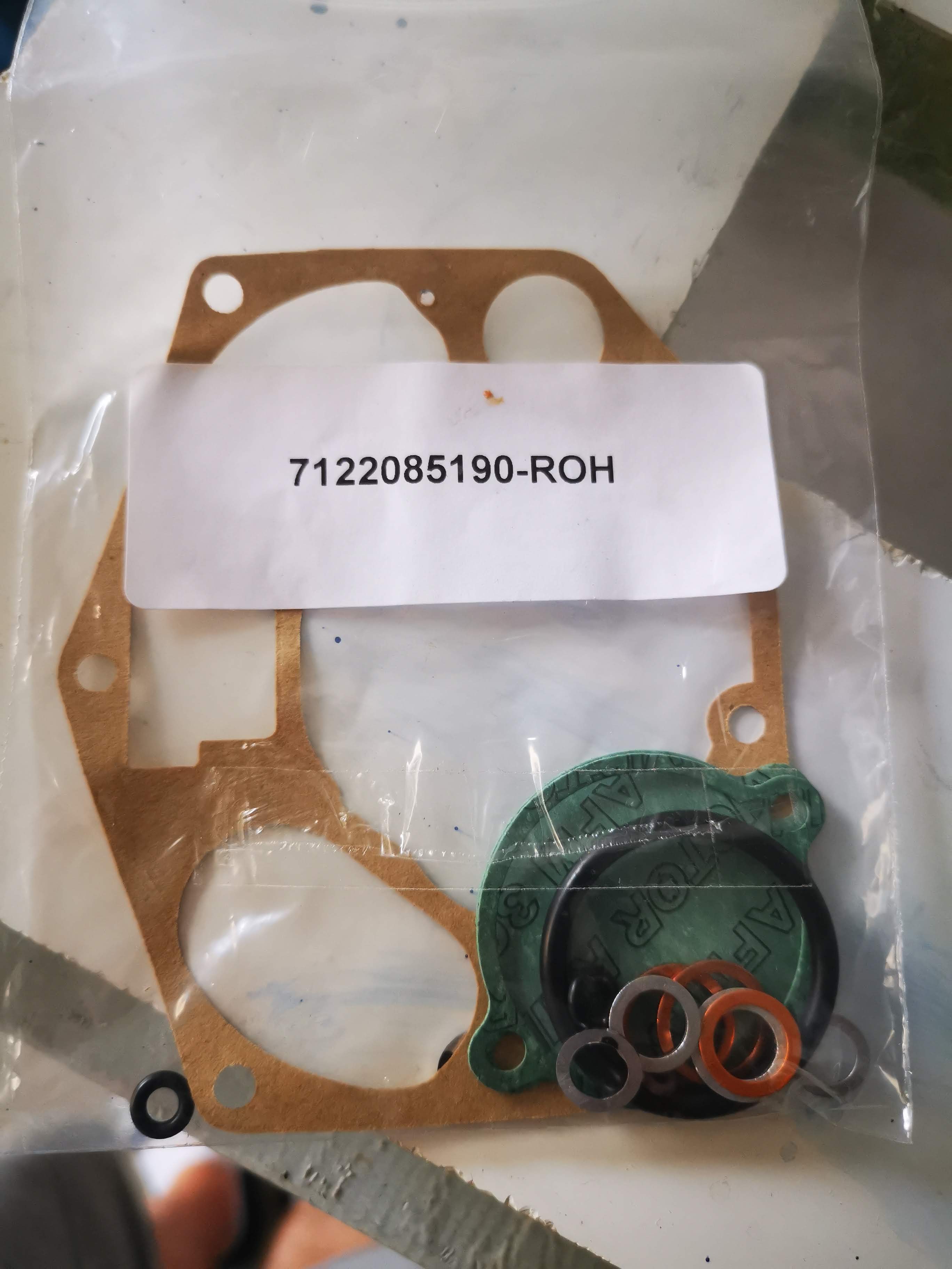

I bought the carburettor gasket set,
https://www.puch.at/en/products-&-spare ... of-gasket/
i would have think these o'rings are included, but the black one on the picture below is too big, and the red one too small
Hugues
From Switzerland
Posts: 1557
There are two different Carb kits, and one difference is the Idle screw types.
You may not have the correct kit for your carb's.
That said you may find what you need in a Metric assorted O-ring kit. Nitrile
or Silicon material should work. Typically O-rings are sized by measuring the
Cross-section and Inside diameter. Measure a good old one and pick the
appropriate size from the kit.
