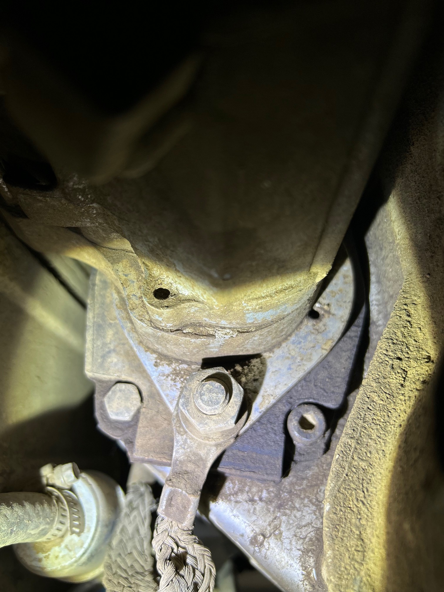

Here's what mine looks like. Almost looks like your motor and
intermediate housing is "clocked" out of position by 60 degrees?

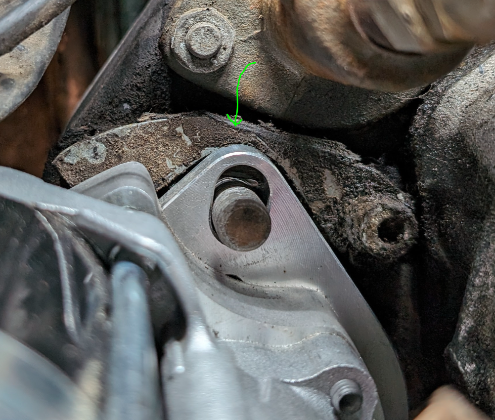

First, it turns out the starter was mis-assembled from Scott's factory, and required partial disassembly and re-clocking. Required an impact wrench to loosen the two bolts that secure the mounting flange.
Two issues remain, one small one bigger.
Small issue: The starter motor compresses the sound-deadening material. My fear is it'll rub through. Did others who use this starter also find that the motor is tight against the sidewall insulation?
Bigger issue: The upper ear of the mounting flange won't clear the keeper bracket that goes on top, across the top, of the rubber mount. Scott says that happens, and if it does one needs to loosen the keeper and move it. Well, I've loosened the inner upper bolt (socket head), and the bracket is still tight.
Any ideas on what else holds it in place? I've given it a few solid taps, and it's not moving.

The spacing between my gear reduction starter to the chassis sidewall is close but there's a wee bit of clearance.
WRT to the mounting, there are 4 bolts that hold the Starter Rubber mount and 2 that retain the "Nut plate".
My suggestion is to remove all these components, clean, and inspect for some possible debris. With all four bolts
removed that mount should come off easily unless it has taken a bond to the surface and just needs chisel whack
to release it.
Frankly, that interference looks in the neighborhood of about 2mm or so which seems a bit much for clearance
movement to accommodate. But a disassembly and clean is probably worth a try.

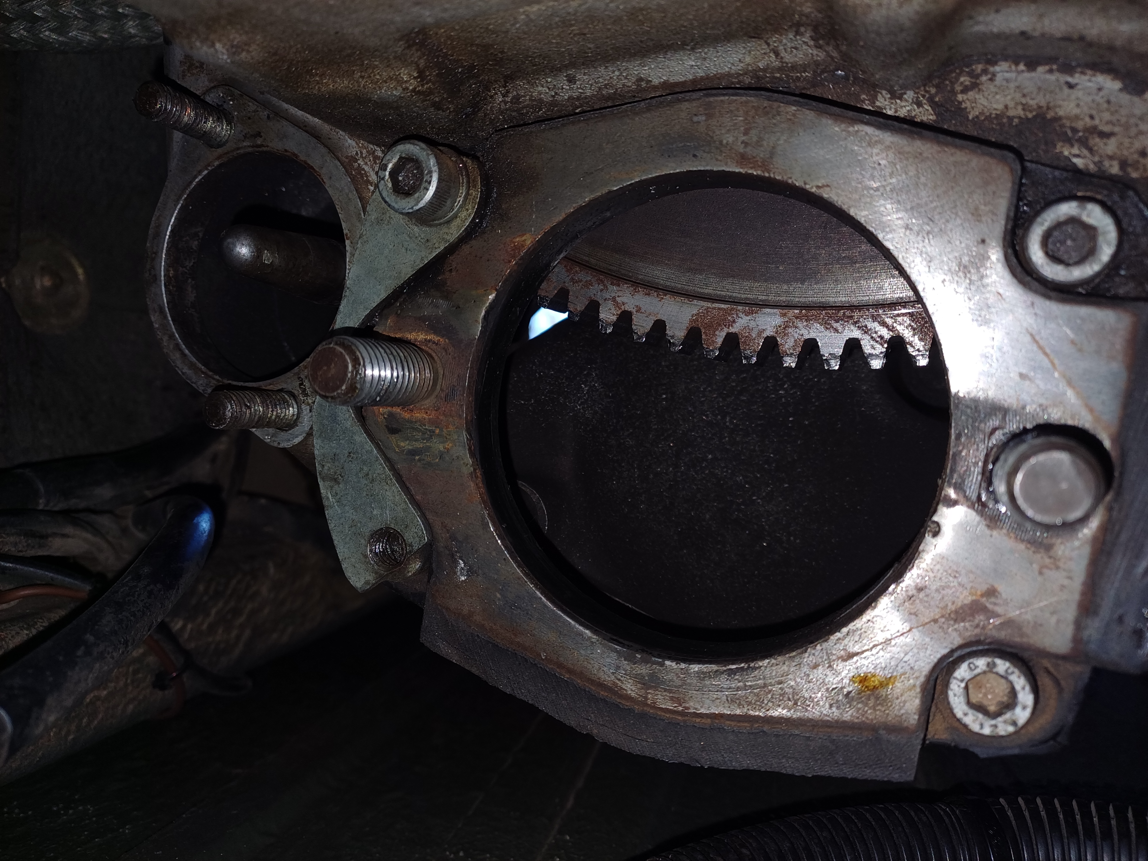

Please troubleshoot with me why a new reduction gear starter will fail to engage the ring gear when the engine is hot?
Re: Starter sometimes fails to engage
Posted: Sun May 25, 2025 12:48 pm
by Stumbler
This string covers a lot of the issues. One major one is that your mount might be cracked. The new starters put out a lot more torque than the OEM, and if your mount is cracked you cannot see it unless it is under torque. The rubber holds the pieces from bending so far as to break. So, you possibly have worn bolts, cracked mount, damaged ring gear, or damaged teeth on the starter. Go ... :)
Posted: Mon Aug 18, 2025 2:24 pm
by wjdel
Took a pic of my ring gear. All see
current ring gear
current ring gear
ms fine to me - anything unusual you guys can see?

Found the problem! Previous owner installed straight- cut ring gear which every no and then fails to engage depending on heat. Ive replaced with OEM directional gear (made in Germany)
    all good now.
