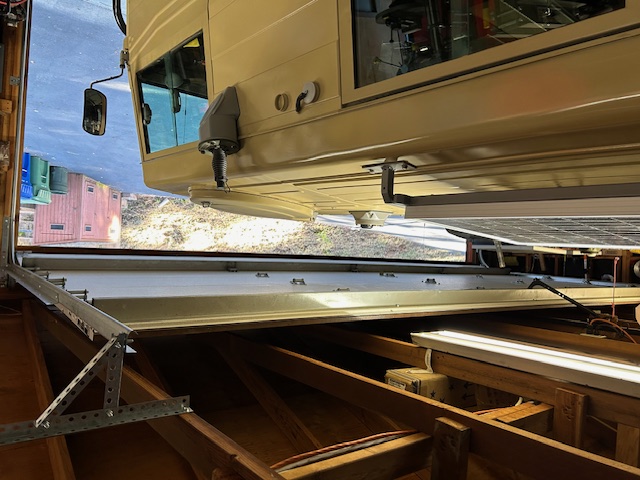

Re: 710M vs Garage Height
Posted: Fri Jun 07, 2024 7:59 pm
by ChickenPinz
To avoid the whole door issue, I opted for a sheet-style roll-up door. Similar to what you see in commercial settings. Gets the door 100% out of the way, above the header, and not overhead the inside area when it's open. But this only is an option if you have sufficient clearance for the roll. I tucked mine within 1/2in of the roof sheeting on either end. Pretty easy self-install for a 9ft x 9ft door.
