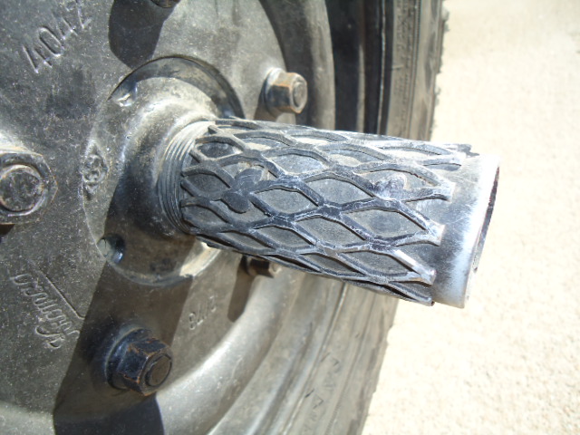

I was thinking about making some hub steps - any advice on metal thickness to use so that there is enough clearance between the hub and the wheel?

I made mine from a 1 1/2 inch floor flange with 1 piece of pipe. Then welded on a piece of expanded mesh for grip.
I used a 12 inch pipe nipple and cut it into two even pieces so there was threads on each end to screw into the flange. I drilled a hole (fits a Phillips screwdriver shaft) at the end to spin it off in the event I was going through very rocky areas. Total cost $12.
The floor flange can be sourced at your local hardware store (HD or Lowes for me) and it is the perfect thickness for a fit between the wheel and the drum.

You can get some play-doh and put it on the hub. Put the wheel back on and tighten the lug nuts.oilcan wrote:I was thinking about making some hub steps - any advice on metal thickness to use so that there is enough clearance between the hub and the wheel?
thank you all!
Then remove again and measure the thickness of the play-doh.
Re: Sources for Hub Steps
...or you could use calipers or a micrometer for inside dimensions. I did not have play-doh at the time I made mine. Interesting idea though.
