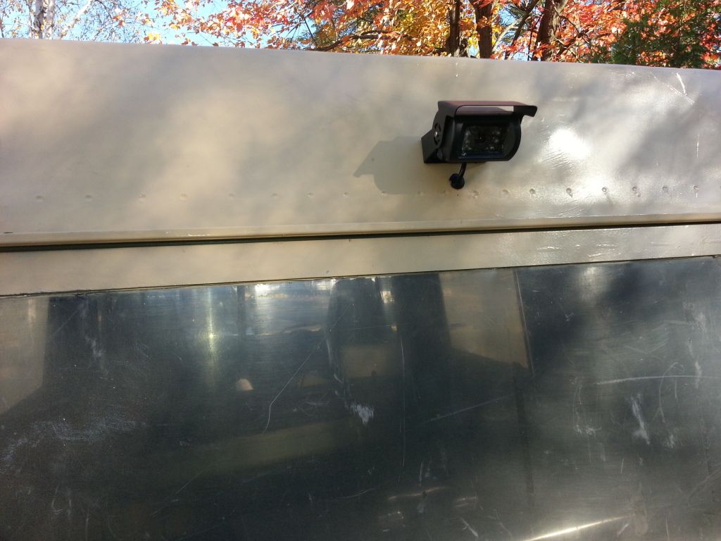

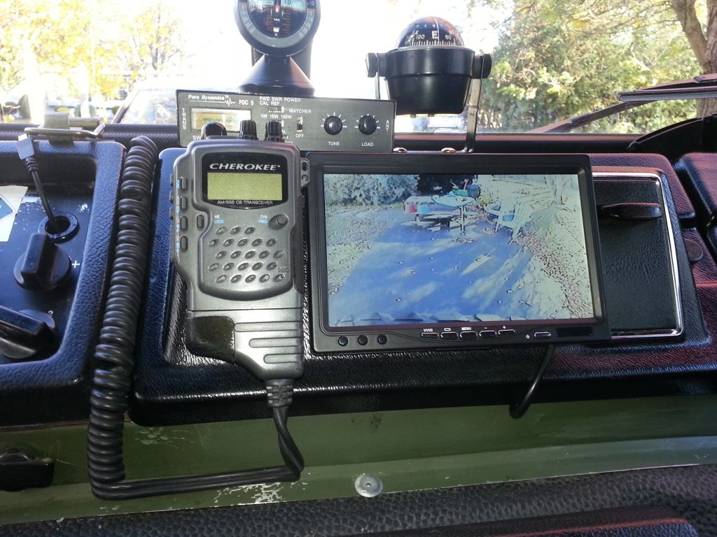

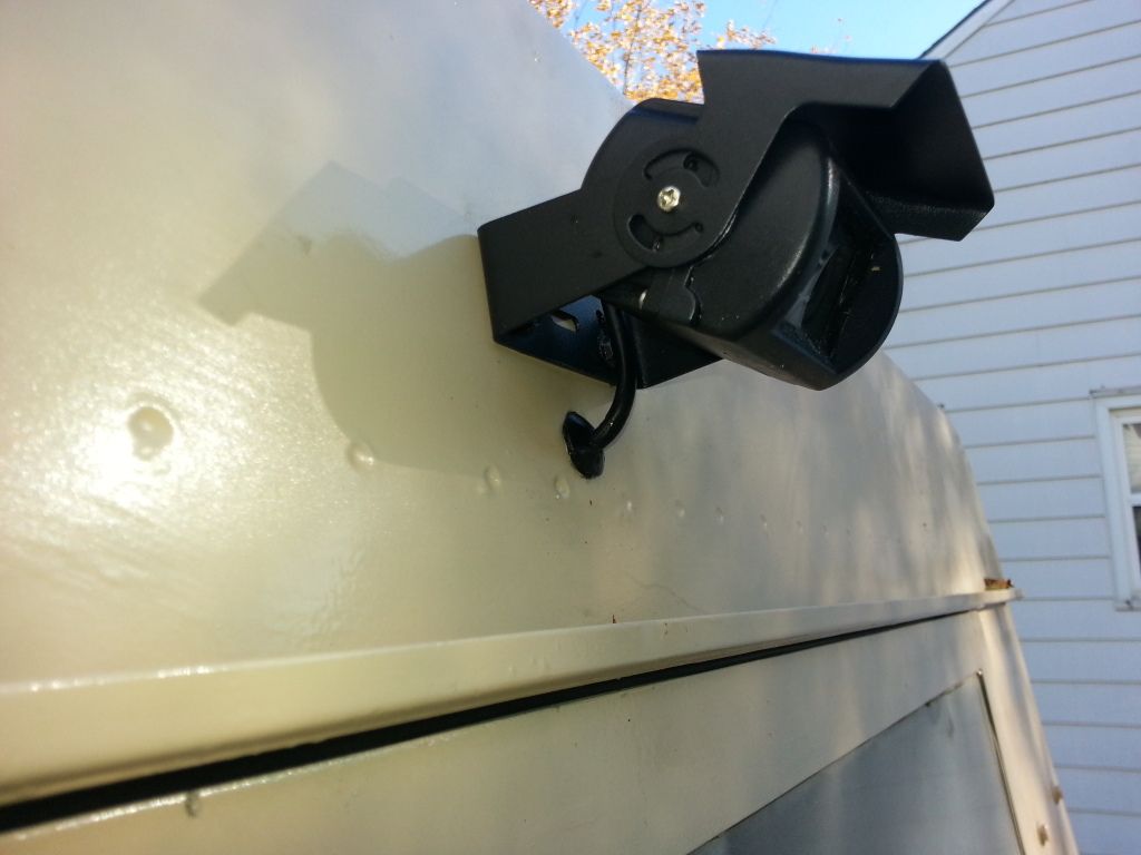

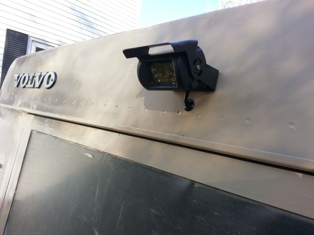

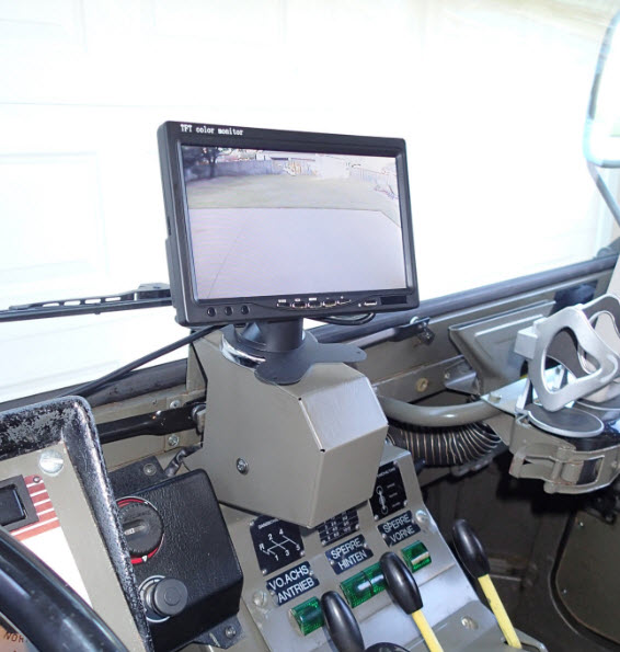

Ok, we'll I got the system, and I gotta say, I'm pretty impressed. I cobbled it together real quick to check the image quality and it's a good, clear color image. The menu function allows adjustment of brightness, contrast, color, image flip, and aspect ratio, as well as language. There's an extra plug for a second camera, and a quick button press on the monitor let's you choose between cameras. The width of the image is about what you can see out of both side mirrors if they're adjusted along the edge of your truck. Obviously if you have a spare tire like me, you won't see your trailer hitch, but this will get you to within about a foot of a car behind you.
I mounted the camera up high to see more, but it could be mounted anywhere.
Routing the cables was no big deal, just a bunch of wire ties. I chose to run the power for the camera all the way forward and connect at the fuse box. I wanted the system to work all the time I was driving instead if just when I'm backing up. If that's what you want, tap right into your reverse light.
I mounted the monitor to the dash with 3M heavy duty Velcro, the heavy plastic kind, not the cloth stuff. The dash panel was pretty loose before, now it's snug. (Yes, I rounded the underside of the plastic of the dash at the edge where it squeezes the wire).

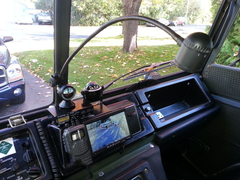

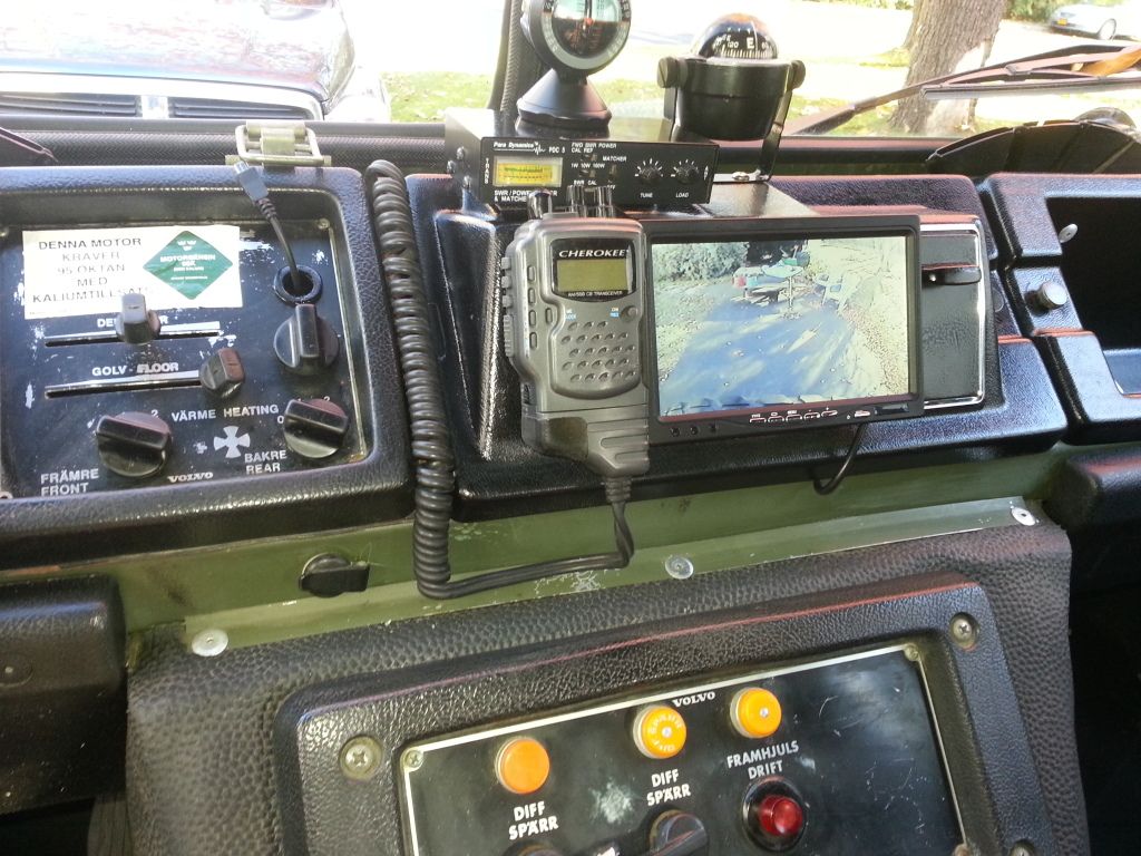

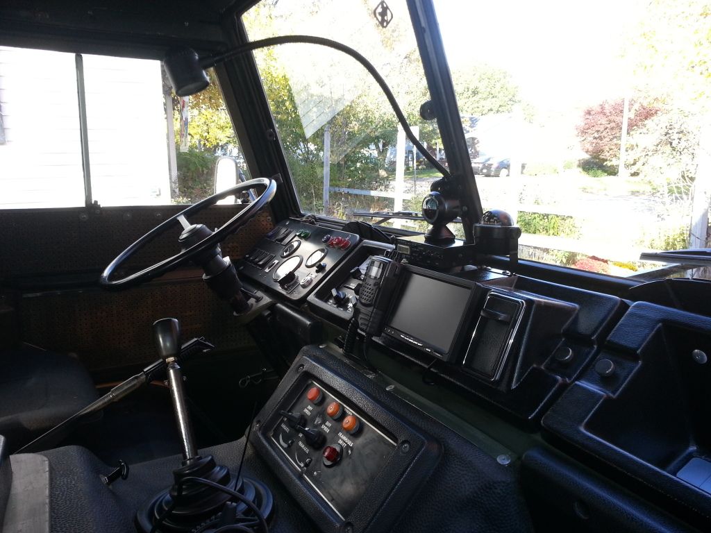

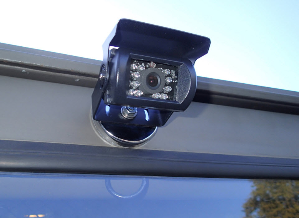

I too had been looking for a solution. I followed Donny's lead and ordered one of the same from the same place - $99 is hard to argue with.
For now, I've decided to power it all the time rather than connect it to the reverse lights. It can be turned off at the screen. I may change my mind later.
As far as mounting goes, I don't like to drill holes if I can avoid it for do-dads that can't be reversed so as to leave the truck absolutely stock (one of the reasons I've not put a red-dot ac in, sigh), so I modified a two of the HF plastic coated round magnetic mounts for my 'proof of concept' install. It works so well I may never change it and just paint the mounts OD. The magnetic mounts are such that if the camera or screen gets knocked off, they just stick right back on. There's enough unyielding pokey sharp things in a Pinz already. And if you're battening stuff down for the trail, crummy locations, or storage, you can just pop both off and lock them inside. When I get around to routing the wires permanently I will probably mount the screen up high on the roof between the sun visors more out of the way.
A couple of points of interest:
- The kit includes a screen mount that you can put on with double sided foam tape provided - I just stuck mine to the big magnetic mount.
- The vendor will sell a 2nd matching camera for another $35.
- The vendor shipped the same day and it took 17 days to arrive from you-know-where.
- On mine at night all the little LEDs glow red. I don't know if they are all like that. Looks cool, but so much for stealth.
- The screen has a blue wire in addition to red and black presumably for reverse + trigger.
- Although the camera has a red + and black - wire, no ground connection appears to be required.
It is worth $99 not to back over my wife's dumb dog.

The power cable I got that plugs into the camera's fixed cable is maybe 3' long at best.Jimm391730 wrote:I ordered the kit with two cameras, it just arrived today. Mine took only 15 days to get here from Hong Kong. While it did come with two long cables for the camera video signal, it did not come with long power cables for the cameras - I guess I'll just have to supply my own.
I like the magnet idea. Today and Saturday look like lousy weather, maybe I'll get a chance to start installing it on Sunday.
The round magnets I used are these http://www.harborfreight.com/set-of-2-m ... 65528.html two for 3 bucks. I drilled out the center rivet and its big enough for a bolt hole. HF has all sorts of larger and smaller versions of this so you might find one you like better, but I can't imagine needing anything stronger.
One advantage of the magnetic mount (as if there is anything not steel on the pinz?) is you can move the stuff around until you find a place that suits. If you're cables are long enough you could move them depending on the mission.
The red glowing ir leds are a bit strange but they are not obnoxious unless you are trying to take a picture of them. They don't light up the view all that much but they do work.
