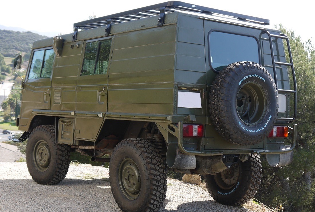

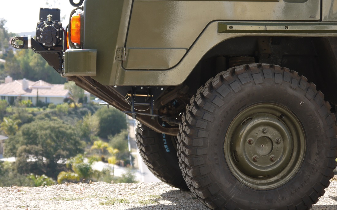

Oh yeah, approach angle is yet another thing I'm obsessive about. ;) I think the pic explains the thinking behind the design. The cable's thimble could be stored differently so don't let that affect the impression of the angle too much.
Yes the previous owner had the roof "repaired" and the shop sprayed the roof to, I assume, enhance water resistance and repel future rust. The roof was about the only real weak point on this 710K as it had some mild rust issues in the past.

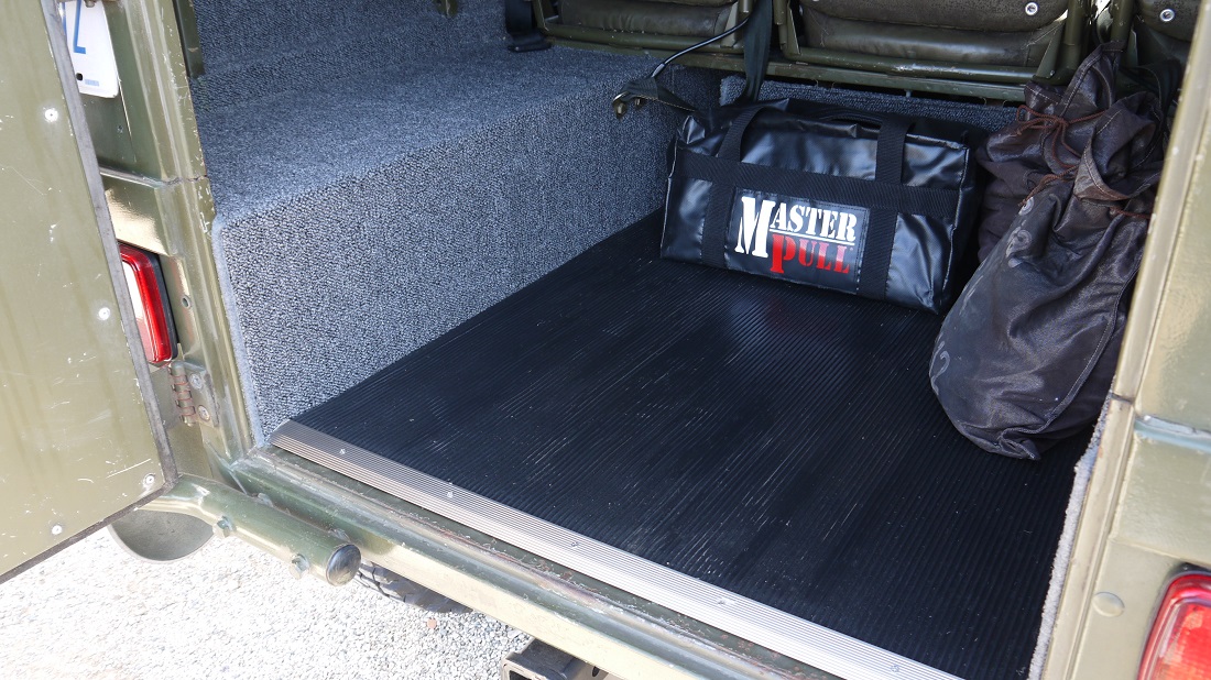

And there's the cargo area. I added a little trim piece to the edge of the mat. The mat is easily removable so you can dry out the area under it, just as the mid-section mat is. The shop kept wanting to glue it down but that is one of the worst things you can do on a 4x4 as it will promote rust eventually. The material is really dense so it lays just fine without the need for additional securing.

That winch/mount looks so seriously cool that I just added it to my wish list. And the roof rack looks awesome. Don't really need a rack even though I haven't found an adequate trailer yet, but would love a sturdy viewing platform with a ladder just like that one. Mine will have a wooden deck for the cooling effect of the double roof, and will probably need to be detached occasionally for cleaning the roof.

That is a VERY nicely designed and thought out winch mount.

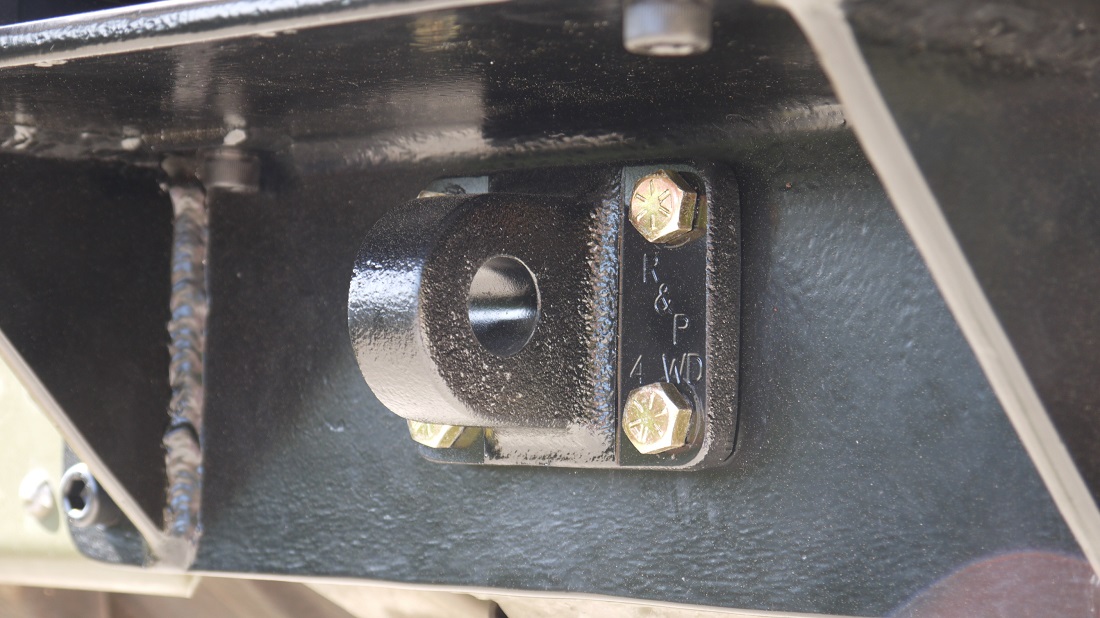

Thanks for the good words Vince. I do build them as requested. They range from $385 to $650 depending on the details of the hoisting rings, D rings, or shackle mount variations. Vince, do you have a listing for that anchor point you mounted below the winch. I like that one.
I also featured This truck on the front of my Facebook page. http://www.facebook.com/pages/Fat-Fabri ... 104?ref=ts

Andre wrote:Thanks for the good words Vince. I do build them as requested. They range from $385 to $650 depending on the details of the hoisting rings, D rings, or shackle mount variations. Vince, do you have a listing for that anchor point you mounted below the winch. I like that one.
Andre, what would the mount in the photo cost, roughly?
Re: 710K Export project
Andre, why not just add another gusset and have the hole made to accept a shackle. Seems it would be more cost effective then buying a specific piece and then the hardware to bolt it in. Of course I am sure you have heard this many times when building from bumpers "can you leave me access to the front pin?". Never understood the need to access the front pin if you had a good attachment point like the one in the photo or other as part of the bumper.
I purchased my bumper from EI and had a weld shop cut a hole and weld in plates to keep out trail crud.
Allows me to use the pin.
http://s400.beta.photobucket.com/user/m ... ort=3&o=71

If there is already a sturdy tie point, centered on the truck, reasonably practical to use with the removeable pin, I guess just having a hole in the bumper / winch mount that allows to use it is the simplest approach.
I am sure the shackle mount on Vince's truck is very practical and sturdy, and probably slightly easier to access than the pin, but I would personally prefer not to add stuff on my truck if Steyr Puch already took care of it...

That pin is great but when a winch is added in the way that this one was, I strongly believe the shackle mount you see here works better because of the easy access and purpose built design. You can very quickly put a 3/4 shackle on it and rig up a number of possibilities. The Anchor Shackle is the base ingredient of any 4x4 recovery operation and I prefer my rigs be able to accept them quickly, front or rear, but that's me.
