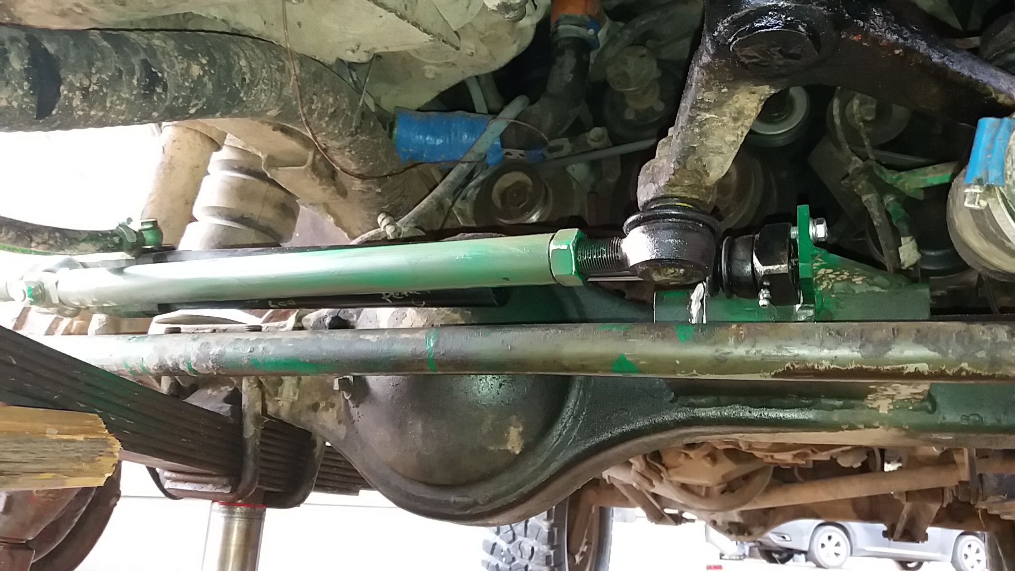

Sorry for posting photos of my Power Steering so late, but I just forgot to do it.
So here are photos of my Astra G power steering installed on my TGB1111. Sometimes it does not works as it should. I think it is due to electricity problems as it needs 12v and now I am taking it from one of the batteries - not good for 24v system. But it works fine the most of the time. I needed it for taking part in competitions where I need to steer fast, otherwise struggling with factory steering was fun and substituted workout in Gym :) .

hello,
we have installed hydro power steering to few Volvo TGB. Set include power steering cylinder with bracket, steering rods, pump with bracket, V- belts, oil tank (used) , hoses, (easy to install if handyman, but need little welding). several units in stock. price 1100 eur. if more info needed I can send.
Volvo TGB 4x4 powersteering.jpg (786.16 KiB) Viewed 8709 times
volvo TGB 6x6 roolivõim.jpg (857.97 KiB) Viewed 8709 times
Volvo TGB 6x6 & 4x4 diesel, power steering, overdrive gear.
