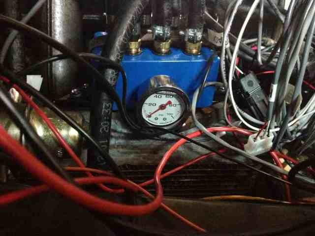

Picked up a fuel pressure gauge for the fuel box yesterday, also ordered a seperate 24 to 12 volt converter to use just for the fuel pump. The one I already have is for my sterio and 2 accessory plugs.
The new one will be activated by the ignition and dedicated. It is a 12 amp unit even though I only neen 6 amps.
Today I will be tackling the wiring and mounting of the computer box.

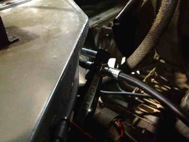

The throtlle cable was a real pain to install. the directions indicated it should not need a spring but provided one "just in case." Not only did I need a spring but one much heaver then the one he provided.
The pedal now seems just a hair bit stiffer then before but should work fine.
