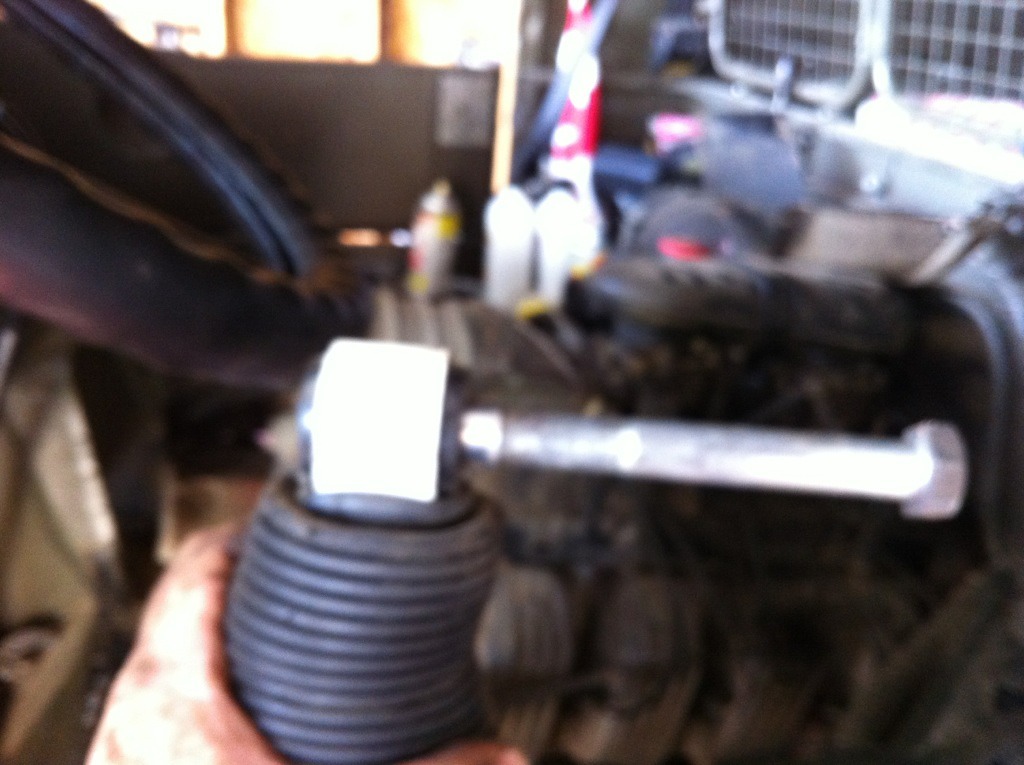

Well, hit a roadblock..... :( .....and I cannot continue.
New shock and bolt:
Old shock and same bolt:
The bottom bolt fits through the bottom spacer fine. Anyone have this issue? Just waiting for EI to call me back.

Forgot to mention....the top bolt fits through the bottom shock spacer without issue....

Re: Front Shock bolts
Oh yeah. As I recall I removed the metal (inserts) and replaced them with the ones from the OEM shocks. Bolts work fine then.
Must have done only one end as I only have 4 rusty ones in my junk pile. I save all the metal bits...never know when something can be used again.

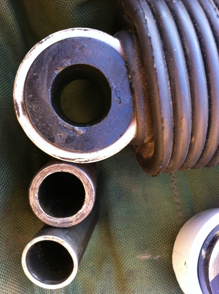

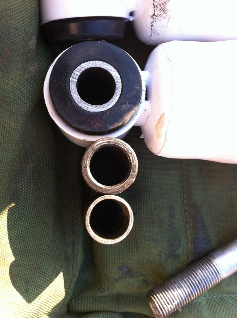

I was going to do that, but will I damage the rubber by pressing this in? They are not the same sizes and the bottom looks larger and more robust.
Below shows the bottom if the shock, the old spacer and the new.
Top of the shock.

I got it in!! :D
Good. This is a good place to use that grease.
Sorry - I forgot to mention that I had the same problem on the last set of shocks I installed. I also just pressed out the new sleeves and re-used the better quality old ones.

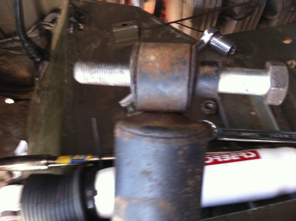

I finly got everything together tonight....spent to long in the patio....
I noticed the front wheels are much more rod-eyed then before....I am assuming this because of the shocks??
