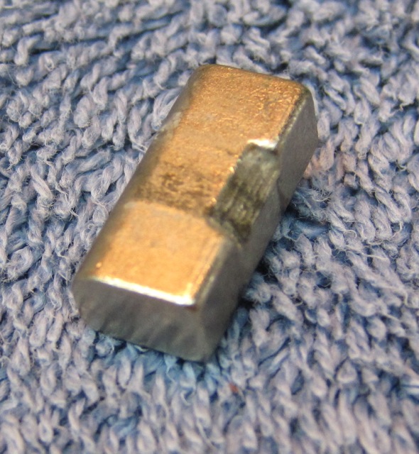

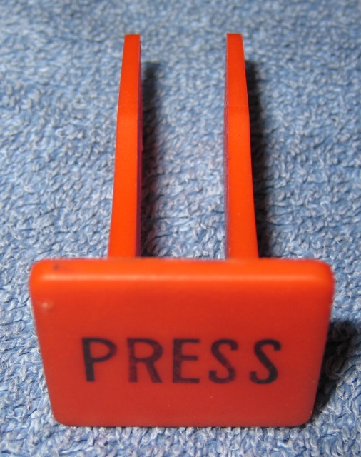

The original Pinz seat belts that I have seen are unique to the Pinz. There have been many other aftermarket seat belts used with success. I have a set of Beams seat belts on my '73 and they work great.
I have a female buckle that I keep as a spare and took it apart today out of curiosity. The orange "PRESS" button cannot be removed without drilling out the 2 rivets and carefully snapping off the 2 halves of the cover. In doing so the spring is released so be sure to notice it's placement before removing the bottom half (see photo). To remove the button, the metal pin that the male buckle connects to has to be removed. It too has to be replaced a specific way for the male buckle to latch correctly.

Additional photos:
To answer the obvious question, sorry but the buckle is not for sale. I would check with Scott at EI and Dennis Williams at Linden Engineering to see if they have some used female buckles available. Or maybe another forum member does?
Hope this helps.

Thanks Paul for the great photos and the time that you took. I guess my button disintegrated more tha I thought as my orange button appeared to me to just press into place and not attach the way your photos indicate. I'll check with the sponsor at the beginning of the week and see what they have.
